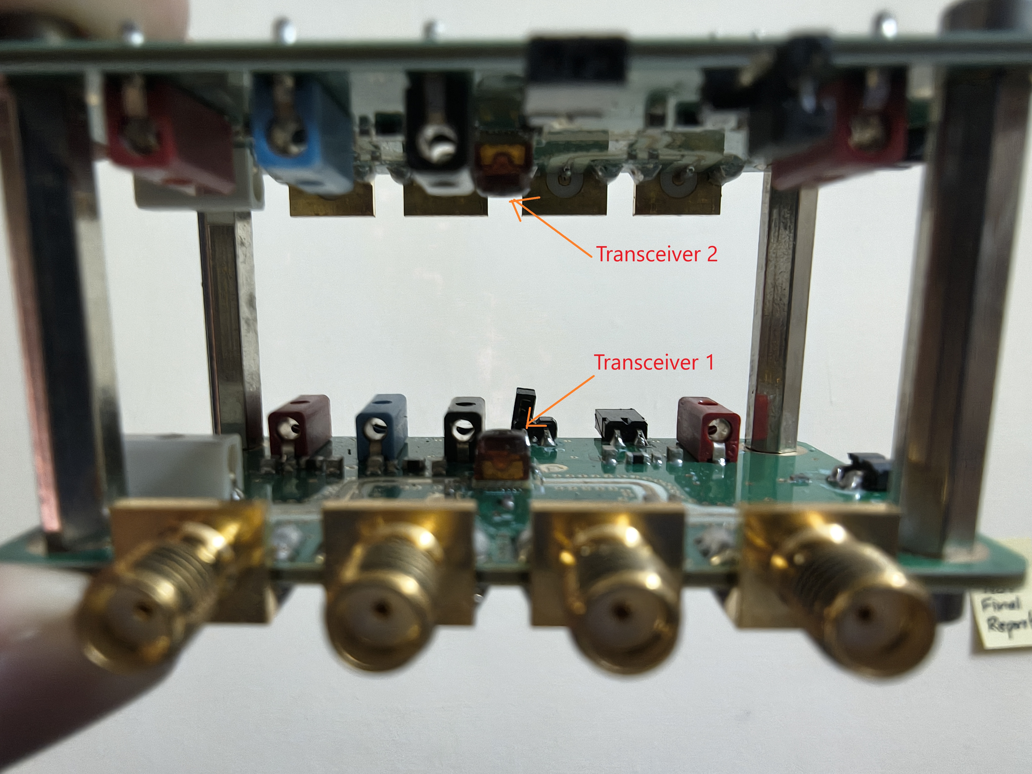

The Broadcom AFBR-FS50B00 is a compact, high-speed optical wireless transceiver designed to enable full-duplex communication through free space at data rates up to 5 Gb/s over distances ranging from 30 mm to 100 mm.
Unlike traditional fiber-based links, it transmits and receives data optically without physical connectors, making it ideal for board-to-board, rotary, and through-window communication where cabling or slip-rings are impractical. The device integrates an 850 nm VCSEL transmitter and a high-speed PIN photodiode receiver, both built into a small surface-mount package. It maintains full functionality across 360° rotation, offering excellent flexibility for compact system designs that require high-bandwidth, low-latency optical interconnects. To simplify evaluation, Broadcom provides the AFBR-FSEK50B00S evaluation kit, which includes two PCBs populated with AFBR-FS50B00 transceivers and SMA interfaces for signal input and output.
This setup allows designers to quickly validate optical link performance under real conditions, with verified error-free transmission demonstrated at 25 Mb/s, 1 Gb/s, and 5 Gb/s. The evaluation kit enables engineers to explore the transceiver’s capabilities in various applications, including industrial automation, automotive communication modules, and high-speed embedded systems. It provides an effective platform for studying optical alignment, signal integrity, and power optimization before integration into production hardware.

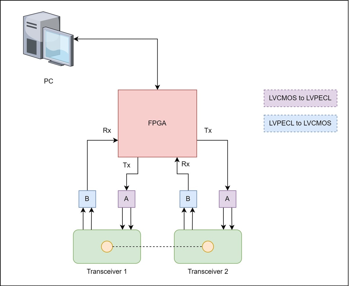

The primary objective of this experiment is to evaluate the performance and functionality of the custom-designed LVCMOS-to-LVPECL level conversion circuit intended for interfacing an FPGA with the Broadcom AFBR-FS50B00 optical transceiver. Specifically, the goal is to verify that the converter accurately translates the FPGA’s single-ended LVCMOS signals into differential, AC-coupled LVPECL signals with correct voltage swing, common-mode level, and transition integrity as required by the transceiver.
This phase focuses on observing and comparing the input and output waveforms using an oscilloscope and a logic analyzer to confirm proper signal translation, symmetry, and timing behavior. Successful validation of the converter’s operation ensures that the electrical interface to the AFBR transceiver will meet its input specifications and support stable high-speed optical communication in subsequent system-level testing.
System Overview
The experimental setup consists of an FPGA board, a custom-built LVCMOS-to-LVPECL level conversion circuit, and test instruments including an oscilloscope and a logic analyzer. The FPGA serves as the signal source, generating programmable LVCMOS outputs that emulate digital data streams intended for the Broadcom AFBR-FS50B00 optical transceiver. Since the transceiver’s input interface requires AC-coupled LVPECL differential signaling, the conversion circuit bridges the electrical compatibility gap between the two devices.
In this configuration, the FPGA outputs a defined logic pattern through its general-purpose I/O pins, which are routed to the input of the level-converter circuit. The converter translates the single-ended LVCMOS signals into differential LVPECL outputs, providing the appropriate voltage swing (~800 mVpp) and common-mode bias (~2 V) necessary for the AFBR-FS50B00. The differential outputs are AC-coupled to allow proper biasing and isolation between the converter and the transceiver input stage.
For validation, the LVCMOS inputs and LVPECL outputs are simultaneously monitored using an oscilloscope to capture the voltage waveforms and timing transitions, while the logic analyzer observes the digital characteristics of the LVCMOS signals. This setup allows direct comparison between input and output behavior, ensuring correct polarity, symmetry, and signal fidelity before integrating the converter with the optical transceiver module.

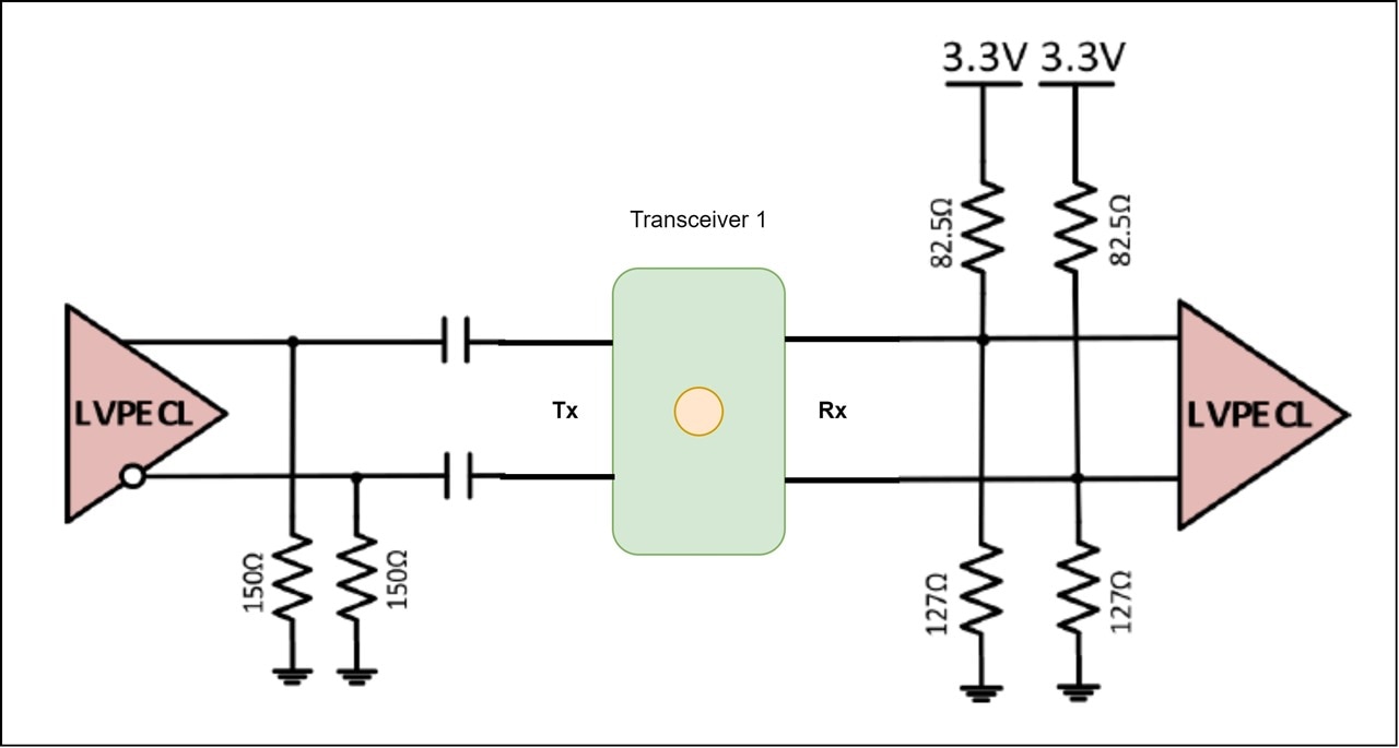

The interface circuit shown in figure implements an AC-coupled LVPECL link used to connect two Broadcom AFBR-FS50B00 optical transceivers (or, in this case, the FPGA-driven converter and a transceiver under test). The purpose of the design is to ensure proper biasing and signal integrity across the LVPECL differential lines while maintaining compatibility with the device’s required voltage levels and termination impedance.
Each LVPECL driver produces a differential output with a nominal common-mode voltage of about 2 V and a voltage swing of approximately 800 mV p-p. To block any DC bias mismatch between the driver and the receiver, the signals are AC-coupled using series capacitors placed on both the Tx and Rx differential pairs. The capacitors allow high-speed AC components to pass while isolating the DC bias networks on either side.
On the transmit side, 150 Ω pull-down resistors provide a defined DC reference to ground when the driver is AC-coupled, maintaining impedance matching and preventing floating nodes.
On the receive side, a resistor network consisting of 82.5 Ω pull-ups to 3.3 V and 127 Ω pull-downs to ground biases each differential line to the typical LVPECL common-mode voltage (~2 V). This passive bias network creates the proper DC level at the receiver input while maintaining an overall differential impedance close to 100 Ω, matching the transmission line and minimizing reflections.
The network therefore performs three key functions:
  1. Provides the required biasing for LVPECL inputs through a resistive divider between 3.3 V and ground.
  2. Ensures impedance matching along the entire high-speed path.
  3. Maintains AC isolation between circuits, protecting against DC offset and allowing independent power-domain operation.
This configuration is particularly effective when interfacing devices with AC-coupled LVPECL I/O, such as the Broadcom AFBR-FS50B00 transceiver, ensuring stable high-speed operation without direct DC coupling between components. The design also facilitates easier signal observation at the Tx and Rx nodes, allowing verification of signal swing, common-mode voltage, and eye quality using an oscilloscope.

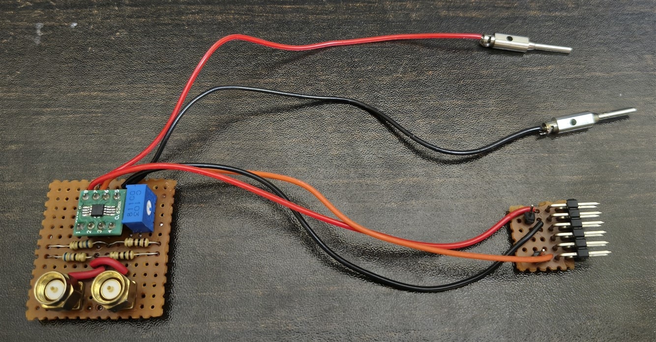

The prototype circuit was assembled on a perfboard to validate the operation of the LVCMOS-to-LVPECL level-conversion stage before integration with the Broadcom AFBR-FS50B00 transceiver. The design incorporates SMA connectors, banana jacks, and a PMOD-compatible header, allowing convenient interfacing with both laboratory instruments and the FPGA board.
The SMA connectors provide high-frequency signal access for the differential LVPECL outputs, enabling direct connection to an oscilloscope or a high-speed measurement setup with controlled impedance coaxial cables. The banana jacks supply regulated 3.3 V and ground connections to power the converter circuit, ensuring stable operation during signal testing. The PMOD interface is wired to the FPGA’s digital I/O pins, carrying the LVCMOS-level input signals into the converter stage. This arrangement allows the FPGA to act as the digital pattern generator while keeping the analog front-end isolated and easily accessible for probing.
The circuit employs precision resistors and coupling capacitors consistent with the schematic shown earlier, and a compact IC breakout board hosts the differential driver/translator device. The overall wiring layout minimizes loop area and parasitic capacitance, which is essential for preserving high-speed signal fidelity. This modular and manually soldered prototype provides a practical and flexible platform for real-time waveform observation, debugging, and validation of electrical level translation prior to full system integration with the optical transceiver.

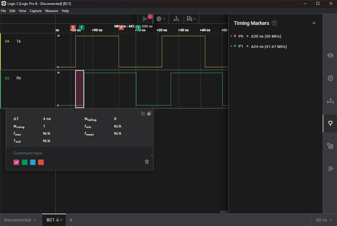

Correlation with Logic Analyzer Timing Results
When correlated with the Saleae logic analyzer measurements, the oscilloscope data provides complementary insight into the system’s behavior. While the logic analyzer highlights the digital Tx-to-Rx delay of approximately 20–25 ns, the oscilloscope reveals the analog mechanisms contributing to this delay, including:
  • Comparator threshold crossing in the LVPECL-to-LVCMOS conversion path
  • Finite settling time of the AC-coupled bias network
  • Buffer and driver propagation delay in the level translators
The slight asymmetry observed between rising and falling edges is consistent with the AC-coupled LVPECL interface and does not indicate any malfunction or instability. The delay remains deterministic and repeatable across cycles, which is critical for predictable system behavior.

The custom LVCMOS-to-LVPECL level conversion circuit was successfully validated using both logic analyzer and oscilloscope measurements. The Saleae logic analyzer capture shows a clear and repeatable delay between the FPGA transmit (Tx) and receive (Rx) signals. The measured end-to-end Tx-to-Rx latency is approximately 20–25 ns, which remains consistent across multiple cycles, indicating deterministic system behavior.
Oscilloscope measurements of the LVPECL outputs confirm correct differential operation with the expected phase inversion between the complementary signals. The observed signal frequency (~25 MHz) matches the FPGA-generated input, demonstrating that the converter preserves timing accuracy. The AC-coupled interface establishes a stable LVPECL common-mode voltage through the passive bias network, with no significant overshoot, ringing, or reflection artifacts.
The slight edge asymmetry and baseline settling visible in the waveforms are consistent with AC-coupled LVPECL signaling and do not impact functional correctness. Overall, the results confirm that the level conversion circuit provides clean signal translation and predictable latency, making it suitable for reliable interfacing between the FPGA and the Broadcom AFBR-FS50B00 optical transceiver.
