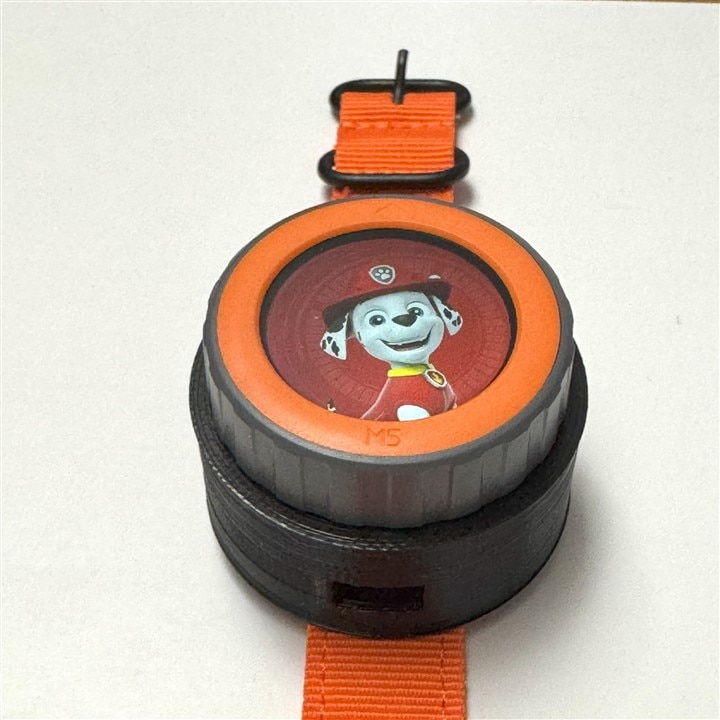

He is a fan of the Paw Patrol cartoon pups and I made him a wrist mounted display using an M5Stack M5Dial round display with rotary encoder.  I wasn't able to implement much more than a display that showed the different characters as you rotated the dial.  The Arduino Giga Display bundle would be a nice way to add a handheld HMI component to interface with the wrist display and provide additional audio and imaging capabilities.

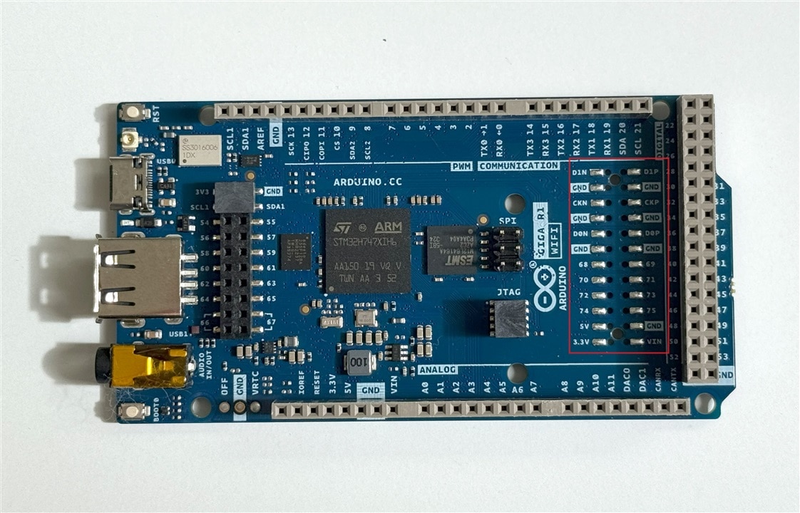

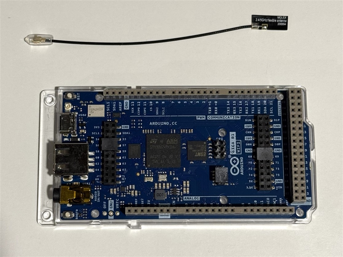

There really isn't much to show with the unboxing.  The Arduino Giga R1 and the Giga Display Shield were individually packaged in typical Arduino boxes.  The only additional component was a small WiFi antenna that was included with the Giga R1.

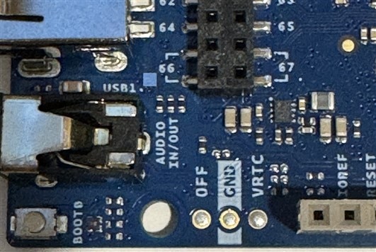

I had a couple of issues with the Giga R1 that I received.  The first was that the WiFi antenna had been crushed by the Giga R1 when it was packed in the box and more significantly the Giga R1 board was missing one of the passthrough connectors used to mount the Display Shield.  This is shown outlined in red.
Fortunately,    was able to get Arduino to send me a replacement which I received in about 2 weeks which is shown below.

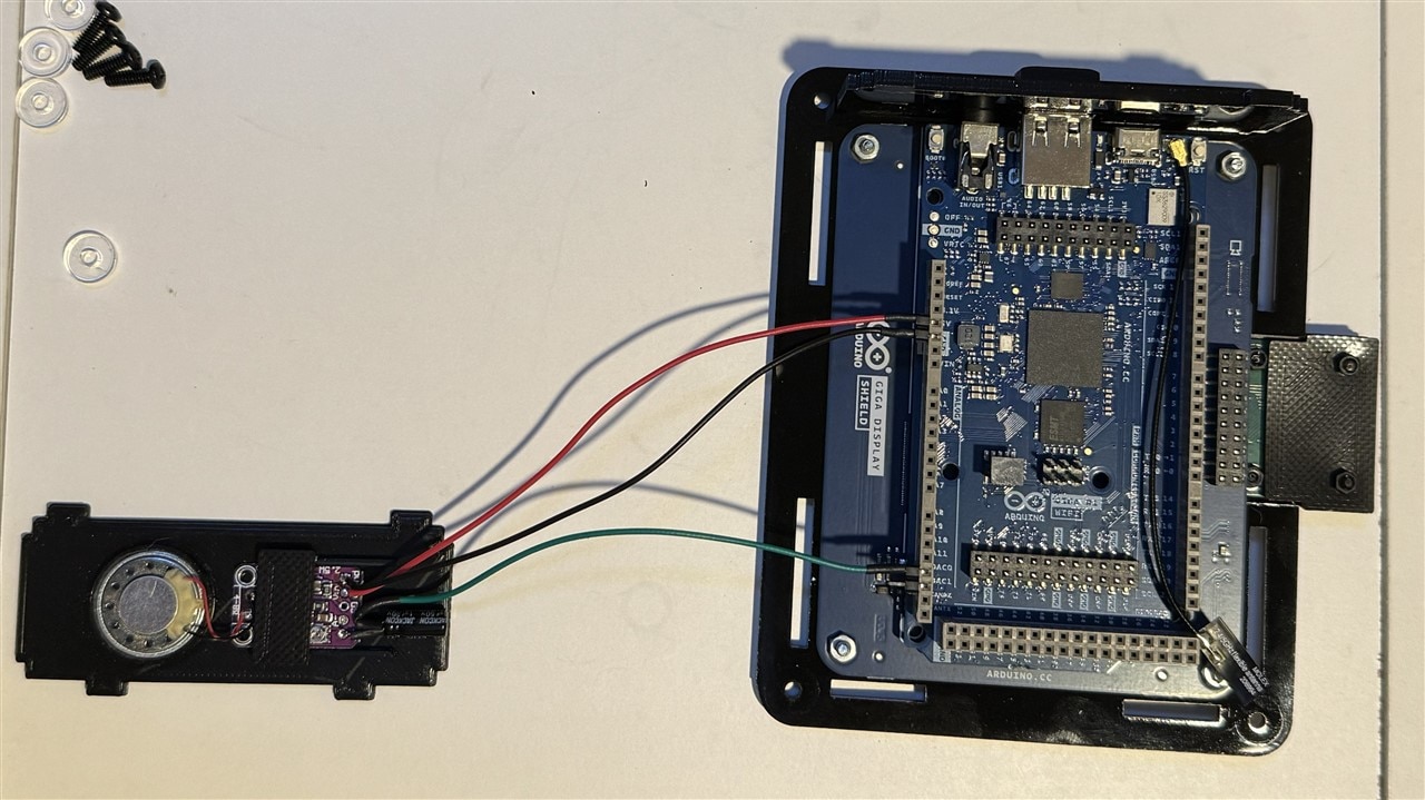

Other than that there weren't any issues with what I received.  The one surprise that I had was that the display mounts on the bottom of the Giga rather than the top.  It makes sense since that allows access to the socket headers on the top of the Giga so that other shields could be used with the display.

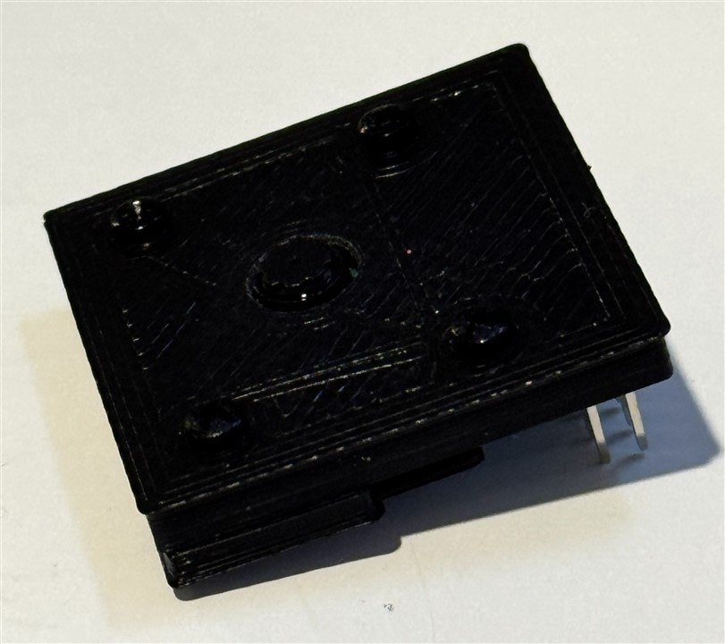

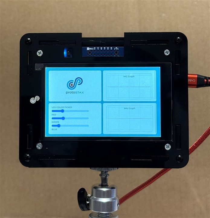

ProtoStax Case
I saw a Hackster project that used a ProtoStax case.  It's a nice sturdy acrylic case with removeable sides, so I decided to buy a case rather than print one in order to save some time.  I got the obsidian case with the tripod mount and camera cutout.  Here a picture of the Giga R1 and Display Shield in the case on a tripod running the ProtoStax LVGL demo.
The case did not come with a camera housing, so I printed one to protect the camera.
And a video showing the demo using LVGL widgets to show sliders used to set the RGB LED color and graphs to display the microphone and IMU functions.

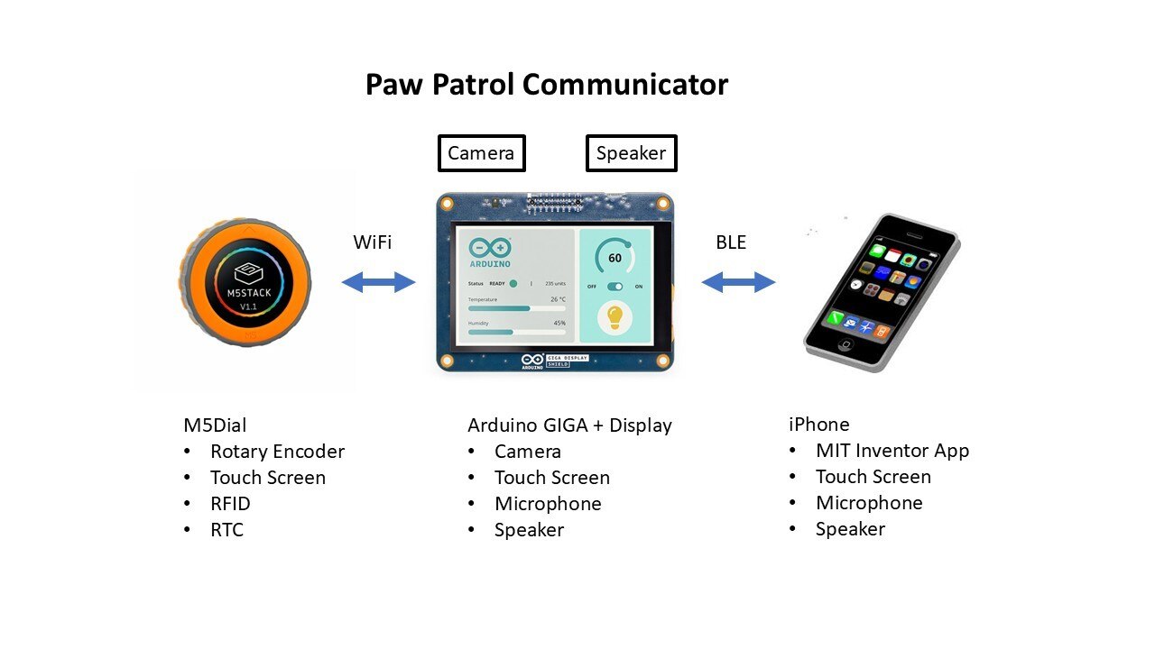

My initial plan was to evaluate the Giga Display bundle against each of the requirements in terms of both hardware and software capabilities and then implement an integrated application to interact to the wrist display.  As I got into the roadtest I realized that there are significant issues with the state of the current Arduino software in terms of simultaneously integrating some of the hardware interfaces.  As a result I've decided that I cannot implement the application.  I'll discuss the issues in the functional sections.
Just for reference here was my intended application.  I may try it with a different board.
I'll partition the review into these sections:

Paw Patrol Wrist Display
Here are a picture and a video of the wrist display.  The rotary encoder display is really intended for panel mounting, so it sits really high on the wrist.  It lacks an audio amplifier and speaker, so adding sound would have been difficult.  The biggest drawback is that even though it has battery support, the largest battery that I could shoehorn in was 35mAH.

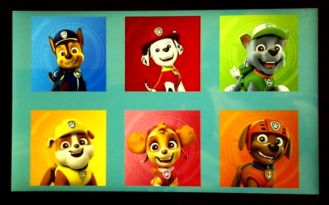

A short video cycling through three 800x480 images that I'm using for demo.  The first is my grandson, the second is the Paw Patrol wrist display and the third is the aqueduct in Segovia.  In the video I first use the Serial monitor input to select the images and then use the touch input to cycle through them.  There's a nice reflection of the webcam I'm using to record this in the glossy display screen when there is no image displayed Relaxed.  I am going to get an anti-glare screen protector to see if I can improve that.
For the communicator I really wanted to select a thumbnail image to evoke an action (contact a character, play audio or video, etc.).  I am familiar with LVGL, so that seemed a good choice for a GUI.   This began a somewhat unpleasant journey in the current state of the Arduino Giga software and documentation.  The Giga R1 is a couple of years old and there is the usual problem of encountering example programs that no longer work with the current software versions.  To be fair, there are a lot of tutorials for the Giga Display Shield.  It seems that Arduino started down a path of trying to make the GigaDisplay easier to program, but hasn't quite finished.  A basic problem is knowing which libraries to use and which ones are compatible.  A few of the tutorials had compilation issues with the latest board and software library versions, so that foreshadowed problems that I would encounter.

I later decided that what I wanted for the base of my GUI would be a 3x2 grid of character images and each image could be touched to interact with a specific character.  Because of the issues I've had with LVGL I'm not using it here although it would be nice to use the LVGL widgets.  I may try a hybrid approach later to add LVGL widgets, but still do the image drawing in GFX.  It is interesting that this particular program hasn't had any issues compiling without including lvgl.h for the GigaDisplayTouch library.  I am including the Arduino_H7_Video library, but that hasn't always resolved the LVGL issue with the touch library.
GigaDisplay_ImageGrid.ino

Video showing a unique response on the Serial Monitor for each character touched.

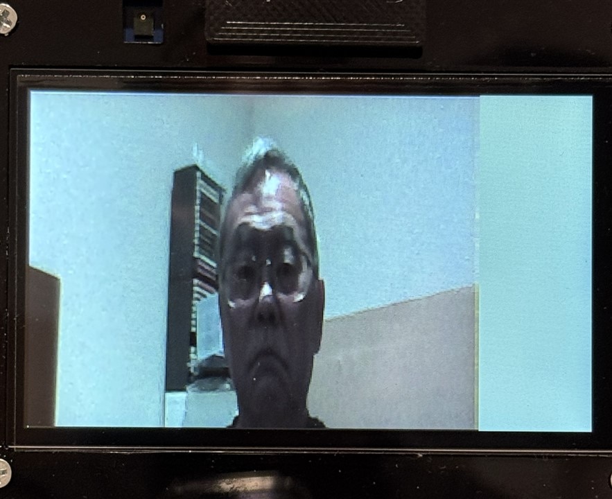

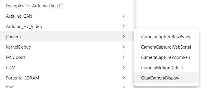

Camera/Image and Video Display
The Camera Tutorial points to the GigaCameraDisplay example that is included with the mbed_giga board package.
The Giga R1 is compatible with four DVP cameras from Arducam
For this roadtest I am using the OV7675 which has a resolution of 640x480 so it's a nice fit for the 800x480 display.
The camera initialization and operation uses the arducam_dvp library.
The example program provided some insight into some of the camera limitations. The example captures a 320x240 image and rotates it and scales it to 640x480 for display.  It seemed odd that it would not just capture a 640x480 image directly.  The rotation is necessary due to the orientation of the camera mounting on the display.  It appears that the framebuffer is being captured into the internal 1MB SRAM for speed (framerate) purposes, so that would restrict the size to 320x240.  The transformed display buffer is stored in the external SDRAM, so it can handle the larger image size.  The camera framebuffer could have been captured into SDRAM, but it would still have had to be transformed for display.  The other interesting thing was there was also another transformation for the color cameras.  There was an HTONS operation on each value.  In the program: #define HTONS(x) (((x >> 8) & 0x00FF) | ((x << 8) & 0xFF00)) which is a byte swap.  So, the MCU which is capturing the framebuffer is operating in little endian format but the display requires big endian format.  The grayscale cameras are only using a single byte so they don't require a swap.
Doug found that when he ran the example program that the image displayed on his screen was vertically flipped and horizontally mirrored, so he modified the mapping indexes in the transform routine to fix it.  I decided that I would use his code to verify my setup was working and I found that I needed the vertical flip but not the horizontal mirror, so I only modified one of the indexes.  It might be a difference between our cameras as he is using the GC2145 and I am using the OV7675.
I thought that most camera libraries have functions for vflip and hmirror and a quick look at the arducam_dvp.h file showed there are functions indeed defined.
And it does compile but the linker fails:
Another quick check of the arducam_dvp.cpp file showed that it did not have the functions implemented.
I went to the Arducam github repo and saw that there has only been one release of this library and that it was over 2 years ago.  It seems that this library was never completed and it doesn't seem to be actively supported.  I filed an issue but there hasn't been any response.  I use quite a few Arducam cameras, so this was quite disappointing.
Here is my version of the example program using the vflip part of Doug's modification.
GigaCameraDisplay_DW.ino

Here is an image from my iPhone which still does not look as good clear as the display as I see it.  The colors are also somewhat washed out.
And here is a short video.  I stood up so that you could see the lettering on my t-shirt to show that I did not need mirroring.
I wanted to try capturing the camera frame buffer in SDRAM, so that I could capture the 640x480 resolution of my camera.  I decided that I would use the CameraCaptureWebserial example and modify it to use the SDRAM for the framebuffer.  This example allows streaming the camera over USB Serial to a web browser application for display.
GigaCameraCaptureWebSerial.ino

The video capture of my browser screen.  There is noticeable lag running 640x480 over serial.
I did try allocating SDRAM for both the camera framebuffer and the display buffer in the first GigaCameraDisplay example, but I didn't get that to work.  I used the rotation and HTON transformation without scaling.  No compilation issues, just didn't get anything displayed.  That should work, so I'll go back and debug it when I have more time.

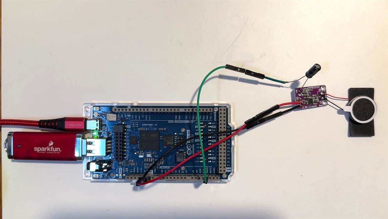

Audio Input and Output
Audio output
The Giga R1 has 2 DACs and the Display Shield has a PDM microphone.  These are brought out an audio jack and the analog header.
I tried using headphones in the audio jack and that works with low sound volume, but for my application I would need an external speaker and audio amplifier.  I could have used an I2S amplifier, but for simplicity and ease of implementation I chose to use a mono PAM8302 analog amplifier board that I drove from the DAC0 pin on the analog header.
Here is a pic of my initial test setup:
The good news is the ProtoStax case has removeable side panels, so I printed a new side panel to mount the PAM8302 board and mini speaker.
The audio files used for the examples are 16-bit PCM WAV files (stereo or mono).  Files are generally stored and accessed from a FAT32 formatted USB drive.  The files that I am using were found on the free database at 101 Soundboards.  They have quite a few AI generated voice clips for the PAW Patrol characters.
I'll have to buy Doug a coffee sometime because since he did modify one of the AdvancedAnalog examples that utilized the DAC with the Display and USB storage, so that was a good place to start again (at least I knew that would work).
GigaR1_WavPlayer_DW.ino

At this point it appeared that it might be easy be to combine audio and the GUI.  I just had to verify that I could access the USB drive that GigaAudio had mounted.  Unfortunately, I could not figure out how to access the drive using the standard commands (fopen, fread)  that are use by USBHostMSD and the FATFileSystem interfaces.  I could not even get it to show me what the mount point was.  It won't be helpful if I can't access the drive for image files.
I then discovered that the AdvancedAnalog library had a WavReader class and an example that used it.

That looked promising because that example used the USBHostMSD and FATFileSystem.  Unfortunately, the drive would connect and mount but WavReader could not open the file - so the example did not work.  It appears that there are version mismatches with the libraries that are causing problems.
The only workaround at this point is to use the low level code that is used in the example that Doug used.

Battery support
The Giga R1 does not have a battery interface, but I thought that I'd  look into how difficult it would be to add one.  The power consumption of the Giga R1 + Display Shield depends on the specific use case with the primary high power consumers being WiFi and the Display backlight.  A reasonable estimate is 150mA for the Giga R1 and 250mA for the Display Shield, so a 1000mAH battery would provide 2+ hours of runtime.  The simplest solution is to use a UPS type battery management device like the Adafruit PowerBoost 1000C.  The PowerBoost provides battery management and charging plus an output boost circuit to +5.2V.  There is no easy access to the USB-C VBUS on the Giga R1, so it seems the best solution is to have a separate independent charging source for the PowerBoost and use the USB-C for data only.  The PowerBoost +5.2V output would tie to the Giga R1 5V pin on the Power header.  Since the 5V net is after the Schottky diode from USB-C VBUS, the Giga R1 would always be powered by the PowerBoost unless the battery were depleted and there was no charging source then it would use the USB-C power if it were connected.
Here is the Giga R1 Power Tree
And a simple block diagram of the hookup (common ground between boards is assumed).
A feature that the Giga R1 has that is helpful for UPS operation is an "OFF" pin.   Behind the Audio Output jack there is a spot for a 3 pin header for OFF and VRTC which is the backup battery input for the MCU RTC.  The OFF pin connects to the Enable pin of the onboard +3.3V regulator and will shut it down when connected to GND.  If power is still available to the board input, then the +3.3V will power up when the OFF pin is released.
I have lots of room in the ProtoStax case for a PowerBoost and a battery, but I would probably have to modify or print a new backplate and top plate to mount everything.
