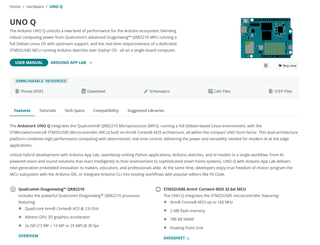

First Look
The Arduino UNO Q comes with the traditional UNO form factor and features a modern USB-C connector instead of the USB Type-B port used in the traditional Arduino UNO. The pin headers are fully compatible with the classic Arduino UNO, while the board also includes an additional QWIIC connector and an onboard 8x13 LED matrix.
The top side of the board includes the main processor, LPDDR4 RAM, power management IC (PMIC), WiFi and BLE communication module, and USB-C bridge IC. The bottom side of the board includes the microcontroller and the eMMC storage IC. There are also two advanced expansion headers on the bottom side.

A bit of hardware details:
The Thinking Brain (MPU):
  • Qualcomm Dragonwing QRB2210 Quad Core Arm Cortex-A53 processor
  • Qualcomm Adreno GPU and Qualcomm Hexagon DSP for AI Inference and digital signal processing
  • Dual ISP Video Processing
  • Integrated WiFi 5 and Bluetooth 5.0 connectivity
The Acting Brain (MCU):
  • STM32U585 Arm® Cortex®-M33 up to 160 MHz
  • 2 MB flash memory
  • 786 kB SRAM
  • Floating Point Unit
  • Accurate ADC
  • High-speed GPIO

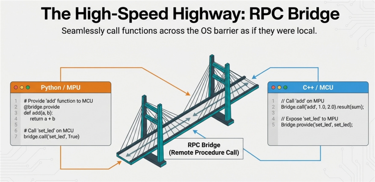

Arduino offers RPC Bridge (Remote Procedure Call) for effortless communication between the MPU and MCU.

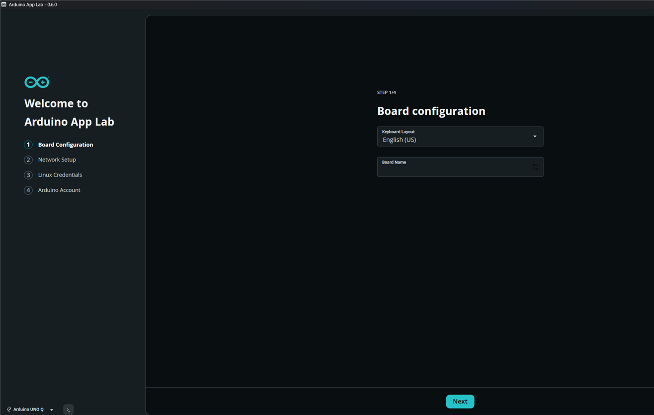

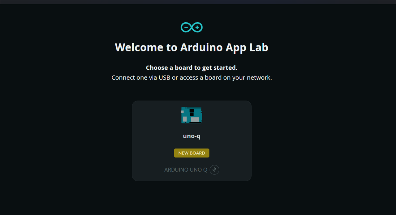

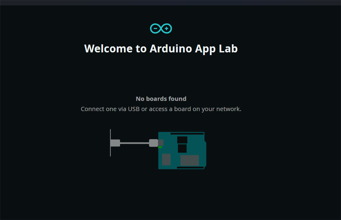

After installing the App Lab, I double-clicked on the App Lab desktop icon to run it and got the following message.
From the message, I realized that I needed to connect the Arduino UNO Q to my PC before running the App Lab. So, I connected the board using a USB-C cable and was greeted by a beautiful blue Arduino logo animation on the dot-matrix LEDs. In addition, the green power LED turned on, and #3 green LEDs started blinking.
I ran the App Lab again and got the following message:

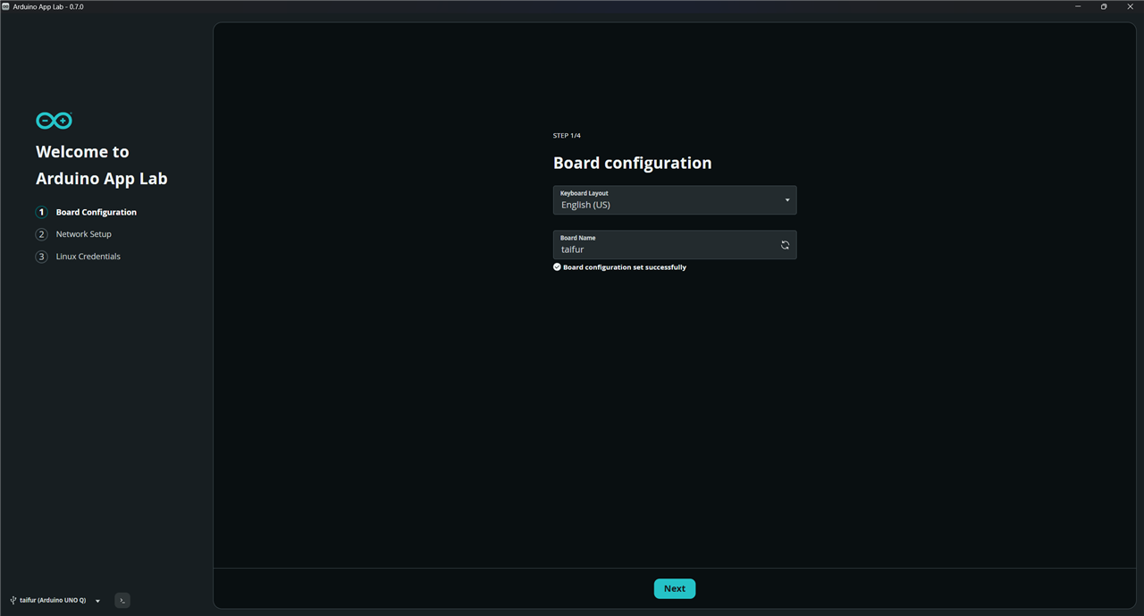

So, the Arduino UNO Q board is detected automatically. I clicked on the board name, and App Lab redirected me to the following configuration interface. I gave a name to the board (I tried a name with _ but failed) and clicked on the next button at the bottom.

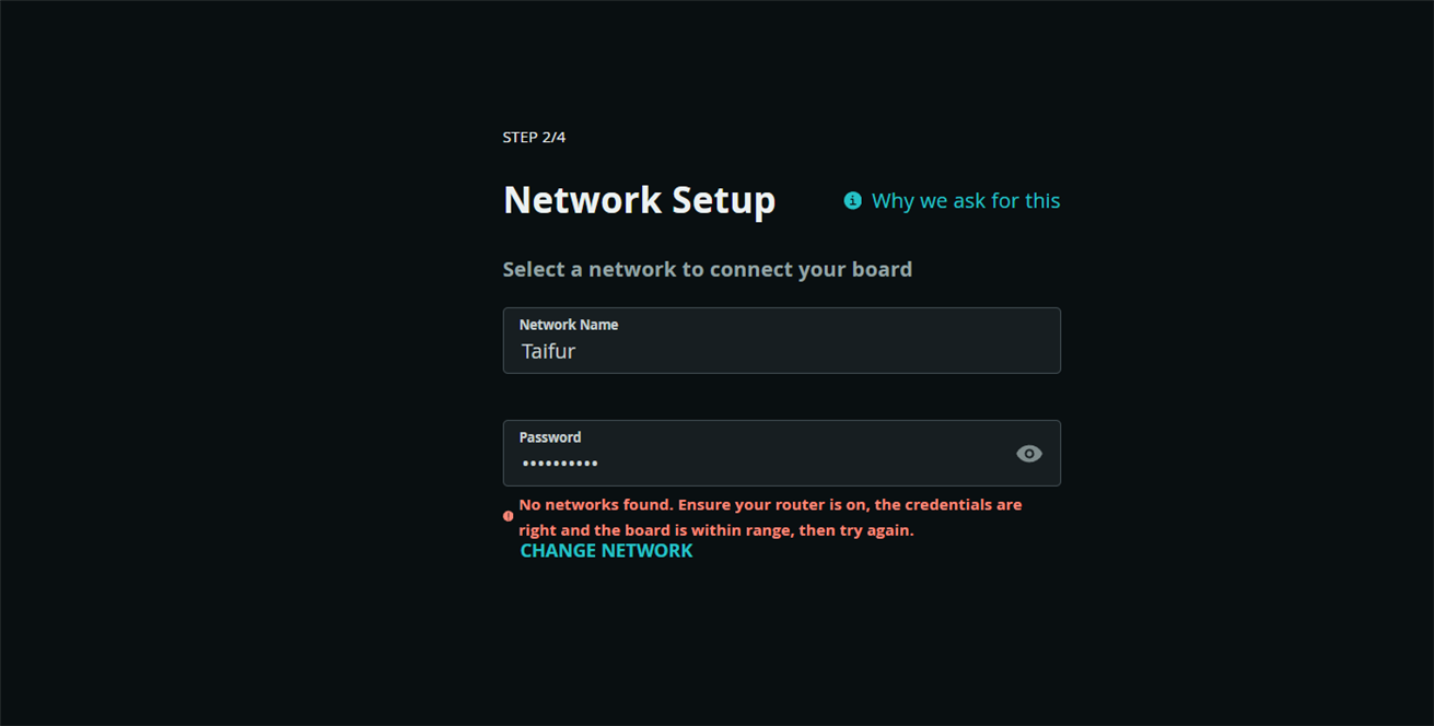

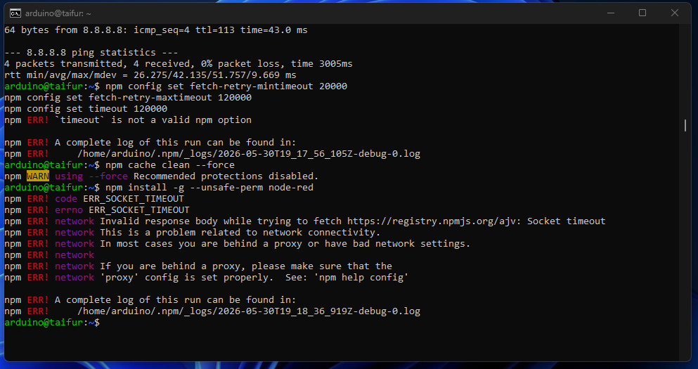

It guided me to the network setup window, but I was getting the following error message, though my WiFi password was correct. I tried multiple times and got the same message. So, I skipped the network setup option.

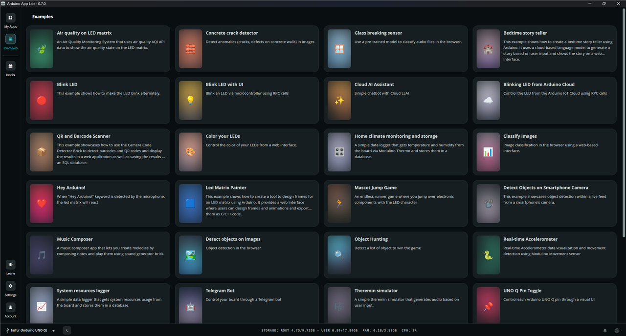

After setting the Linux password, App Lab started successfully with several examples.

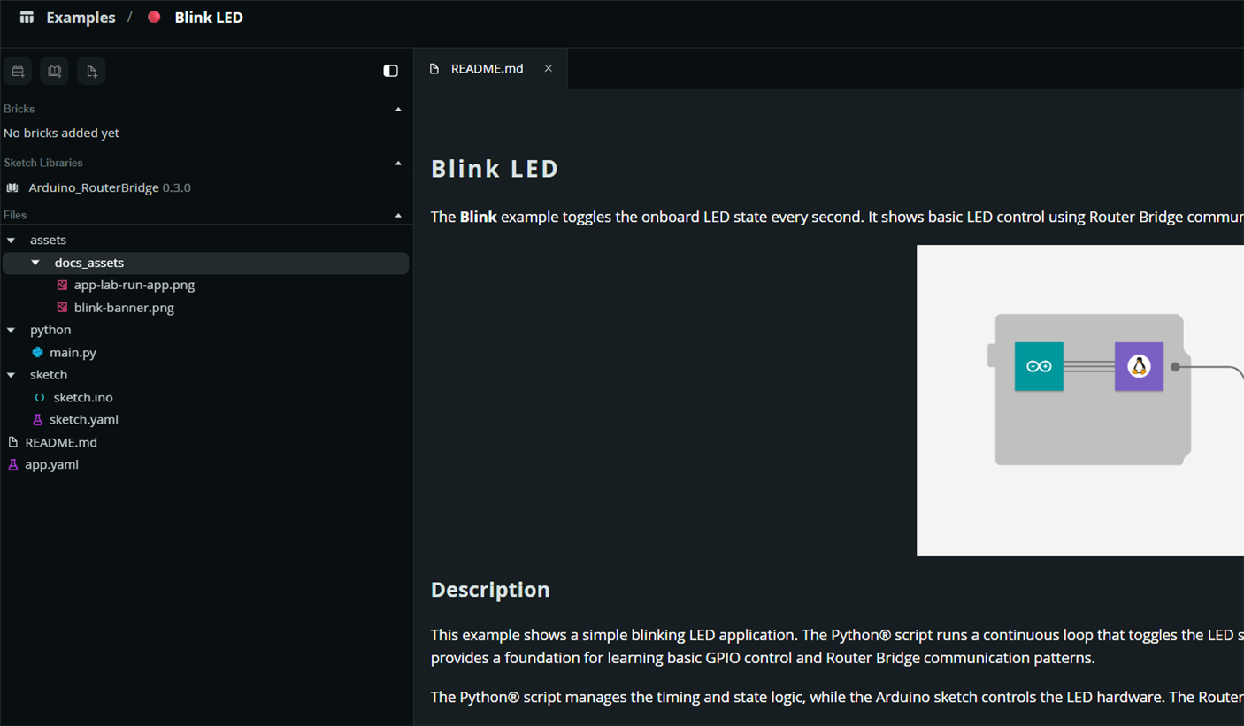

I opened the Blink LED example as my first experiment. After opening the Blink LED app, a notification appeared to update the App Lab. I updated the app, but then I noticed that App Lab was stuck on the board configuration page. I clicked the “Next” button, but nothing happened. I closed the app and ran it again, but I still faced the same problem. I also connected and disconnected the Arduino UNO Q board several times, but the issue remained unchanged. Finally, after restarting my PC, the problem was solved.

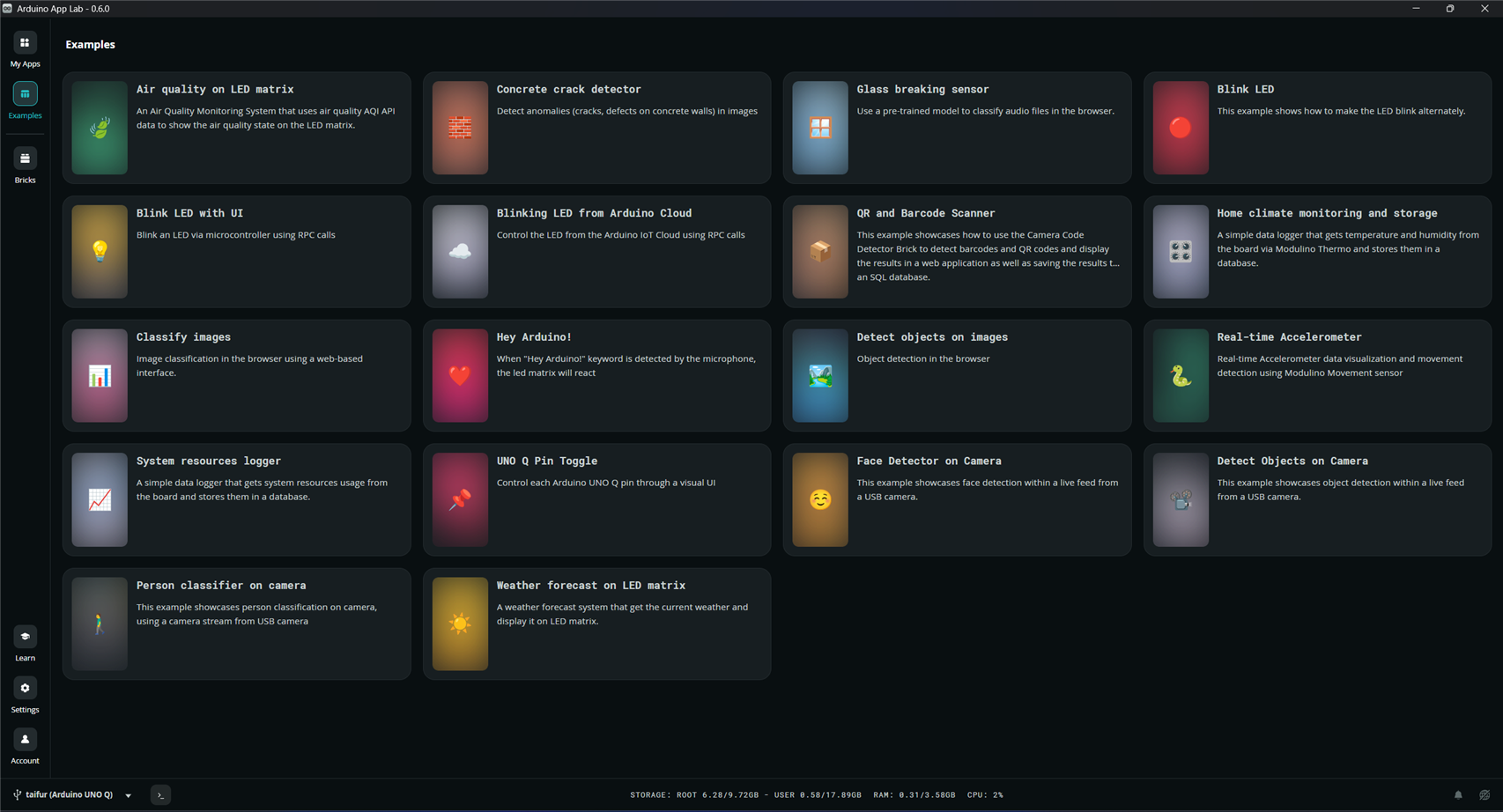

The updated App Lab ran with some new examples.
I opened the Blink LED example, read the README document, and realized that it is quite different from the traditional Blink LED examples used with other Arduino boards. In this example, both the MPU and MCU are involved in controlling the LED. The MPU, programmed in Python, calculates the timing interval, while the MCU, programmed using traditional Arduino programming (C++), actually turns the LED ON and OFF based on the timing information provided by the MPU. The Router Bridge enables communication between the MPU and MCU.
The following screenshot shows the structure of the Blink LED program.
After successfully testing the Blink LED program, I became curious to try a few more examples. However, I realized that most of the examples depend on external hardware such as a camera or microphone, and require the Arduino UNO Q to run either in network mode or single-board computer mode.

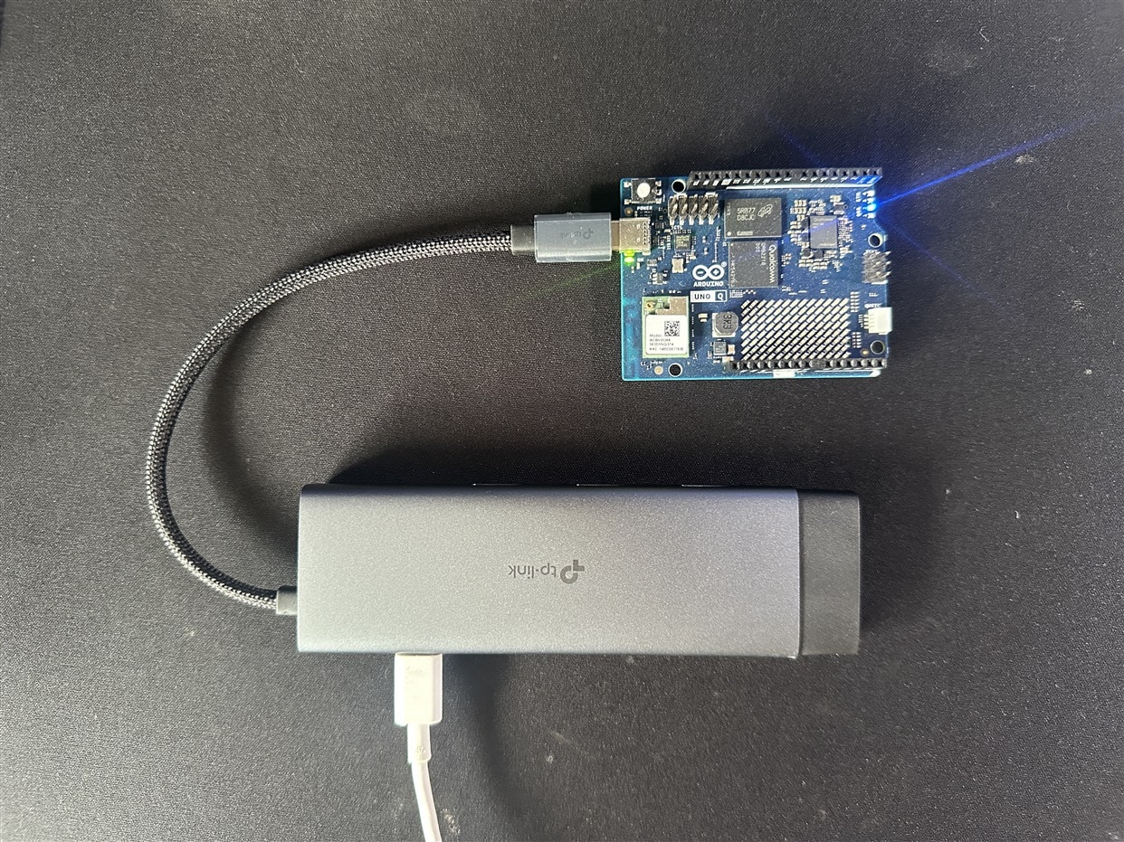

I connected the USB-C Hub to the Arduino board and powered the hub externally. The Arduino started successfully in single-board computer mode and became discoverable from the Arduino App Lab.

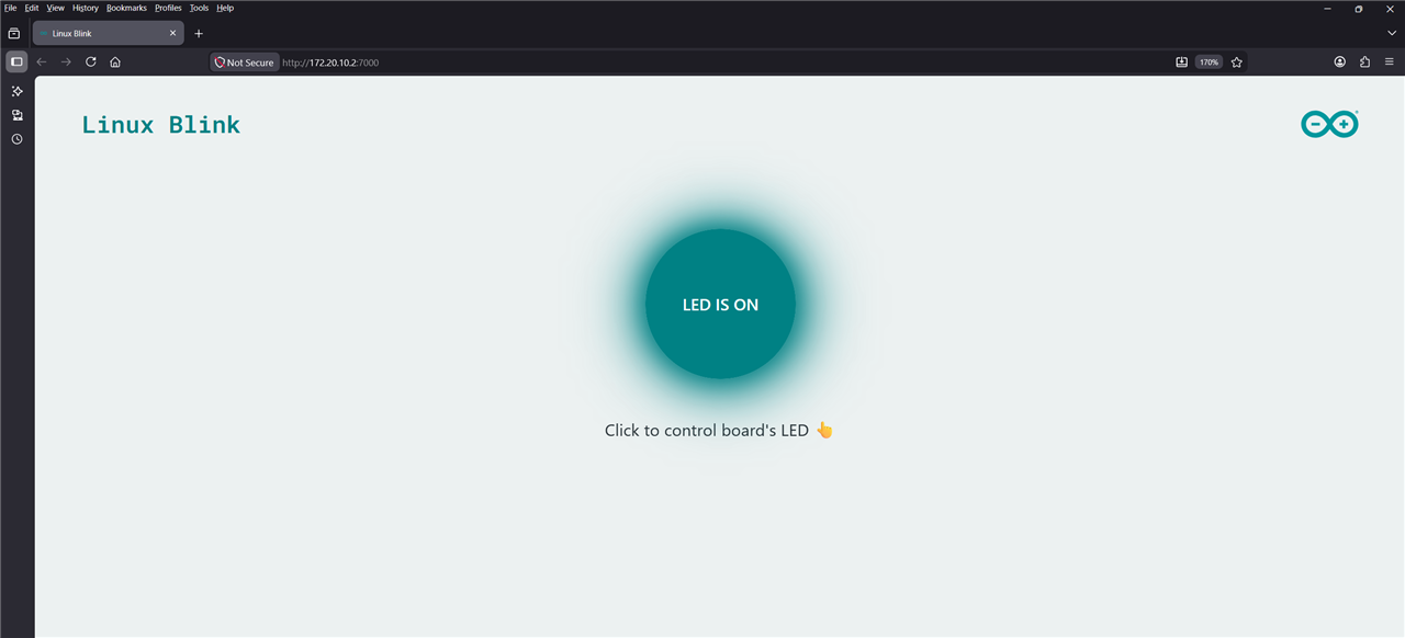

I then opened the Blink LED with UI example and ran the application. The browser window opened automatically, and the application worked as expected. The documentation provided with the app was also very clear and easy to understand.

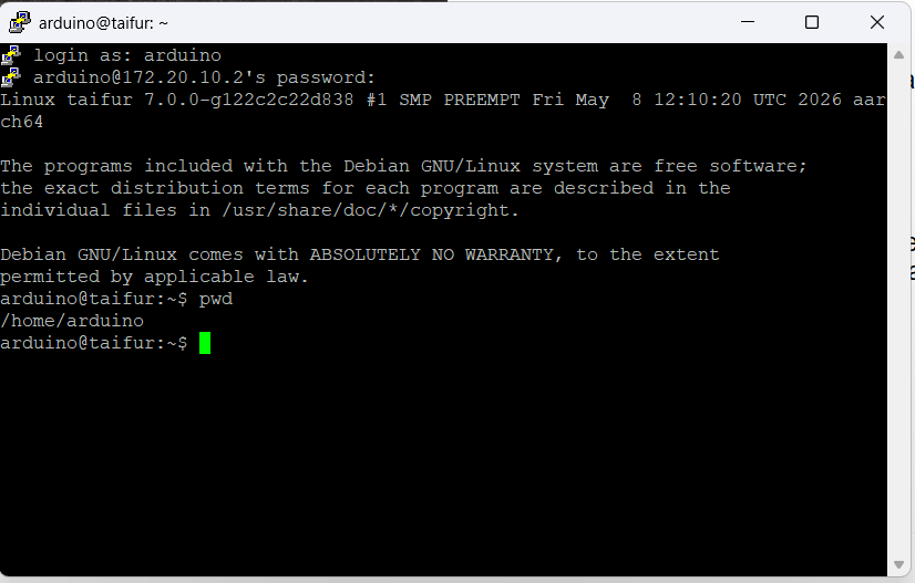

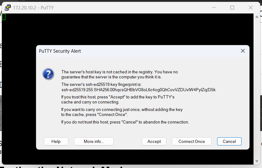

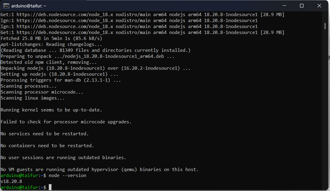

In this stage, I was curious to check whether SSH was working or not. So, I opened PuTTY and entered the IP address of the Arduino UNO Q. The board responded immediately, confirming that the SSH connection was working properly.
After accepting, I entered the name and password for the board and got the following response.

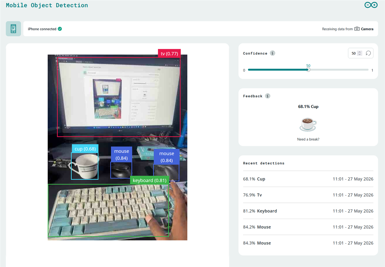

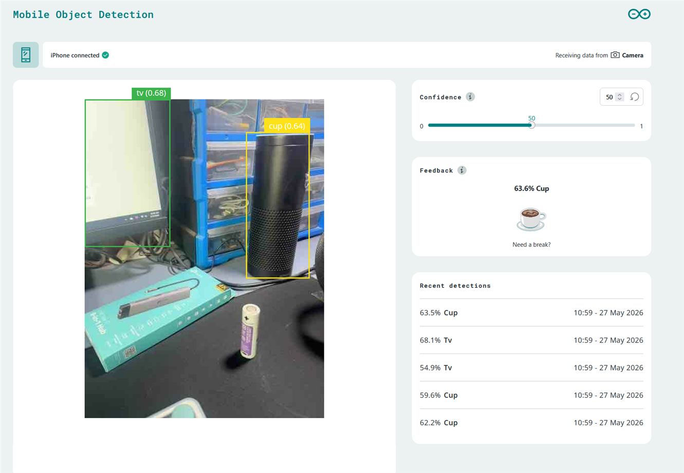

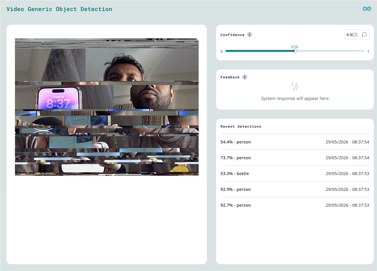

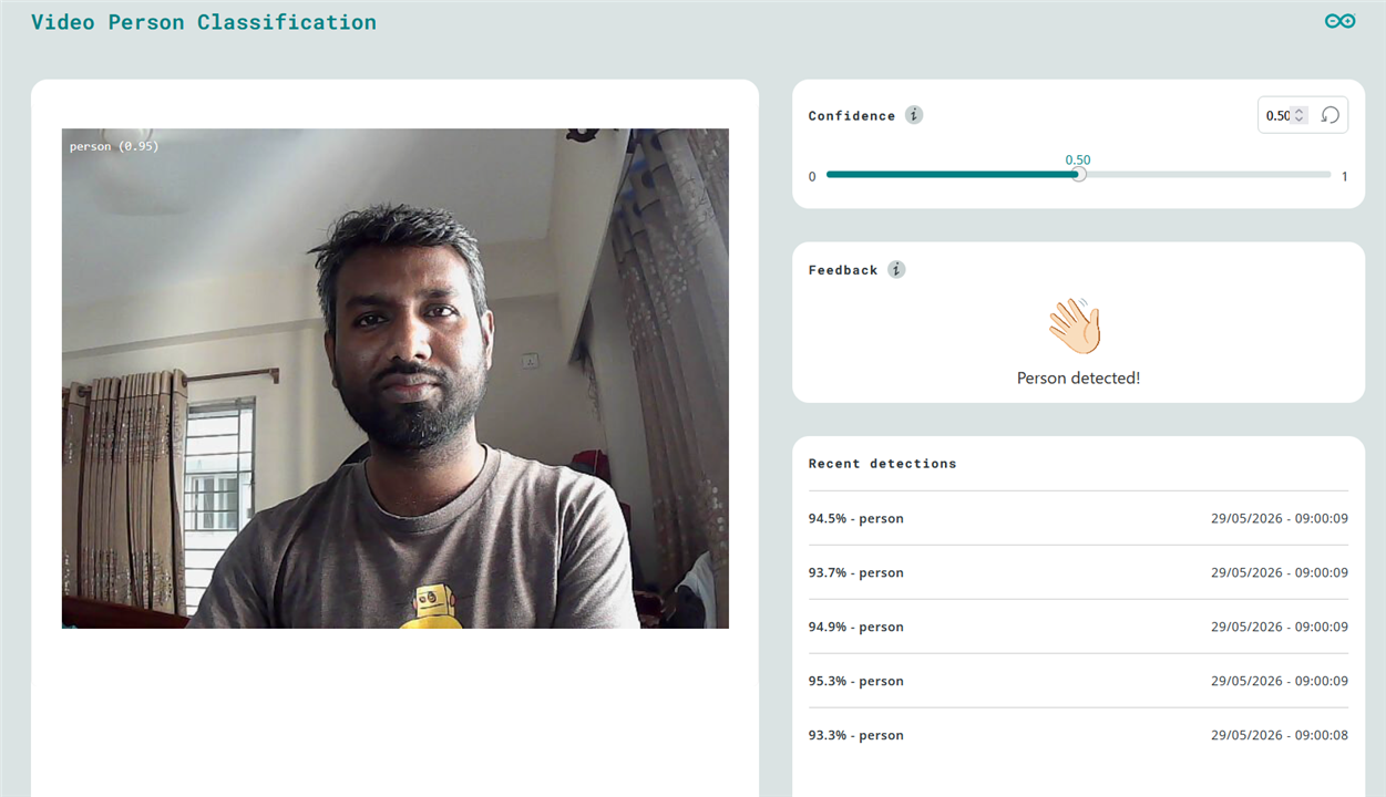

In the next step, I tried to run an object detection application on the Arduino UNO Q. Normally, object detection requires a USB camera connected directly to the board. However, I found an example application called “Detect Object on Smartphone Camera.” Before connecting an external camera to the Arduino UNO Q, I was interested in testing object detection using my smartphone camera with the board. I carefully read the documentation to understand how the application works. After that, I downloaded the Arduino IoT Cloud Remote app and logged into it successfully.
From the App Lab, I clicked on the Run button. It took a few minutes to download and extract the required model and supporting files before deploying the application to the board. After the setup was completed, the following browser window opened automatically, displaying a QR code to connect the smartphone camera.

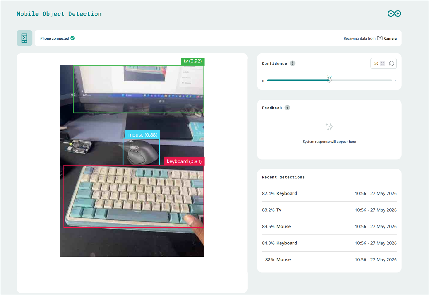

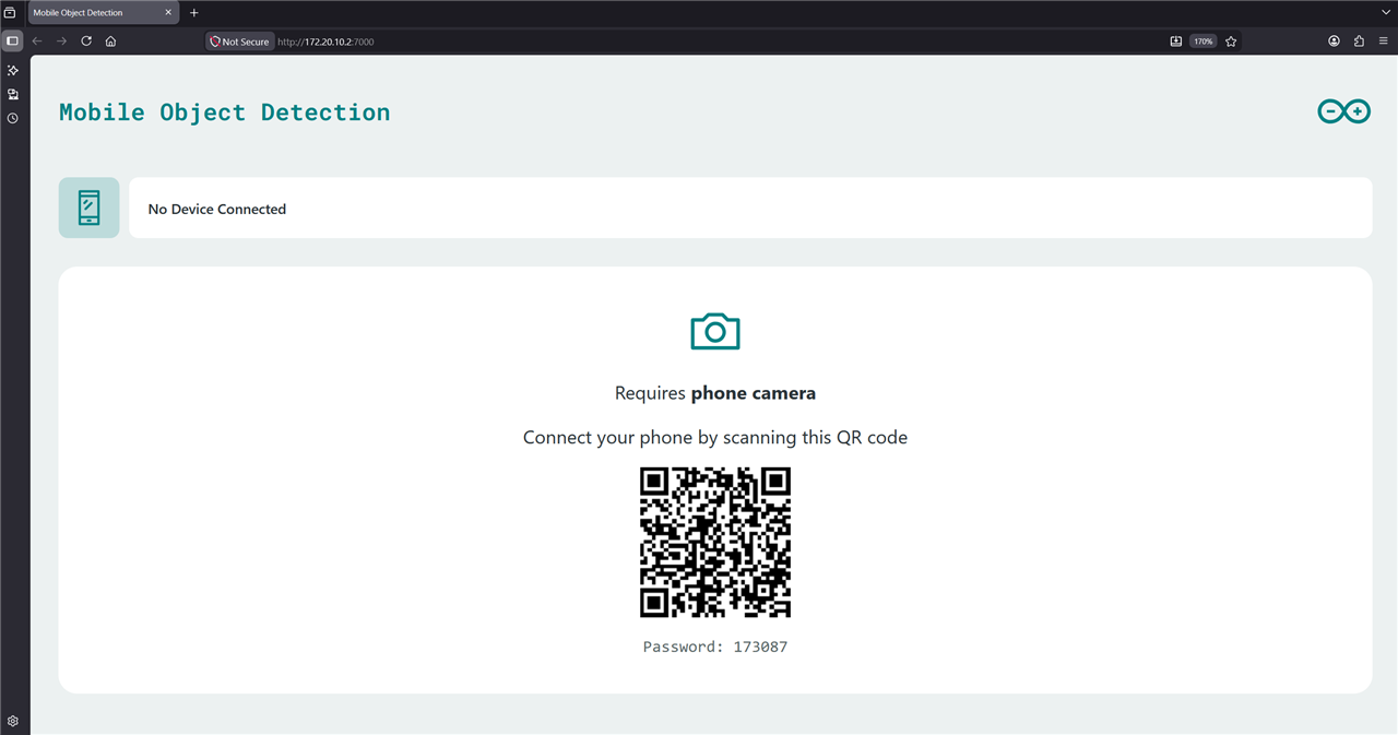

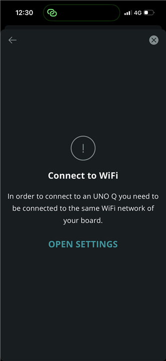

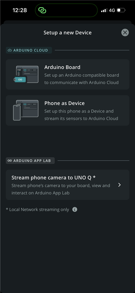

Now it was time to connect the smartphone camera. To do that, I selected the “Stream Phone Camera to UNO Q” option from the smartphone app. During this step, I encountered an interesting issue.
Initially, I was unable to connect the Arduino UNO Q board to my router’s Wi-Fi network, possibly because my Wi-Fi SSID contained an “&” character. To work around the problem, I enabled the hotspot on my iPhone and connected both my PC and the Arduino board to the hotspot network. However, when I tried to connect the smartphone camera to the UNO Q, the app displayed a message indicating that the phone itself also needed to be connected to the same Wi-Fi network.
It was a strange issue at first, but logically understandable. The phone was using mobile data while simultaneously acting as a Wi-Fi hotspot. To resolve the connection problem, I renamed my Wi-Fi SSID by removing the “&” character, and after that, the connection worked successfully.
The Arduino UNO Q then became discoverable from my phone. I connected the board to the mobile app using the password displayed in the browser window, and the detection result appeared instantly in the browser.
It successfully detected my keyboard, mouse, and monitor with a high level of confidence. I was very impressed with the response time of the system. It also demonstrated excellent performance in detecting multiple objects within a single frame, as shown in the following screenshot.
It detected my Amazon Echo device as a cup. I also tried detecting my headphones, a Li-ion battery, and my 3D printer, but the model was unable to recognize them successfully.

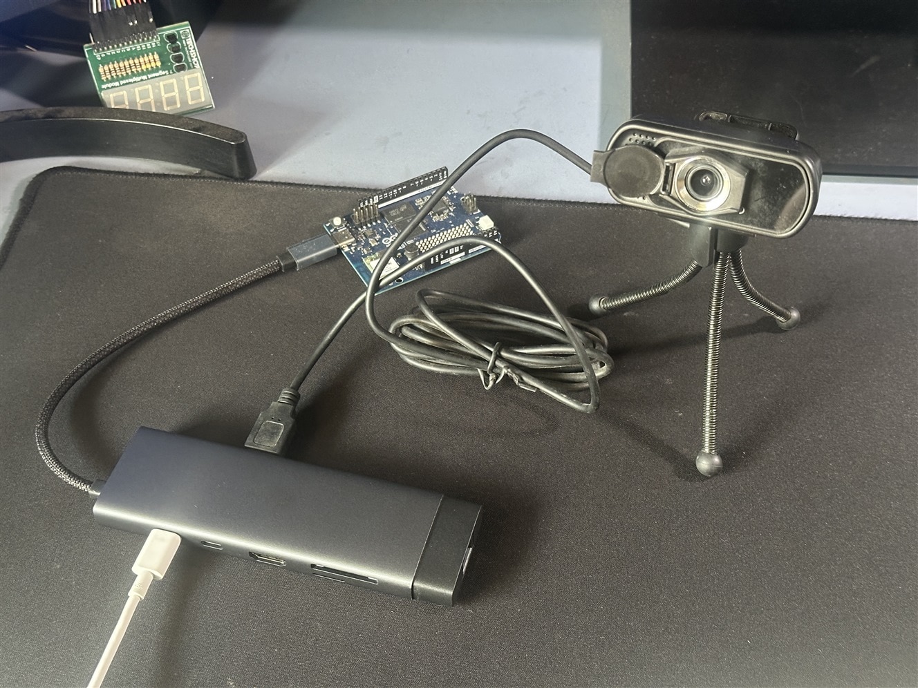

Working with the Camera

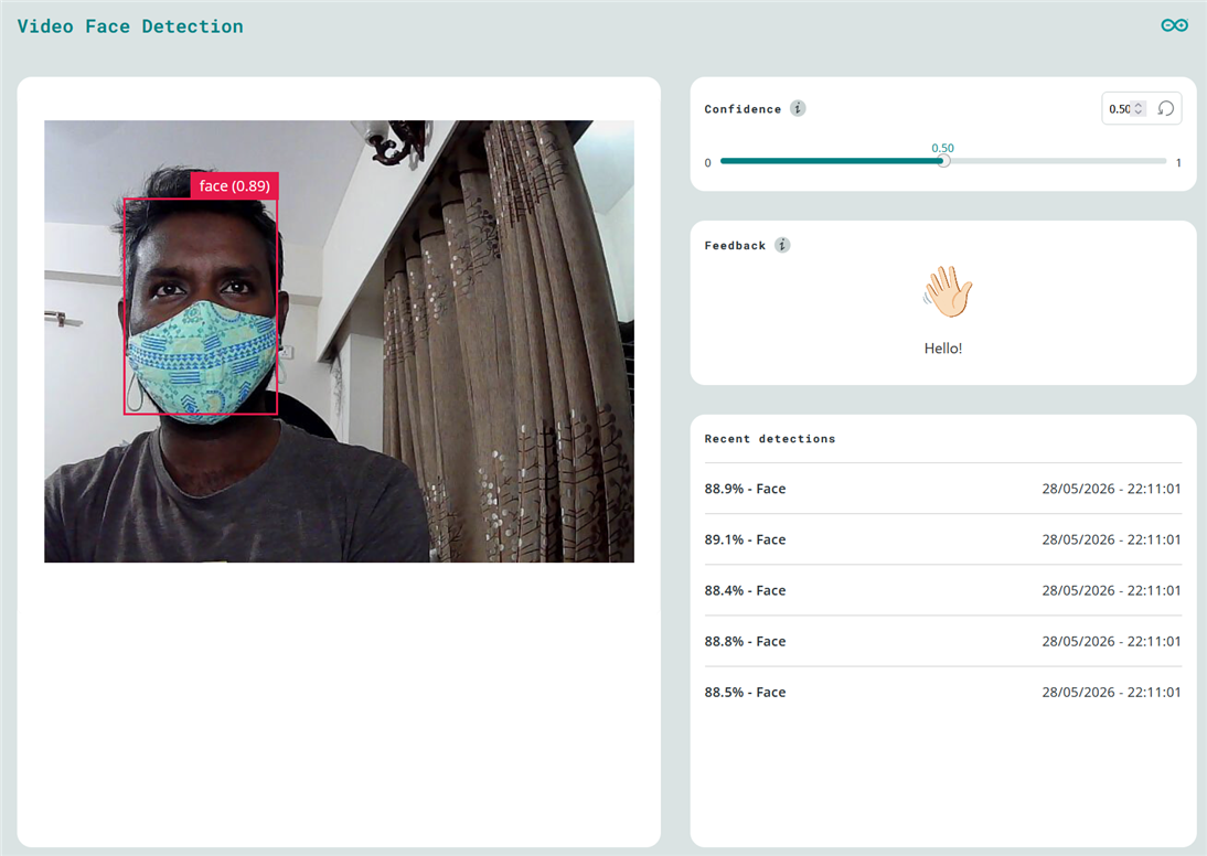

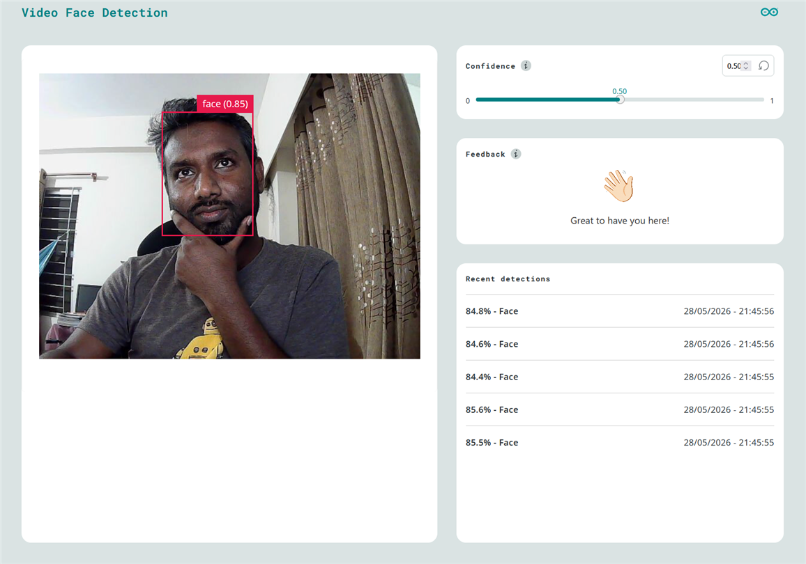

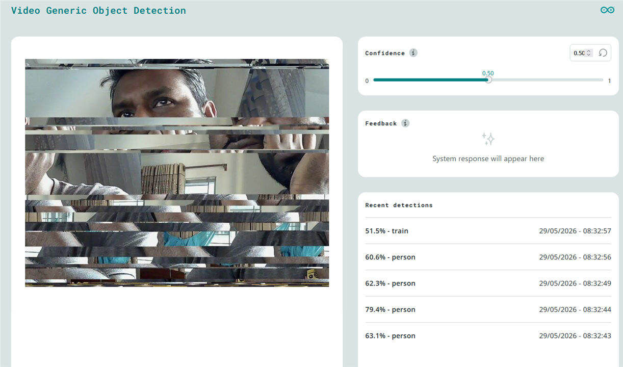

I connected my USB webcam through the USB-C hub and then opened the Arduino App Lab. After launching the “Face Detection on Camera” example application, a browser window opened automatically, and the camera successfully detected me without any driver-related issues. The application detected my face with around 85% confidence. Initially, the response was almost real-time, but after a short while, I noticed nearly a 10-second delay in the camera streaming. This could possibly be caused by my slow network connection, although I am not completely sure.
Even with a musk, the accuracy was quite good.
After completing the face detection experiment, I opened the “Detect Object on Camera” application. The app ran perfectly and successfully detected me as a person. However, after a short time, I noticed some distortion and visual artifacts in the camera image, as shown in the screenshot below.
I disconnected and reconnected the board’s power, then relaunched the App Lab and ran the example application again. This time, I tried detecting my phone, but after a short while, I encountered the same issue again.
I was curious to understand why this was happening. Suddenly, one thing came to mind: I had been using a 2A smartphone power adapter to power the board through the external USB hub. I decided to try the power adapter that came with the Roadtest kit instead. After connecting the Multicomp Pro MP009260 30W power supply, the problem was solved. I successfully tried the Person Classifier on Camera.

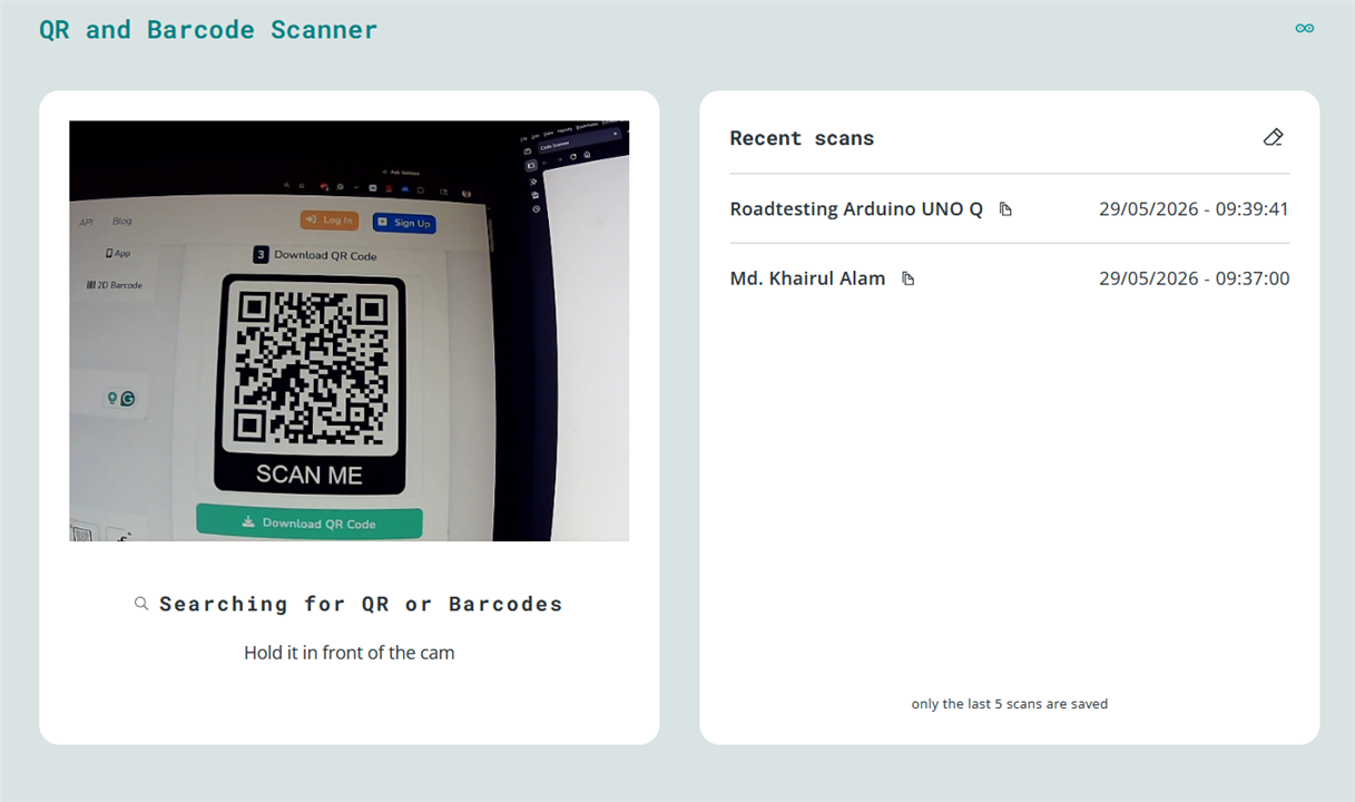

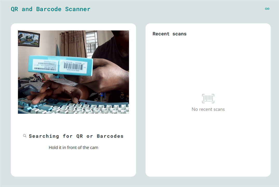

I tried to read Barcode and QR code using the QR and Barcode Scanner example app, but I failed to read either. I tried from a different distance and angle, but I was out of luck.
I suspected the codes I had tested were too small, so I generated a few QR codes and barcodes on my computer and tried again. This time, the app successfully read them.

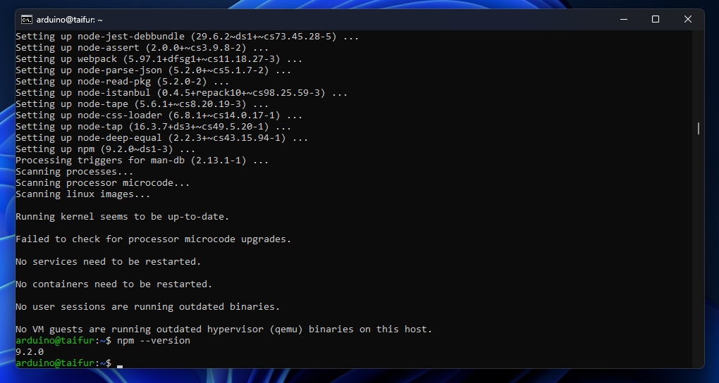

Experimenting with QWIIC Sensors
In this stage, I connected and tested the SparkFun QWIIC Environmental Combo Sensor with the Arduino UNO Q. The connection process was straightforward, thanks to the QWIIC ecosystem's plug-and-play design. I simply connected the QWIIC Environmental Combo Sensor to the Arduino UNO Q's QWIIC connector using a short QWIIC cable, no soldering or complex wiring required.

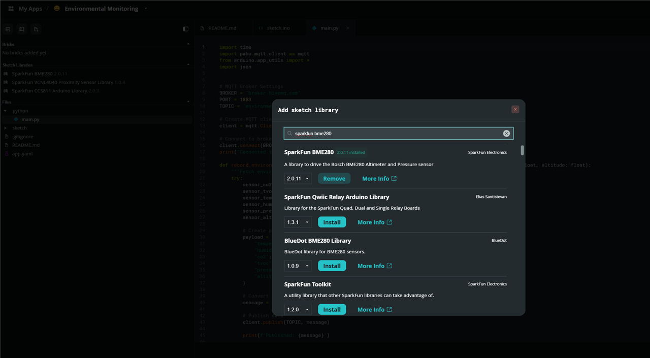

After connecting the QWIIC sensor, the next step is to write the code. I created a new App in App Lab named "Environmental Monitoring." I downloaded two libraries (SparkFun BME280 & SparkFun CCS811) for the sensor.
Then, with the help of the example programs, I wrote the code for reading the sensor data. I was facing problem interfacing the sensor using I2C, and suddenly I realized that the QWIIC port is connected to Wire1 instead of Wire. So, I modified the code and successfully got the sensor data as shown in the screenshot.

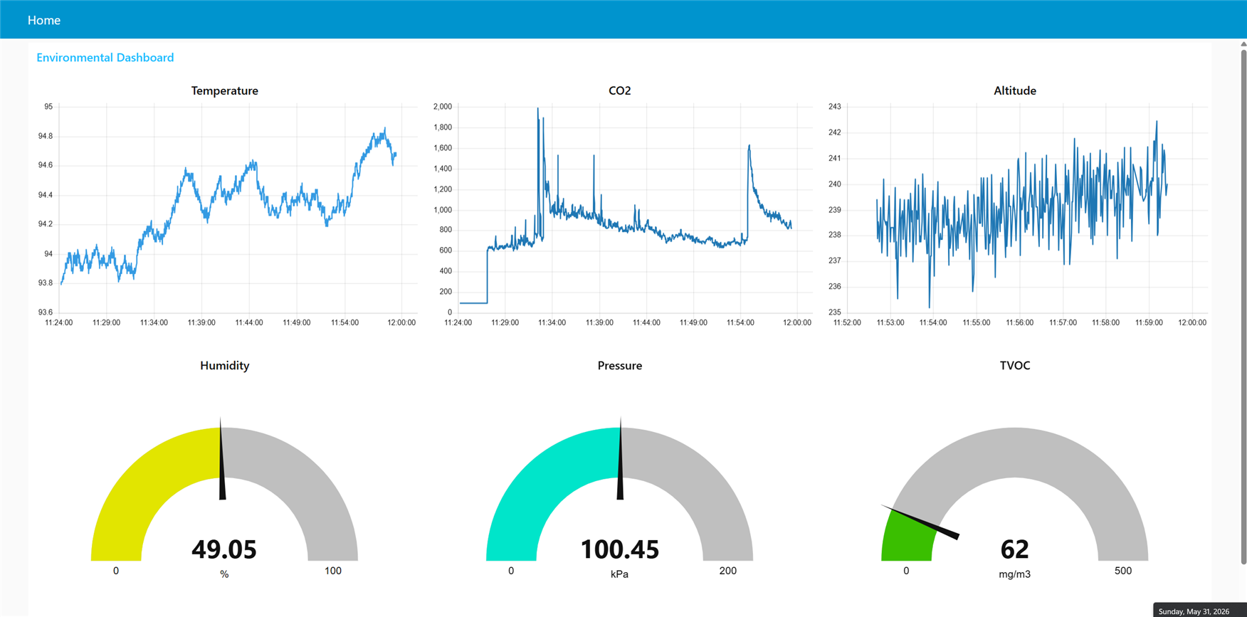

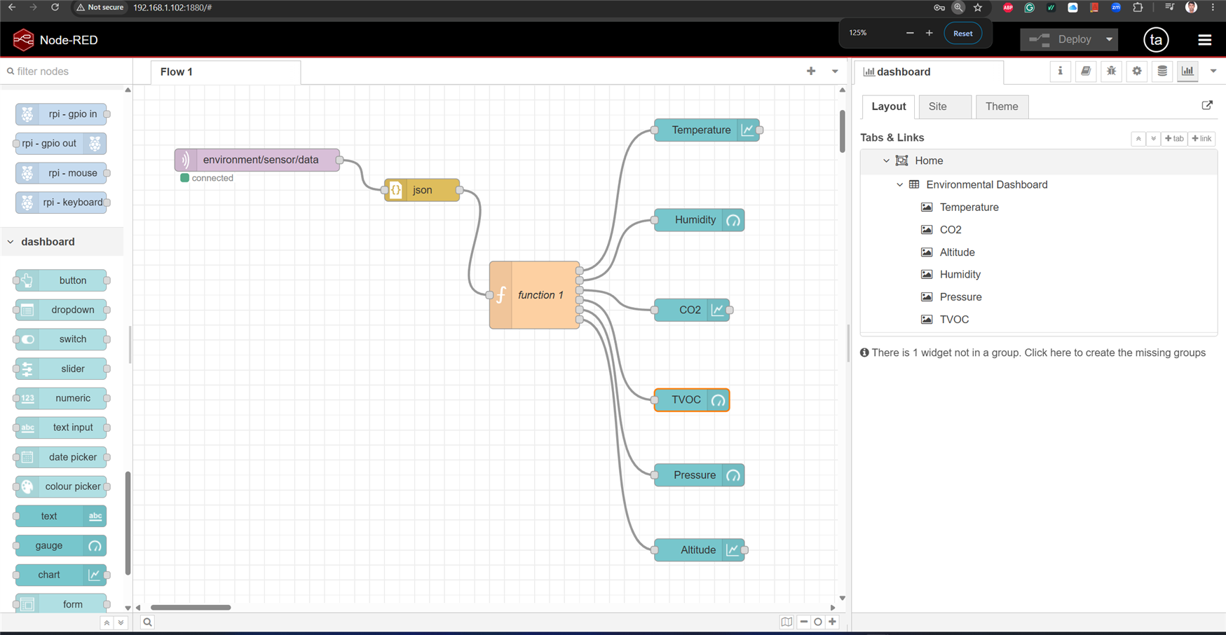

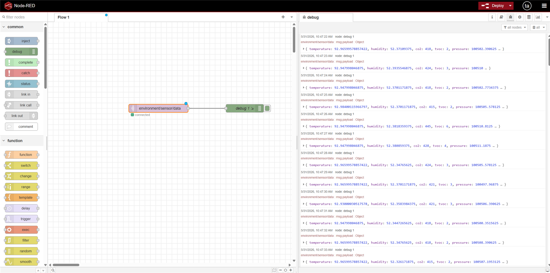

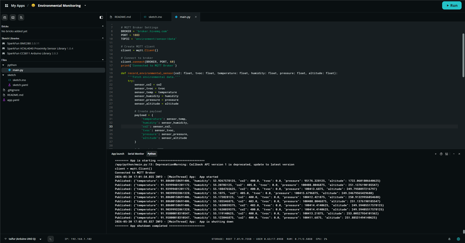

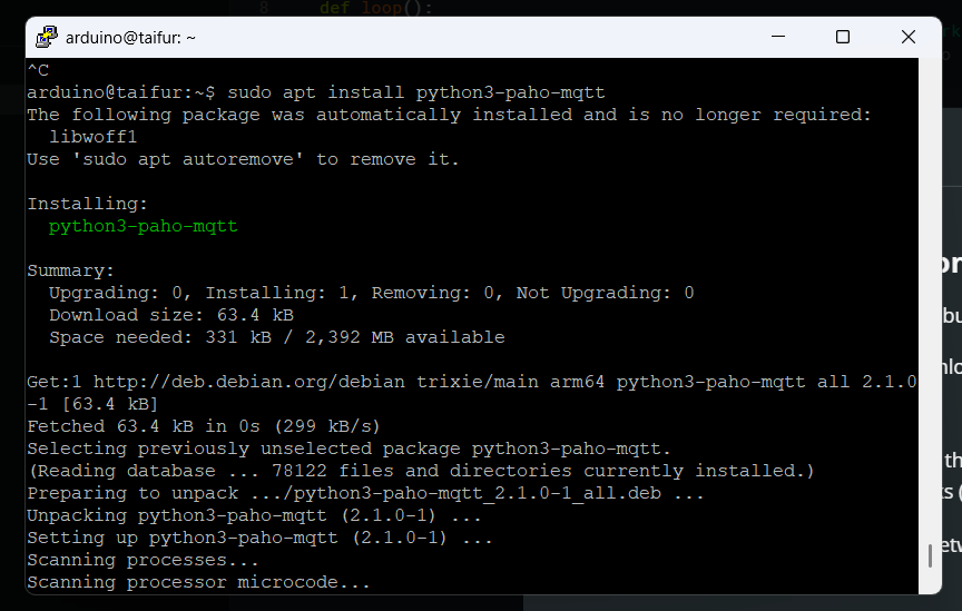

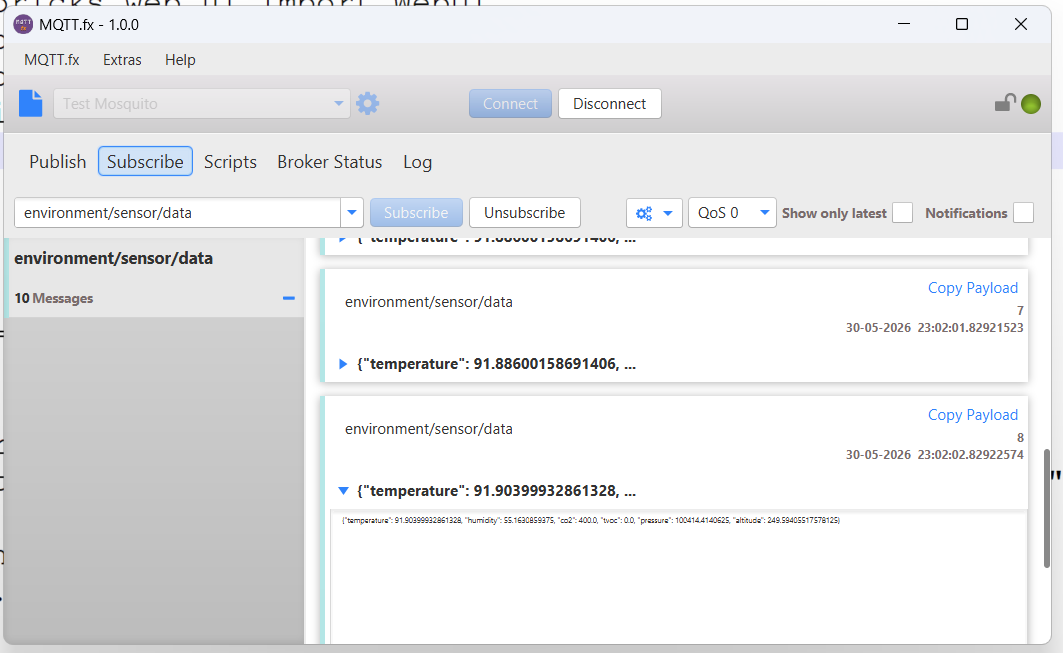

Sending data to MQTT Broker
I used the bridge library to send the sensor data to the MPU. On the MPU side, I used a Python script to process the sensor data and send it to an MQTT broker. I looked for the MQTT Brick but did not find any Brick for MQTT, so I decided to use the paho-mqtt package for writing the Python code and sending the data over MQTT. The paho-mqtt client is not preinstalled in Arduino UNO Q. So, connected the UNO Q in network mode, open SSH, and use the following command to install the client:
sudo apt install python3-paho-mqtt
The paho-mqtt client was successfully installed without any issues. Then I wrote the following Python script to receive data from the MCU and send it to an MQTT Broker.
import time
import paho.mqtt.client as mqtt
from arduino.app_utils import *
import json
# MQTT Broker Settings
BROKER = "broker.hivemq.com"
PORT = 1883
TOPIC = "environment/sensor/data"
# Create MQTT client
client = mqtt.Client()
# Connect to broker
client.connect(BROKER, PORT, 60)
print("Connected to MQTT Broker")
def record_environmental_sensor(co2: float, tvoc: float, temperature: float, humidity: float, pressure: float, altitude: float):
    """Fetch environmental data."""
    try:
        sensor_co2 = co2
        sensor_tvoc = tvoc
        sensor_temp = temperature
        sensor_humidity = humidity
        sensor_pressure = pressure
        sensor_altitude = altitude
        # Create payload
        payload = {
            "temperature": sensor_temp,
            "humidity": sensor_humidity,
            "co2": sensor_co2,
            "tvoc": sensor_tvoc,
            "pressure": sensor_pressure,
            "altitude": sensor_altitude
        # Convert to JSON
        message = json.dumps(payload)
        # Publish data
        client.publish(TOPIC, message)
        print(f"Published: {message}")
    except Exception as e:
        #logger.exception(f"sensor data receive: Error: {e}")
        print(f"sensor data receive: Error: {e}")
# Allow the microcontroller to call the "get_air_quality" function
Bridge.provide("record_environmental_sensor", record_environmental_sensor)
#logger.info("Starting App...")
# See: https://docs.arduino.cc/software/app-lab/tutorials/getting-started/#app-run
App.run()
The MQTT client was successfully connected and was publishing data to the MQTT broker on a specific topic for every sensor data received from the MCU.
I used MQTT.fx to check whether the data has reached to the broker or not. I subscribed to that specific topic and successfully received the data.

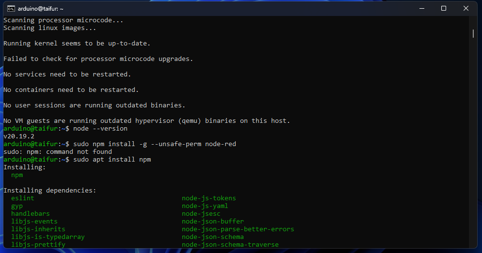

Installing Node-RED

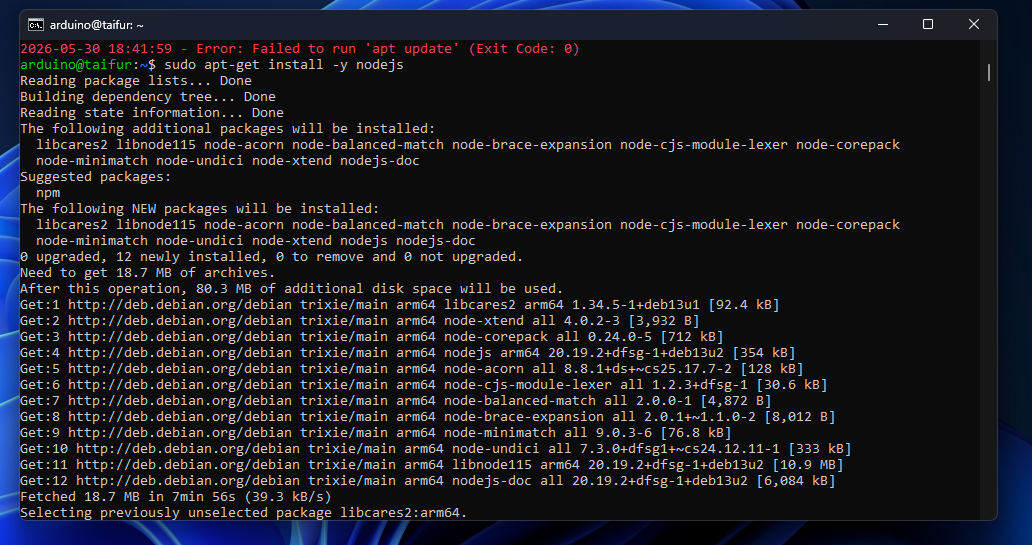

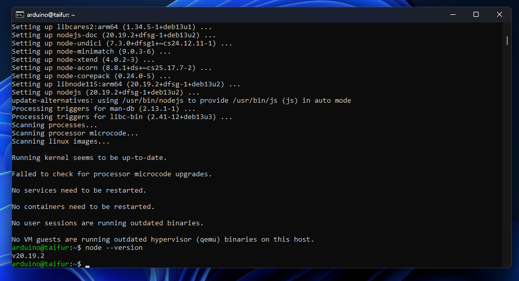

For installing Node-RED, I installed Node.js successfully on the Arduino UNO Q board using the command:
sudo apt-get install -y nodejs
 . Node.js v20 was installed automatically.
For installing any node package, I need npm. So, I installed npm as it is not already installed.
Then I tried to install Node-RED using the npm command, and I got the following error messages. I tried multiple times but got the same result. I tried to find a tutorial on installing Node-RED on an Arduino Uno Q, but did not find one. I tried to solve the issues in different ways I found on the internet, but the problem has not been solved yet.
Next day..............

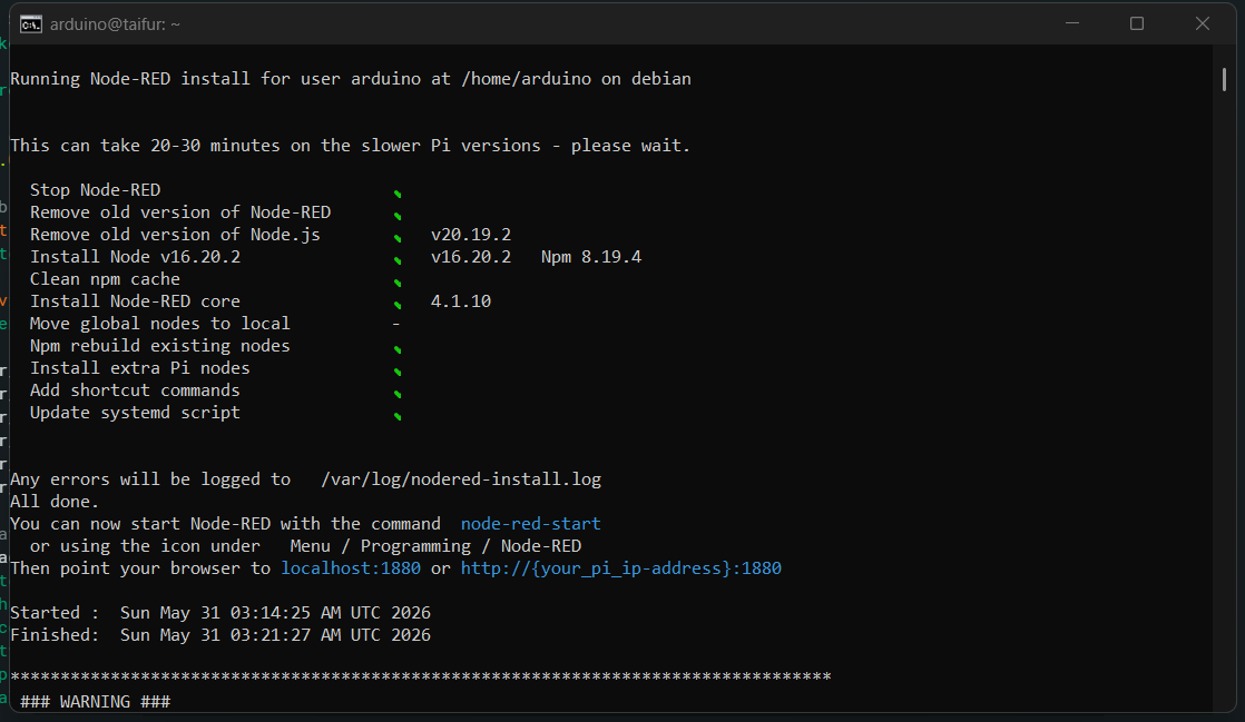

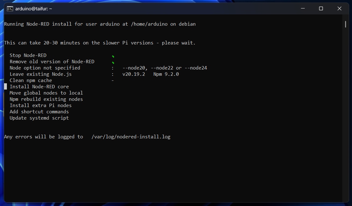

I did some research on the internet, and I started to install Node-RED again with a fresh mind on my Arduino UNO Q board. I browsed the official Node-RED page and accessed the option to install Node-RED on Debian-based OS like Raspberry Pi. I entered the following command on the board shell:
bash <(curl -sL https://github.com/node-red/linux-installers/releases/latest/download/update-nodejs-and-nodered-deb)
Everything went fine without installing the Node-Red core:
I entered the following command and tried again:
sudo apt install build-essential git curl
Still got the same result. Then I tried to install it with a specific version of Node with the following command:
bash <(curl -sL https://raw.githubusercontent.com/node-red/linux-installers/master/deb/update-nodejs-and-nodered) --node16
I was fortunate, and this time everything was installed successfully.

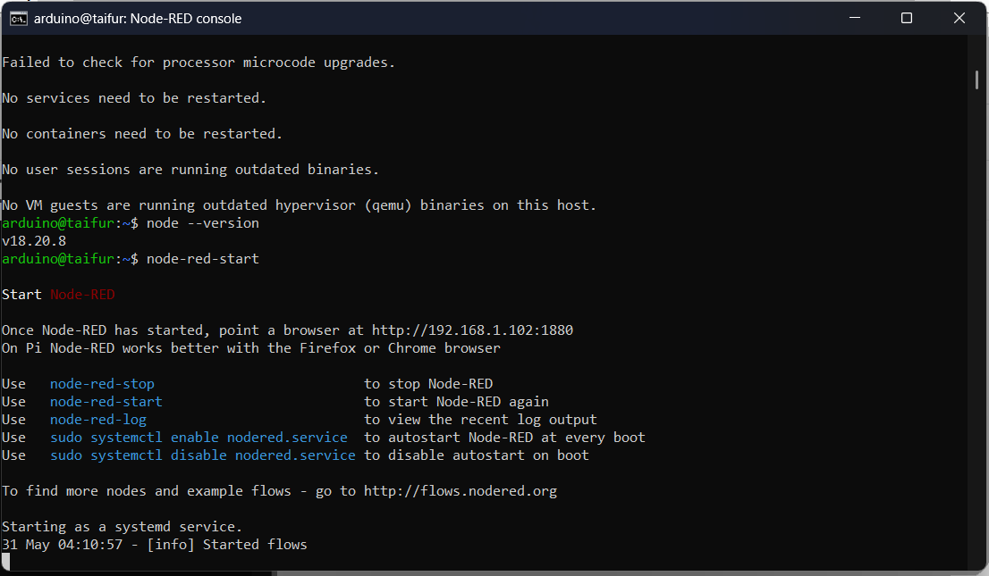

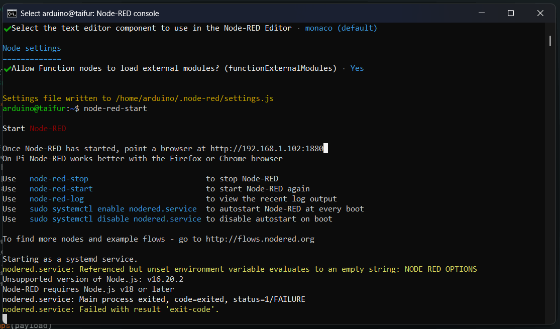

I started Node-RED using the following command:
node-red-start
I got the error message that to run Node-RED, I need to update Node.js version 18 or later, but I have v16. No, it is time to update the Node.js version again. To install Node.js version 18, I entered the following command in the shell:
curl -fsSL https://deb.nodesource.com/setup_18.x | sudo -E bash -
Then I enter the command:
sudo apt install -y nodejs
Node version 18 was installed successfully.

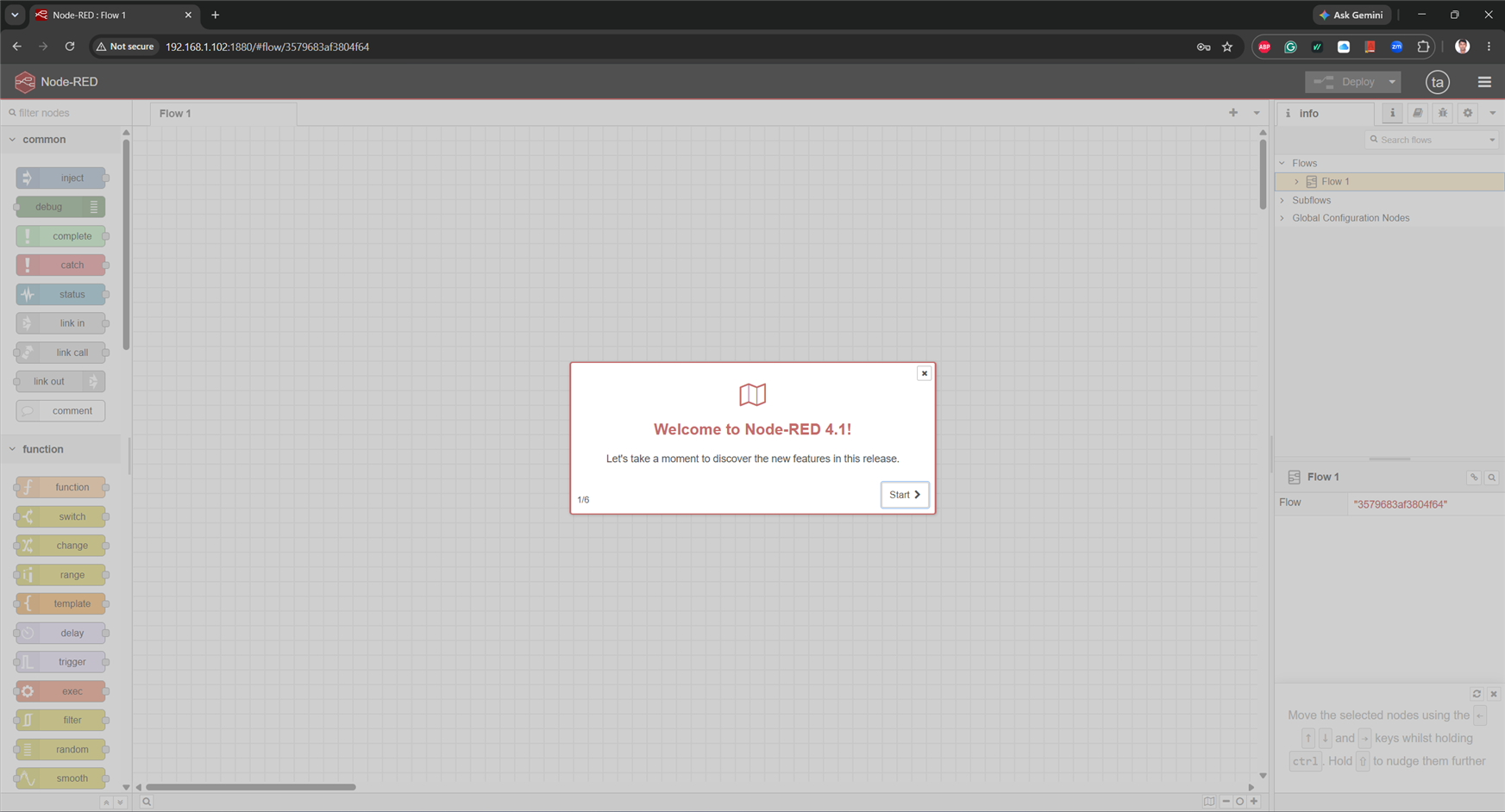

After updating Node.js, I tried to run Node-RED again, and this time it ran successfully.
And Node-RED was loaded successfully.
Making a Node-RED Project
After installing Node-RED successfully, I want to make a simple flow to receive the MQTT message from the Arduino UNO Q and print the message in the debug console. The message was received and displayed successfully, as shown in the screenshot below.
Then I made a dashboard to show all the environmental data received from the Arduino UNO Q to the MQTT Broker. Following is the node flow design for my dashboard project. The MQTT message contains JSON data, and the JSON string was separated using a simple function node. The function node contains the following code:
