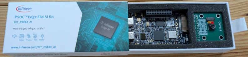

Unboxing
The kit includes the PSOCTm Edge E84 AI board and a 0.3 MP USB camera module with a USB-C cable. The packaging also provides a QR code that gives direct access to the official documentation and software resources.

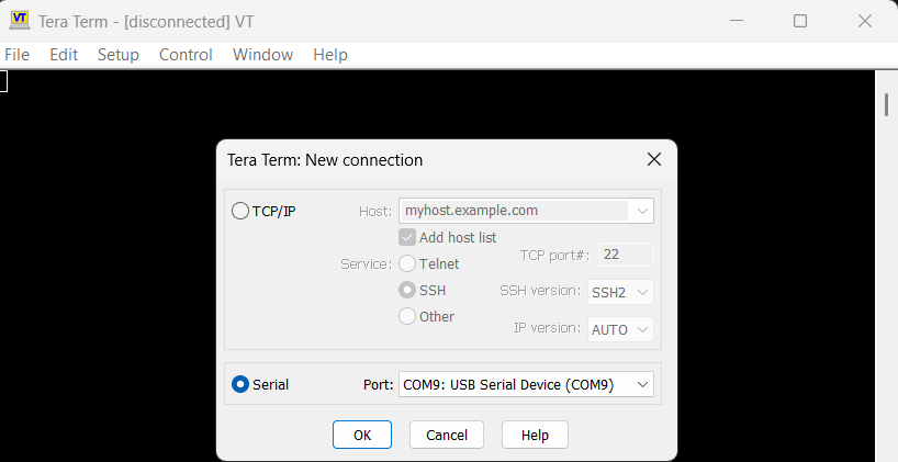

Following the Quick Start Guide, Tera Term was configured to use the KitProg3 USB-UART COM port with the recommended settings (115200 baud, 8 data bits, no parity, 1 stop bit).
After pressing the reset button (SW2), the board displayed the boot menu, providing access to the available demonstration applications.

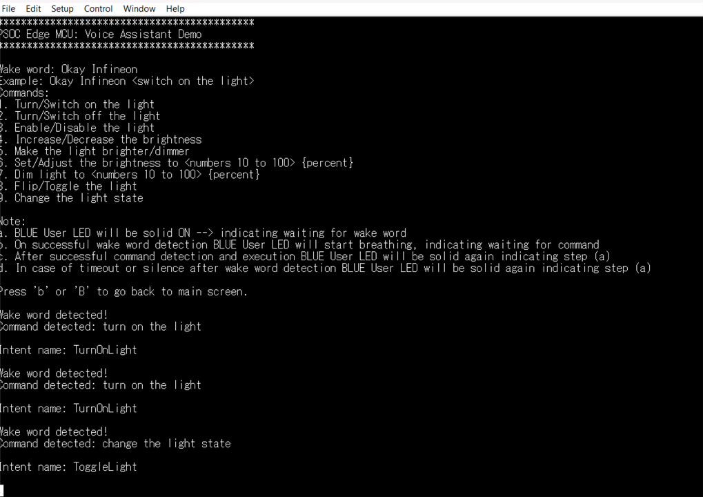

The first demonstration tested was the Voice Assistant application. The onboard microphones successfully detected the wake word "Okay Infineon" and correctly executed several voice commands.
During testing, commands such as "turn on the light" and "change the light state" were recognized and executed correctly. The serial terminal displayed both the detected command and the associated intent, making it easy to verify the system's operation.
The response time was fast and the recognition accuracy was good under normal office conditions.

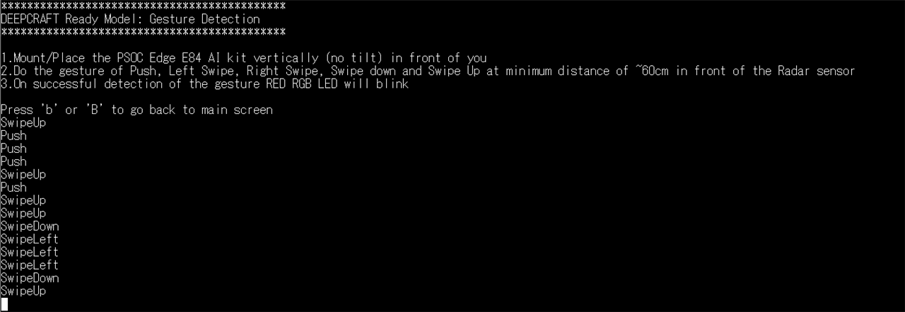

The second demonstration evaluated the onboard XENSIVTm 60 GHz radar sensor. The system successfully detected multiple gestures including Push, Swipe Left, Swipe Right, Swipe Up and Swipe Down.
Gesture recognition was displayed in real time through the UART terminal and proved to be responsive and reliable during testing.

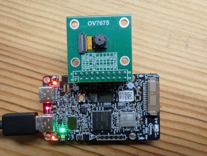

The PSOCTm Edge E84 AI Kit was positioned vertically on a desk as recommended by the demonstration software. The factory-installed Gesture Detection demo was used without modification.
Figure 1. Test setup used for radar gesture evaluation.
Figure 2. Push gesture performed during radar detection testing.
One unexpected observation was that gesture recognition was noticeably more reliable when the hand remained fully open. This suggests that the radar classification model may be sensitive to the shape and radar cross-section of the detected object.

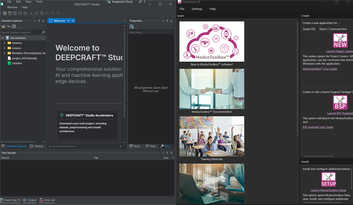

After installing ModusToolboxTm, I proceeded to create my first project for the PSOCTm Edge E84 AI Kit.
The board support package (BSP) was not installed by default and had to be downloaded during the project creation process. The procedure itself was straightforward, but it required downloading additional software components, middleware, and supporting packages.
As a first-time user of the Infineon ecosystem, I found myself following the guided setup process without always fully understanding the purpose of every component being installed. Fortunately, the development environment handled most of the configuration automatically.
The project creation process completed successfully without errors, although it took noticeably longer than the initial installation due to the automatic download and configuration of required dependencies.

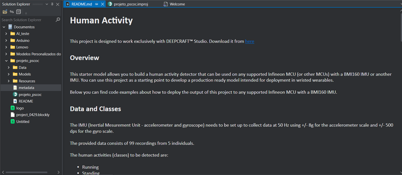

After installing DEEPCRAFTTm Studio, I explored the available AI templates and project accelerators.
The first impression was very positive. The interface is clean, modern, and organised around practical Edge AI applications rather than low-level machine learning concepts.
A wide range of ready-to-use projects is available, including IMU-based activity recognition, microphone processing, vibration analysis, object detection, and anomaly detection.
For this initial evaluation, I selected the Movement Type Detection example, which uses IMU sensor data to classify different types of motion.
From an educational perspective, DEEPCRAFTTm Studio appears significantly easier to approach than traditional AI frameworks such as TensorFlow. Students can focus on understanding AI concepts without being overwhelmed by software complexity.
One particularly interesting aspect is that AI workflows are presented as guided projects, reducing the barrier to entry for newcomers.
 DEEPCRAFTTm Studio provides ready-to-use AI project templates, reducing the barrier to entry for students and educators exploring Edge AI applications.
