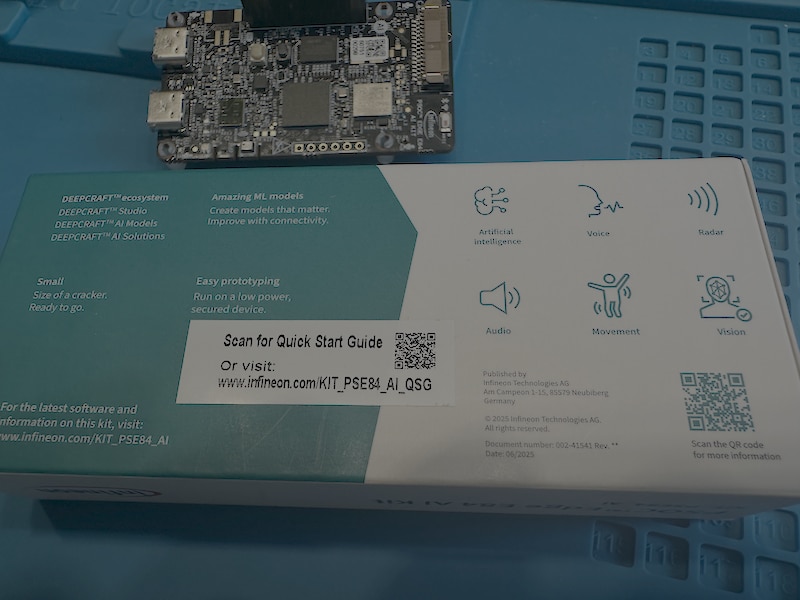

2. Unboxing
The kit arrives in a compact, high-quality retail box — Infineon's "How will you bring AI to life?" packaging, small enough to sit in your palm. Inside, the board and the camera module are each held in cut black foam, together inside an antistatic bag — well protected for shipping.
The two items in the box match the quick-start guide's contents list: the PSOCTm Edge E84 AI board and a 0.3 MP camera module.
The box itself doubles as an orientation to the platform. Its back panel lays out the DEEPCRAFTTm ecosystem and the kit's six target use cases — artificial intelligence, voice, radar, audio, movement, and vision — and carries a QR code straight to the quick-start guide.
Figure 1— Kit contents
The board and the OV7675 camera module in the foam tray.
Figure — Box panel
The capability icons and QSG QR code on the box.

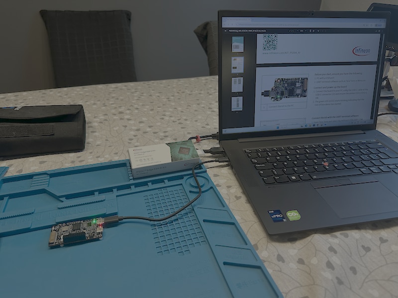

3. First power-up
Following the quick-start guide, I connected the board to the PC with the USB-C cable at connector J1. The amber power LED (LED5) came on, and the green LED (LED1) began blinking — the sign that the pre-loaded out-of-box demo is running. The board was live within seconds of plugging in.
Figure — Powered board
The board powered over USB-C with its LEDs lit.

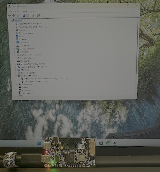

On my Windows 11 laptop the board was recognised immediately — no driver hunting. It enumerated as KitProg3 USB-UART (COM5) under Ports (COM & LPT) in Device Manager.

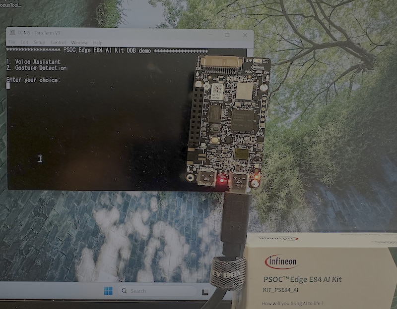

I then opened Tera Term on COM5 (the KitProg3 USB-UART bridge), and after reset the board presented the OOB demo menu:
*************** PSOC Edge E84 AI Kit OOB demo ***************
1. Voice Assistant
2. Gesture Detection
Enter your choice:
Selecting an option launches the matching demo.
Figure — Device Manager
The board shown as KitProg3 USB-UART (COM5)
 Figure — Boot menu
The OOB demo menu in Tera Term.

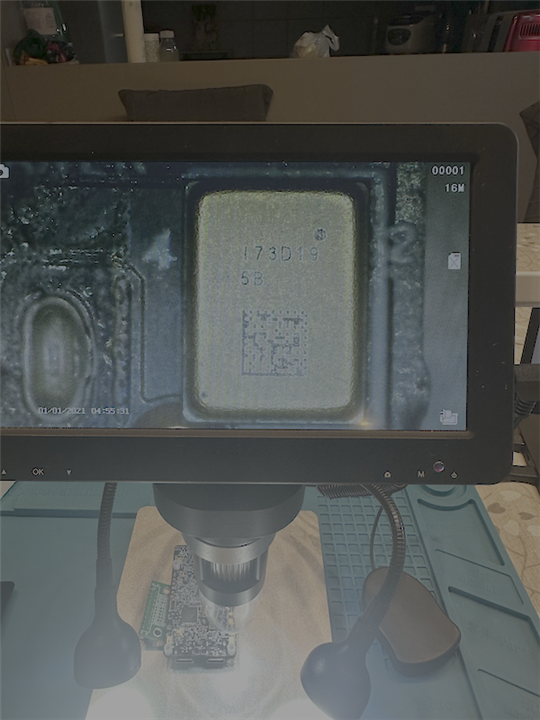

I went over the board under a USB microscope, read the markings off the major chips, and cross-checked each against Infineon's published kit documentation. Every part below is confirmed two ways: I could read it on the silicon, and it matches the kit's official feature list (and the BSP description in the tooling).
The application processor — the PSOCTm Edge E84 itself
The headline part, in the centre of the board, is marked PSE846GPS2DBZC4A — the PSOCTm Edge E84 MCU. It pairs an Arm Cortex-M55 (with Helium DSP) and an Ethos-U55 NPU in a high-performance domain with a low-power Cortex-M33 (with Infineon's NNLite accelerator) for always-on work, plus a 2.5D GPU for the display path. Everything else on the board exists to feed this chip.

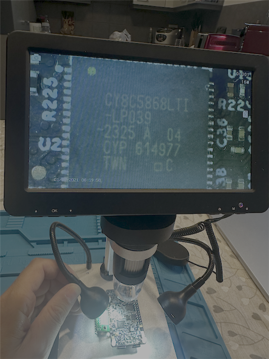

The chip under the QR label — KitProg3
Under a small QR/serial label sat CY8C5868LTI-LP039, a Cypress/Infineon PSoC 5LP. On this board it's the KitProg3 — the onboard programmer/debugger and USB-UART (and USB-I2C) bridge: the chip behind the "one USB-C cable does everything" experience, and the same KitProg3 that showed up on COM5 in Section 4. Date code 2325 (week 23, 2025), Taiwan.
Figure — PSoC 5LP under the label
 CY8C5868LTI-LP039, found beneath a QR label.

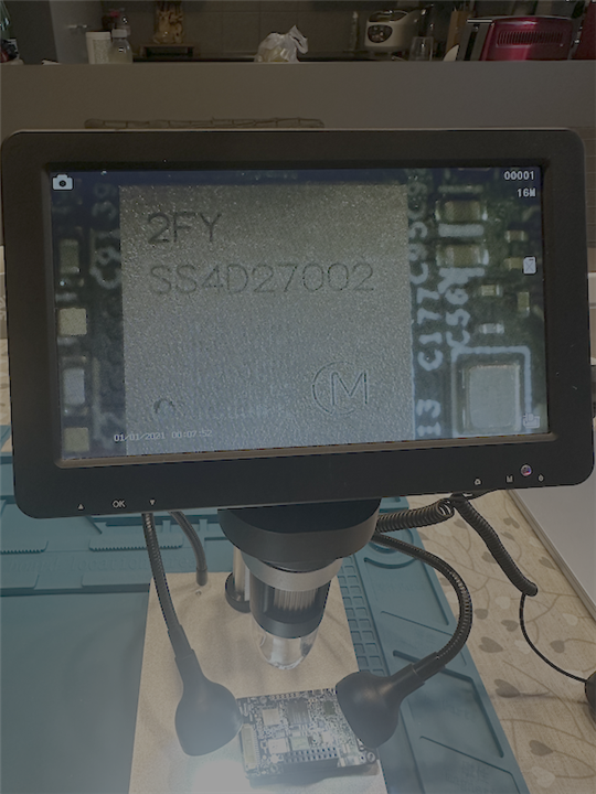

Wireless — Murata Type 2FY (AIROCTm CYW55513)
The module by the antenna carries the Murata logo and a 2FY mark (internal marking SS4D27002). That 2FY identifies it as the Murata Type 2FY (LBEE5HY2FY) module, which carries Infineon's AIROCTm CYW55513 Wi-Fi + Bluetooth (BLE 5.4) combo. Both radios come from this one module at the board edge, fed by the printed antenna.
Figure — Wireless module
Murata Type 2FY, next to the PCB antenna.

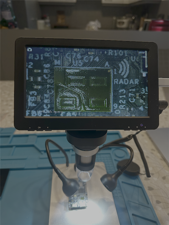

Radar — XENSIVTm BGT60TR13C at U5
The radar is at U5, under the RADAR silkscreen, with an antenna icon and the antennas etched into the PCB beside it. The package marking itself was too small to read, but the kit documentation lists the radar as the XENSIVTm 60 GHz BGT60TR13C, so that's the part at U5, antennas built into the board. (The gesture demo in Section 8 confirms it's populated and working.)
Figure — Radar at U5
The RADAR silkscreen, antenna icon, and the package at U5.

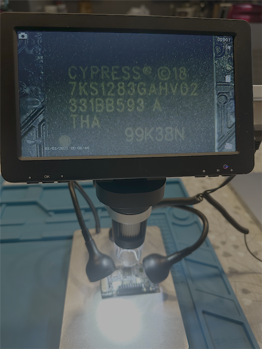

Memory — 512-Mbit NOR flash + 128-Mbit HyperRAM
S25HS512T (Cypress/Infineon SemperTm) — the 512-Mbit Quad-SPI NOR flash for code and data.
7KS1283GAHV02 (Cypress/Infineon, S27KS family) — the 128-Mbit Octal HyperRAMTm (PSRAM), the fast external working memory the processor and graphics path draw on.
Figure — FlashRAM
S25HS512T
Figure — HyperRAM
7KS1283GAHV02.

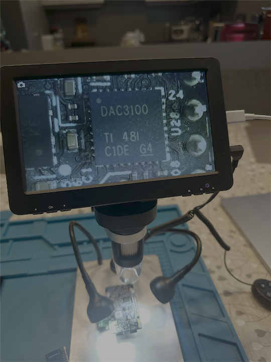

Audio — TI TLV320DAC3100
DAC3100 with the TI mark — the Texas Instruments TLV320DAC3100, a stereo audio DAC with integrated headphone/speaker amplifier: the output side of the board's audio path
Figure — Audio DAC
DAC3100 (TI).

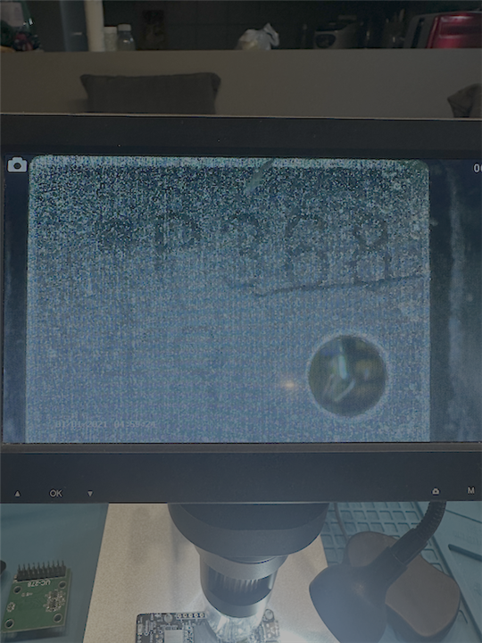

Environmental sensor — XENSIVTm DPS368
A small sensor carrying the marking DPS368
Figure — DPS368
The barometric pressure sensor, DPS368

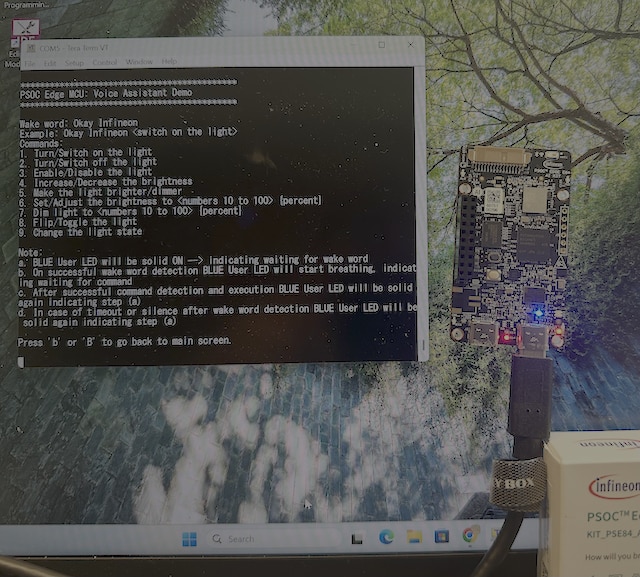

7. Factory demo — voice assistant

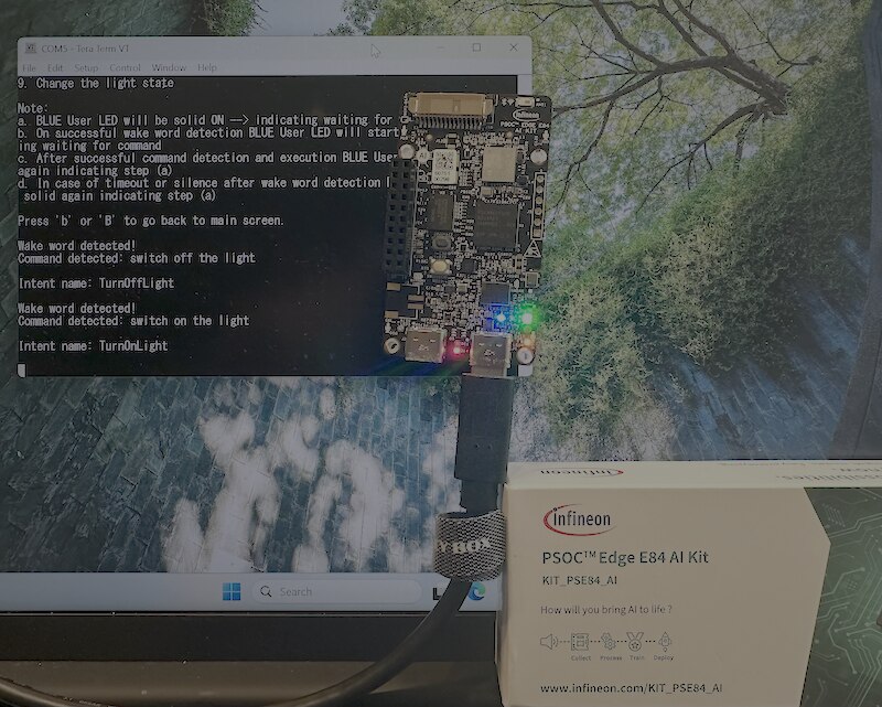

From the boot menu I selected the Voice Assistant. The demo announces itself as "PSOC Edge MCU: Voice Assistant Demo," with the wake word "Okay Infineon" and a fixed command set aimed at controlling a light — on/off, enable/disable, brighter/dimmer, set brightness to a percentage, toggle, and change state. The blue user LED tracks the interaction: solid while waiting for the wake word, then breathing once the wake word is caught and it's listening for a command, and solid again after the command runs.
In use, the demo caught the wake word and resolved each spoken command to a named intent, printed live in the terminal. For example, "switch on the light" resolved to TurnOnLight, "switch off the light" to TurnOffLight, and "change the light state" to ToggleLight — each shown as a "Wake word detected! / Command detected / Intent name" block as I spoke. The voice path exercises the board's onboard PDM microphones identified in the teardown.
Figure — Voice assistant demo
 The command list and wake-word prompt.
Figure — Commands recognized
The terminal showing detected commands and their intents, with the user LED lit.

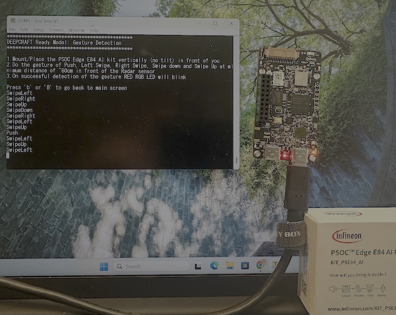

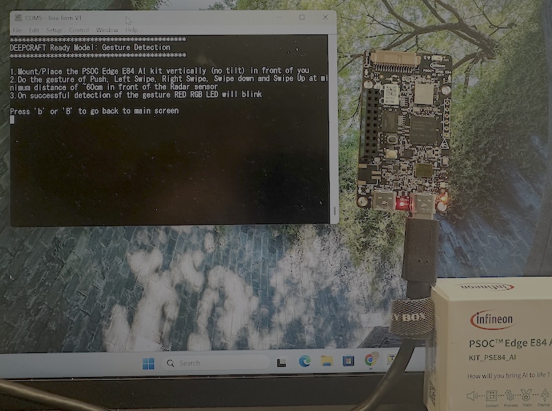

8. Factory demo — radar gesture detection
The second demo is gesture detection, which the terminal identifies as a DEEPCRAFT Ready Model. Its on-screen instructions are to stand the board vertically (no tilt) and perform Push, Swipe Left, Swipe Right, Swipe Up, or Swipe Down at roughly 60 cm in front of the radar, with the RGB LED blinking red on a successful detection.
Running it, the board recognized the push and all four swipe directions, printing each one to the terminal as I performed it — a continuous stream of SwipeLeft, SwipeRight, SwipeUp, SwipeDown, and Push lines. Because the sensing is done by the radar at U6, the demo runs with nothing else attached, which also confirms the radar is populated and working on the board.
Figure — Gesture demo instructions
The DEEPCRAFT Ready Model gesture screen.
Figure — Gestures recognized
The terminal log of detected gestures.

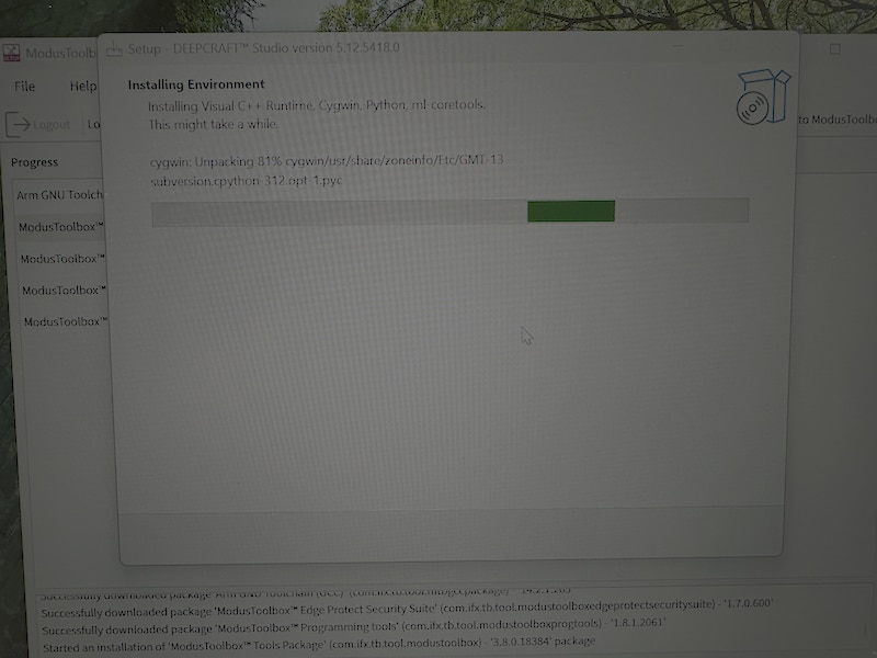

9. Edge AI tooling
Infineon's development flow uses two pieces: ModusToolboxTm (the embedded toolchain and Eclipse-based IDE) and DEEPCRAFTTm Studio (the Edge AI / ML model tooling). Both are installed through the Infineon Developer Center, and the one prerequisite is a free myInfineon account — I had to register before the downloads would start. I chose the standard installation.
The install. ModusToolbox is installed via its setup tool (ModusToolbox Setup 1.4), which pulls the standard package set automatically:
  • ModusToolbox Tools Package 3.8.0
  • Arm GNU Toolchain (GCC) 14.2.1
  • ModusToolbox Edge Protect Security Suite 1.7.0
  • ModusToolbox Programming tools 1.8.1
  • ModusToolbox CAPSENSETm and Multi-Sense Pack 1.5.0
DEEPCRAFT Studio (version 5.12) installs alongside and sets up its own environment — Visual C++ Runtime, Cygwin, Python, and ml-coretools — which is the slower part of the process (the installer warns it "might take a while").

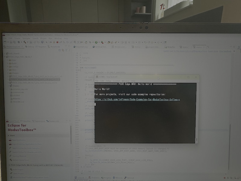

10. First project: building and running an example
To check the full development loop — not just installing the tools but getting something onto the board — I created and ran the Hello World example.
Starting Project Creator in Eclipse for ModusToolbox, the connected board was auto-detected (listed under "Detected Devices" as KIT_PSE84_AI), so I didn't have to choose the BSP manually. From New Application → Getting Started I selected PSOC Edge Hello World, a simple example that prints a "Hello world" message over UART and blinks a user LED from the Cortex-M33.
One thing this example makes clear is the architecture of a PSOC Edge E84 application. Each app has a dual-CPU, three-project structure: a CM33 secure project (SPE), a CM33 non-secure project (NSPE), and a CM55 project. At reset a secure boot flow runs from ROM with the device's secure enclave as the root of trust, hands off to the secure CM33, then to the non-secure CM33 — which initialises clocks, pins, and the retarget-io UART — which in turn enables the CM55. The debug UART reaches the PC through the KitProg3 virtual COM port, and User LED1 blinks once a second.
I built the project (toolchain validation passed, GCC_ARM), programmed it to the board over KitProg3, and opened Tera Term on COM5. The terminal showed the expected output:
*************** PSOC Edge MCU: Hello world ***************
Hello World!
For more projects, visit our code examples repositories:
https://github.com/Infineon/Code-Examples-for-ModusToolbox-Software
So the complete flow — install → auto-detected BSP → create project → build → flash → verify on the terminal — works end to end. The DEEPCRAFT machine-learning examples (Section 10) are the natural next step from here.
Figures — Hello World
The auto-detected BSP; the Hello World template selected; the example open in the editor; and the "Hello World!" output in Tera Term.

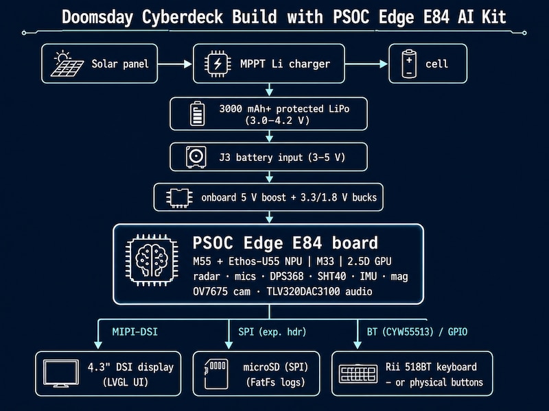

The plan adds four things to the board — a 4.3-inch MIPI-DSI display, an OPEN-SMART SPI microSD card, a Rii 518BT Bluetooth keyboard (with physical buttons as the robust fallback), and a 3000 mAh+ protected LiPo with solar charging — so the device boots from its own battery, recharges from the sun, shows its own dashboard, keeps its own logs, and runs its AI with no PC, no mains, and no network.
PSoCTm Edge E84 AI Kit RoadTest — Part 2
The Doomsday Cyberdeck: a self-contained, solar-powered, off-grid Edge AI node
What this part is. A build plan, not a finished build. Everything below is design intent and the open questions I still have to settle on the bench — nothing here is reported as a tested result. Part 1 covered the kit as it ships (teardown, factory demos, toolchain, a first project). This part takes the same board off-grid.
1. The idea
The premise is simple: take the PSOCTm Edge E84 AI Kit and turn it into a device that needs nothing else — no PC, no wall power, no network. A single board that boots from its own battery, recharges from the sun, shows what it's doing on its own screen, takes input from its own keys, keeps its data on its own card, and runs its AI entirely on-device. A self-contained edge-AI node you could set down anywhere and leave running.
This is what I'm calling the doomsday cyberdeck — "doomsday" in the sense of fully self-reliant and air-gapped, not as a gimmick. The design target is an instrument that keeps sensing, deciding, and logging when there is no cloud, no Wi-Fi, and no mains.
The E84 is a surprisingly good fit for this:
  • The Cortex-M55 + Ethos-U55 NPU runs neural models locally — the whole point of an offline node. The low-power Cortex-M33 can stay awake for always-on duties while the heavy compute sleeps.
  • The board already carries a rich sensor suite (identified in Part 1's teardown): a 60 GHz radar, PDM microphones, a DPS368 pressure/temperature sensor, an SHT40 humidity sensor, a BMI270 IMU, a BMM350 magnetometer, and the OV7675 camera. That's most of an environmental + presence + vision sensing stack already on the board.
  • It's low power and runs from 1.8 V / 3.3 V rails off a single Li cell (via the onboard boost/bucks), which is exactly what a solar-fed device needs.
2. System overview
The board is the brain and the sensor array; the four added parts give it a face (display), a memory (microSD), hands (keyboard/buttons), and a heart that never needs the wall (solar + battery).
3. Bill of materials
# Part Role Interface to the board
— PSOCTm Edge E84 AI Kit Compute + sensing core —
1 4.3-inch MIPI-DSI display On-device screen / UI MIPI-DSI connector (R-Pi-compatible)
2 OPEN-SMART microSD breakout Local mass storage SPI on the expansion I/O header
3 Rii 518BT Bluetooth keyboard Input / navigation Bluetooth (CYW55513)
4 3000 mAh+ protected LiPo + solar panel + Li solar charger Off-grid power Cell → J3 (3–5 V); solar → charger → cell

7. The heart — 3000 mAh+ protected LiPo + solar
The voltage works out nicely. The board has a battery input — connector J3, rated 3–5 V — that takes a single lithium cell directly, and the board makes its own 5 V / 3.3 V / 1.8 V rails from that input via the onboard boost and bucks. A LiPo at 3.0–4.2 V sits right in range, so no separate boost-to-5 V module is needed. The one catch (from Part 1): J3 is an unpopulated rework header, so a JST connector has to be soldered to it first.
The cell. A 3000 mAh+ protected LiPo — protected meaning an over-/under-voltage and over-current PCB on the pack (essential for an unattended, solar-charged device).
Solar. A small panel (e.g., 6 V, ~2–5 W) feeds a Li-ion solar charge controller — an MPPT-class charger such as a CN3791 or CN3065 is a better match for a solar source than a plain TP4056, because it holds the panel near its maximum-power point. The controller does CC/CV charging to 4.2 V; the protected cell is the safety backstop. Charging-while-running needs a load-sharing arrangement so the deck can draw from the panel and top up the cell at the same time.
Power budget (estimate — to be measured on the bench):
Subsystem Approx. draw
Board: M55 + NPU + M33, radar, mics ~0.6–0.8 W
4.3" display + backlight ~1.0–1.3 W
microSD writes + Bluetooth link ~0.2 W
Total, screen on + AI + radar active ~2 W (≈0.5–0.7 A at the cell)
Runtime and the solar question. At ~2 W continuous, a 3000 mAh cell gives roughly 4–5 hours before a safe cut-off. But a doomsday node should rarely run flat-out: with the M33 awake for always-on sensing and the M55 + display gated (radar/voice wake the heavy compute only on an event), average draw can fall to a fraction of a watt, stretching the cell to days.
Sustained ("indefinite") operation is then a solar-harvest-vs-load equation, and I'd rather give the math than a promise:
  • A ~2 W panel at ~4 useful sun-hours ≈ 8 Wh/day harvested.
  • A duty-cycled node averaging ~0.3 W ≈ 7.2 Wh/day consumed → net positive, runs indefinitely.
  • The same node held at ~2 W continuous ≈ 48 Wh/day → solar cannot keep up; the battery is just a buffer.
So the design rule is: aggressive duty-cycling + event-driven wake is what makes the solar path actually self-sustaining. Panel wattage and real-world sun hours then size the margin.
Open questions. Mounting the J3 connector; getting the load-sharing path right so it runs while charging; and sizing the panel against the chosen duty cycle and local sun. Thermal is also on the list — M55 + NPU + display under load inside a sealed enclosure needs either headroom or duty-cycling.

  • Offline voice assistant — the DEEPCRAFT voice model (the same family as the Part 1 factory demo): wake word + commands, fully local. Hands-free control with no cloud.

10. Build phases
  1. Display bring-up — LVGL on the 4.3" MIPI-DSI panel; confirm panel compatibility; build the dashboard layout.
  2. Storage — integrate a FatFs-over-SPI SD driver; wire the OPEN-SMART breakout; write/read a log file.
  3. Input —  Rii 518BT BT HID-host.
  4. Power — fit the J3 connector; run from the protected LiPo and measure real current + runtime; add the solar charger and load-sharing; validate charge-while-run.
  5. AI integration — wire the offline voice + radar-presence + environmental logging into the dashboard, event-driven to protect the power budget; add vision on-demand.
  6. Enclosure + field test — print the case, assemble, and run it untethered on solar.
11. Open questions to close on the bench
The concept is settled; these are the real unknowns the build has to resolve, in rough order of risk:
  1. Bluetooth HID host for the Rii 518BT — supported on the CYW55513 stack'
  2. DSI panel compatibility — does the 4.3" panel come up on the PSOC Edge graphics stack, or does it need a custom panel driver?
  3. SD-over-SPI — integrating a FatFs SPI driver cleanly (the examples target onboard flash, not SD).
  4. Power path — J3 rework connector, load-sharing while solar-charging, and panel sizing vs. duty cycle.
  5. Thermal — M55 + NPU + display under load inside the enclosure.
