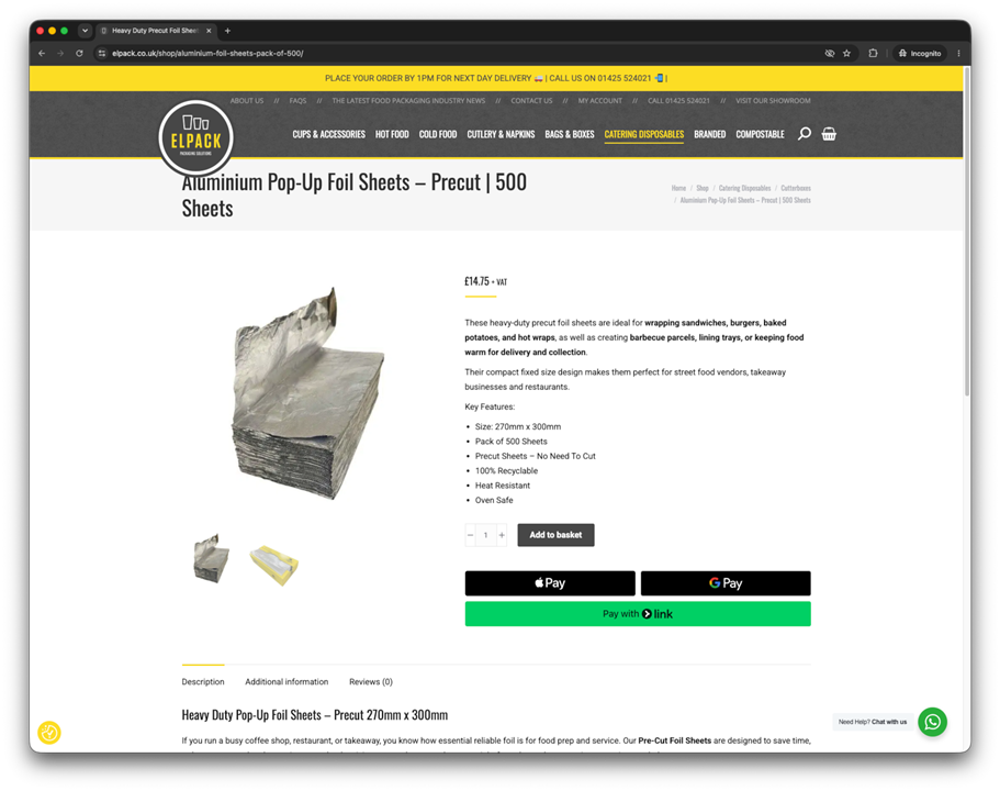

I note that you cannot seem to be able to get the same DevKit on the element14 website anymore, but the same dimentions and texture can be bought from:
