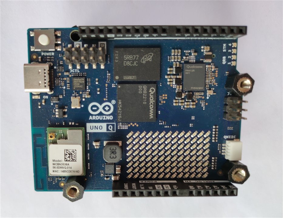

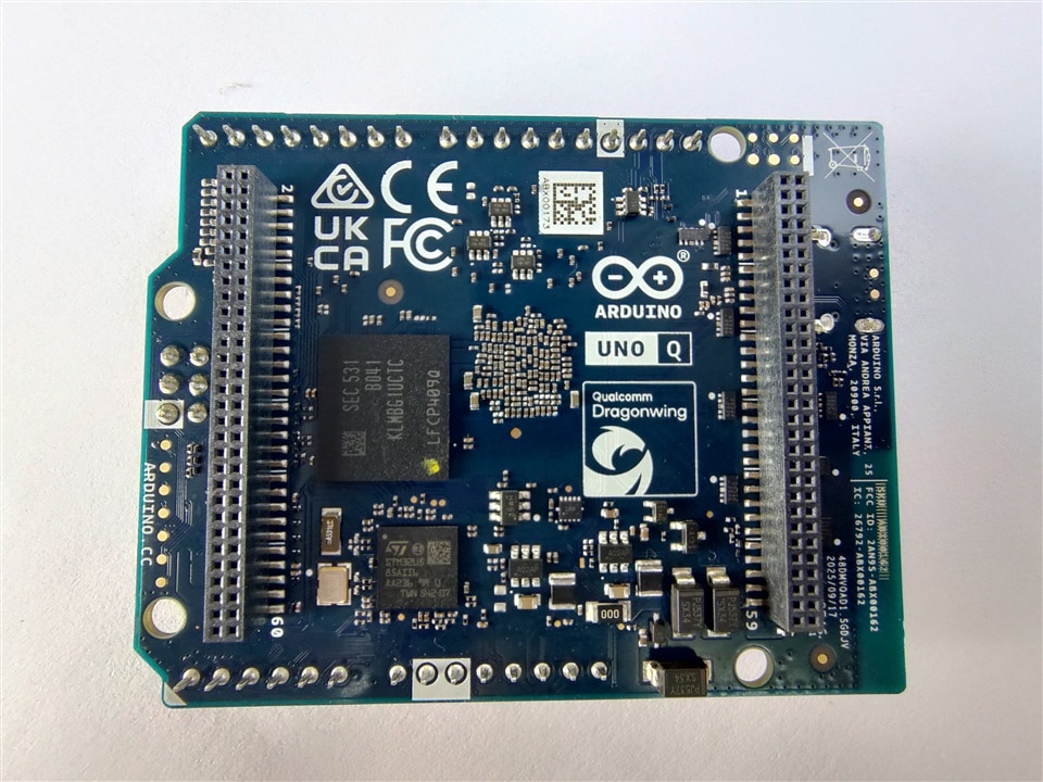

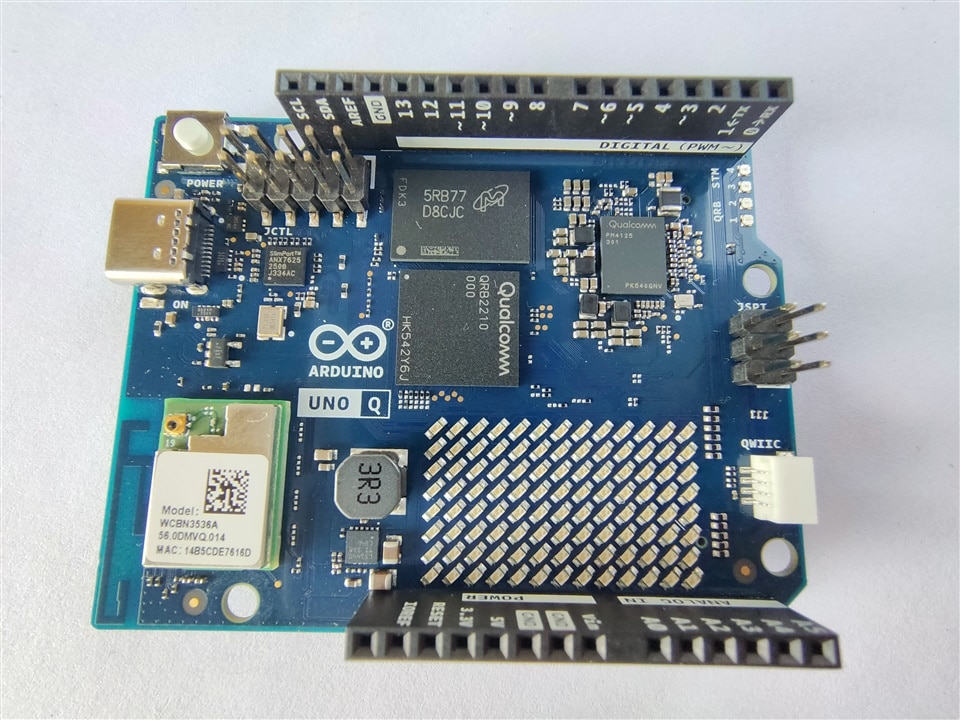

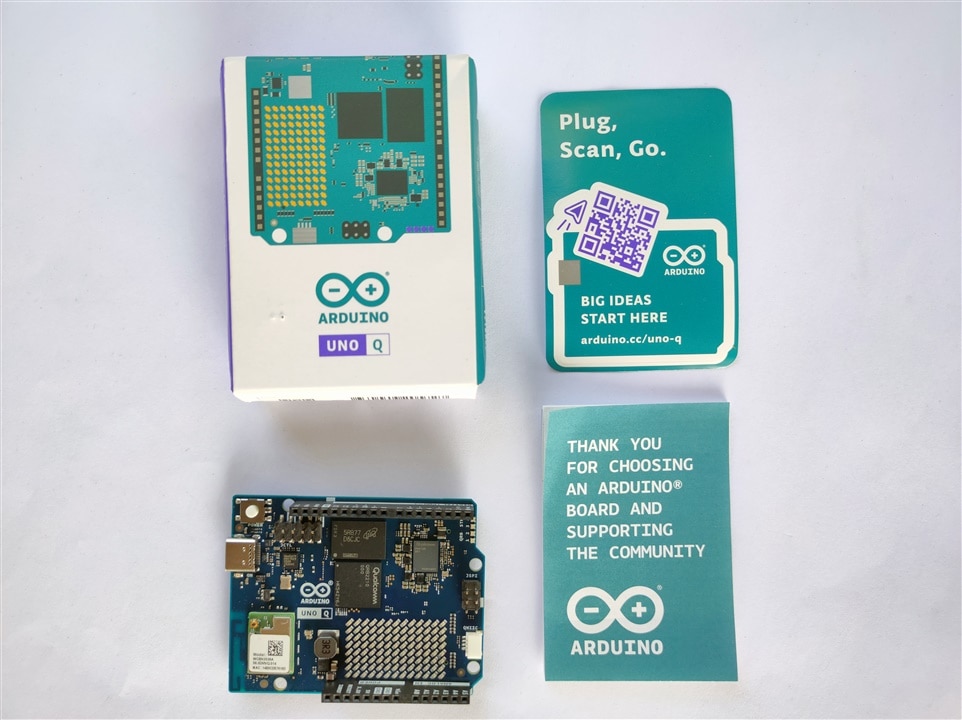

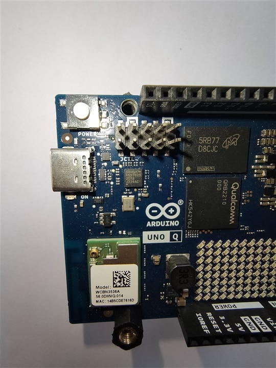

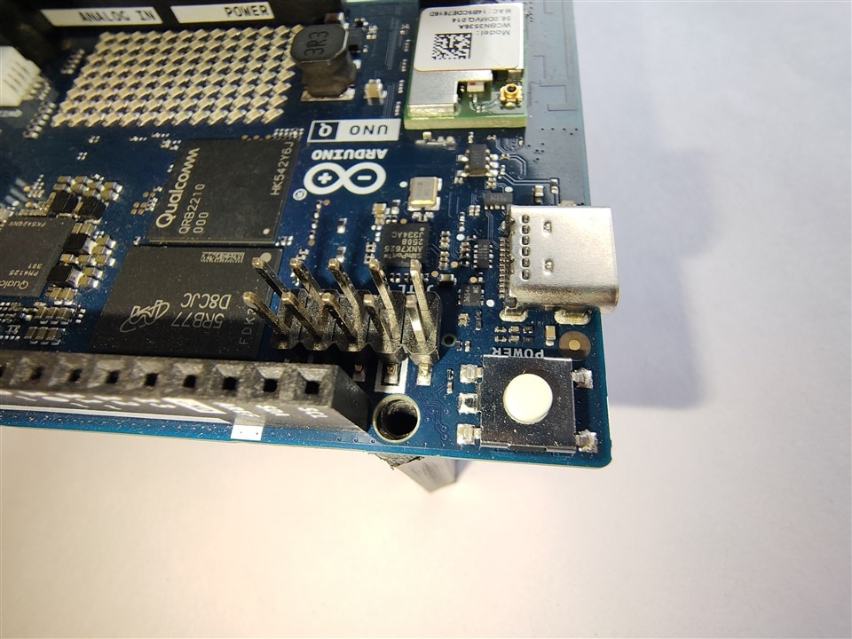

Hardware Overview
{gallery}Overview
Overview
Front
Back

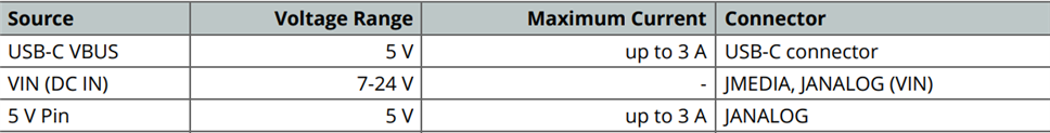

Power Options
The board supports multiple power input methods, including USB-C power and a 7–24V DC input, increasing deployment flexibility in embedded applications.
{gallery}My Gallery Title
Power input options
Input power options
power diagram
Power block diagram
Power Input range
UNO Q supports dual power inputs: a USB-C port and a 7-24V DC input. Over USB Power Delivery, it requests only the 5 V / 3 A contract and does not request higher-voltage PD profiles. Use a supply and cable rated for 5 V at 3 A to avoid undervoltage during short activity peaks such as wireless bursts or display initialization. A regulated external 5 V DC source can also be used to supply power to the board via the 5 V pin on the JANALOG header.
For proper power supply and connectivity, a Multicomp Pro travel adaptor(with three different region pins) (5V/3A, 9V/3A, 12V/2.5A, 15V/2A, 20V/1.5A ; Max 30W), a 240W ERP(Extended Power Range) cable and a TP link USB type C 9-Port hub(also used for SBC mode) was also provided for this roadtest.
{gallery}Power adaptor and cable
Adaptor
Cable
Type C Hub
Through the USB-C VBUS Connector the board communicates via USB Power Delivery (PD) but specifically requests a 5 V / 3 A contract only. It does not request higher-voltage (9 V/12 V/20 V) profiles.
USB-C VBUS and the 5 V output of the 7-24 V buck are diode-OR combined onto the system 5 V bus (5V_SYS). From 5V_SYS, the design derives the 3.8 V pre-regulator node and, subsequently, the 3.3 V. The PMIC, powered by 5V_SYS, derives the 1.8V rail.
The Diode-OR circuit is designed to connect multiple inputs so that if one fails, the other takes over instantly without dropping power to the board. Diode Oring also provides reverse polarity protection as the diode on the lower-voltage source becomes reverse-biased, preventing power from back-feeding into that source.

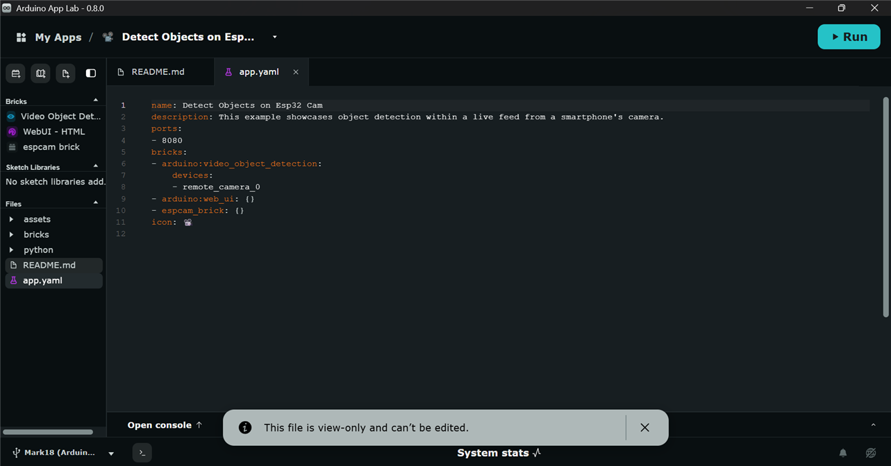

Software Environment
One of the most interesting aspects of the UNO Q platform is App Lab. Traditionally, developers would need to separately write Linux software and microcontroller firmware, then implement a communication layer between them. App Lab abstracts much of this complexity by treating both processors as parts of a single project. Under the hood, communication is handled through the RPC bridge, allowing developers to focus on application logic rather than communication protocols. By condensing 104 LEDs down to just 11 physical lines internally, the board avoids consuming all of its own GPIO header pins.
An App in App Lab is a hybrid composition package that runs across both processors simultaneously. Every App consists of:
1.The Python Side: High-level scripts that execute natively on the Qualcomm MPU's Debian Linux OS. This side handles computer vision, AI model execution, networking, or web interfaces.
2.The Sketch Side: C++ code (.ino) running on a real-time operating system (Zephyr OS) on the STM32 microcontroller. This handles low-latency hardware, PWM, timers, and sensor reading.
3.Orchestration Configuration: An app.yaml file defines the metadata, hardware permissions, and startup configurations of the dual-system application.
{gallery}App Lab
Board Not Detected
Board Detected
App lab also includes some example apps to showcase how the MPU and MCU interact via the internal RPC Router bridge.

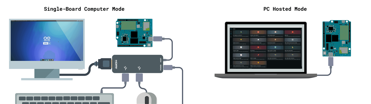

We can connect to app lab via wired (cable) and wireless (network) connections.  For wired connection we connect a single USB-C data cable from the computer directly into the board. The desktop client of Arduino App Lab on the PC auto-detects the board over the serial/virtual network interface. For initial configuration we require a wired connection between computer and arduino uno q.
Once Wi-Fi configurations store successfully on the board, we can entirely sever the USB debugging cord. The board boots up independently using a wall adapter or external battery input. The desktop Arduino App Lab app on the computer uses local network multicast discovery (mDNS) to scan the router space. When found, the board appears in the interface marked with a green "Network" tag.
Some of the latest features of App lab are:
Dual Editors: The IDE features dual side-by-side tabs containing a Python editor and a C++ code editor, removing the need to bounce between Arduino IDE and VS Code.
Built-in Terminal: A button in the lower-left corner instantly spawns a secure remote shell (>_) straight into the Uno Q's Linux environment (arduino@unoq).
System Monitors: The bottom status bar shows real-time resource utilization indicators tracking eMMC Flash storage space, RAM usage, and active CPU loads on the board.
Arduino App CLI: Advanced users can completely bypass the graphical interface and use the terminal command-line tool to manage, start, update, and toggle Apps on the fly.
Run at Startup: A toggle switch in the UI registers your app to launch automatically when the board receives power, allowing you to deploy headless field devices.

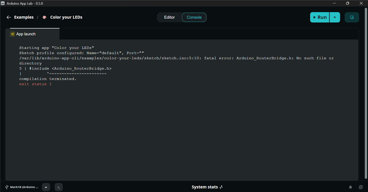

One issue I faced before updating App Lab was that the offline examples threw errors after uploading. However, once I updated both Zephyr packages and App Lab to the latest version, the issue was resolved. The updated App Lab interface was also noticeably improved compared to earlier releases, with a cleaner layout and more accessible logging functionality.

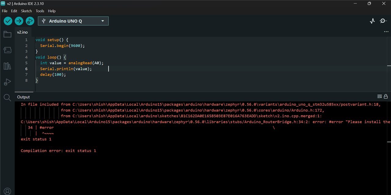

MCU Testing
Usually, from App Labs, we run applications written as Python scripts on the microprocessor, which interact with the microcontroller running the .ino sketch. The microcontroller comes preloaded with firmware that continuously listens for requests from the microprocessor and responds when invoked through the RPC bridge. However, the microcontroller section of the UNO Q can also be programmed independently, just like a standard Arduino Uno. The microcontroller used on the UNO Q is the STM32U585.
To program the microcontroller, we need Arduino IDE version 2.3.6 or later. In the Arduino IDE:
  • Go to: Tools → Board → Boards Manager
  • Search for: "Arduino UNO Q" and install
  • Go to: File → Preferences
  • In "Additional Boards Manager URLs", add: https://github.com/stm32duino/BoardManagerFiles/raw/main/package_stmicroelectronics_index.json
  • Go to: Library Manager→ "Arduino_RouterBridge" library Install
  • Search "STM32 MCU based boards" → Install
  • Select: "Arduino UNO Q" (under STM32 MCU based boards)
  • Set Port: Tools → Ports → Select COM number

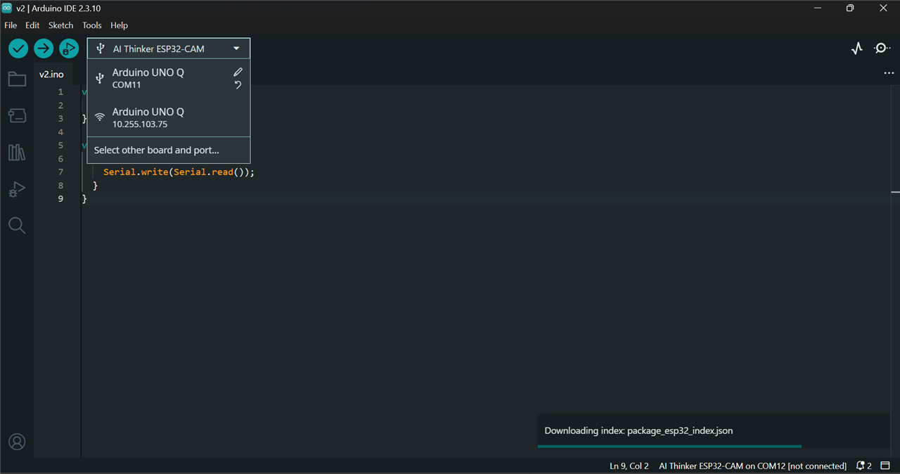

An interesting observation is that, once Wi-Fi has been configured, the Arduino UNO Q appears as both a standard physical COM port and a Network Port in the Arduino IDE, provided that the board and the laptop are connected to the same network.
Now we can upload simple blink sketch:
void setup() {
  pinMode(LED_BUILTIN, OUTPUT);
void loop() {
  digitalWrite(LED_BUILTIN, HIGH);
  delay(1000);
  digitalWrite(LED_BUILTIN, LOW);
  delay(1000);

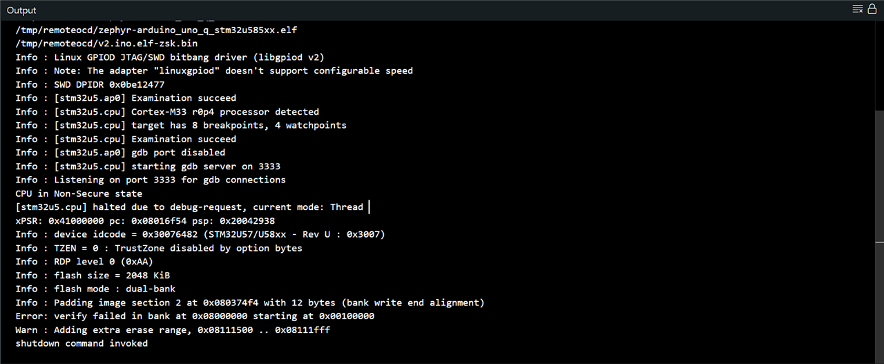

{gallery}Code Upload
Arduino Bridge Library Not Installed
Successful Code Upload Log
Programming traditional STM32 microcontrollers usually requires deep embedded systems knowledge. It is one of the reasons many hobbyists do not touch them easily because of their reputation of being hard to program. We need to configure register-level settings, HAL, clock configuration,  use tools like STM32CubeIDE and connect debuggers like an ST-Link. The Arduino Uno Q bypasses all of this complexity by abstracting the difficult parts into the friendly Arduino ecosystem. The board package pre-configures all clocks, timers, and internal settings the moment the board boots up. If we want to use the high-performance 14-bit ADC, we do not need to initialize registers; we simply type analogRead(A0).

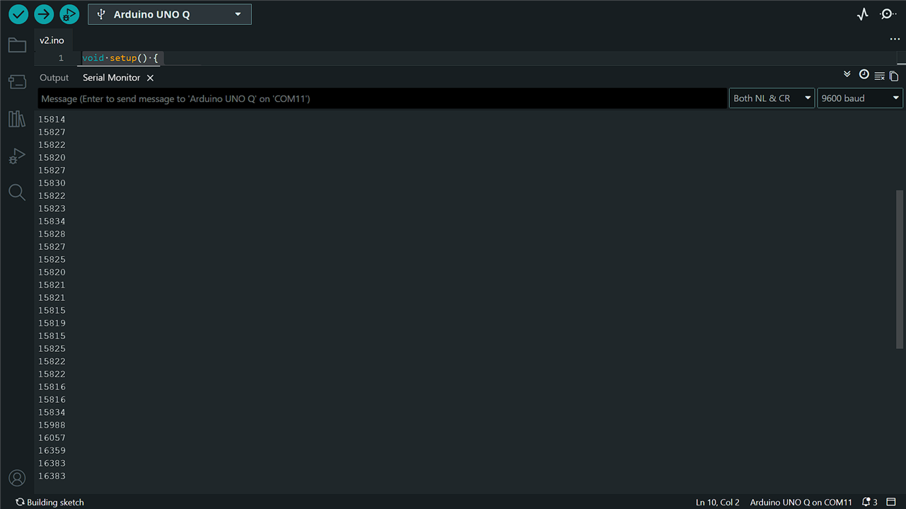

Analog Performance
ADC Testing
The STM32U585 provides a 14-bit ADC.
A 10 kΩ potentiometer was connected to A0.
Initial testing produced only 10-bit values because the ADC resolution must be explicitly configured: analogReadResolution(14);
void setup() {
  Serial.begin(9600);
  analogReadResolution(14);  // To set 14bit precision
void loop() {
  int value = analogRead(A0);
  Serial.println(value);
  delay(1500);
After enabling 14-bit mode:
The 14-bit ADC of Arduino Uno Q gives us 16,384 distinct values, which is exactly 16 times more resolution than a standard 10-bit ADC which only gives 1,024 values.

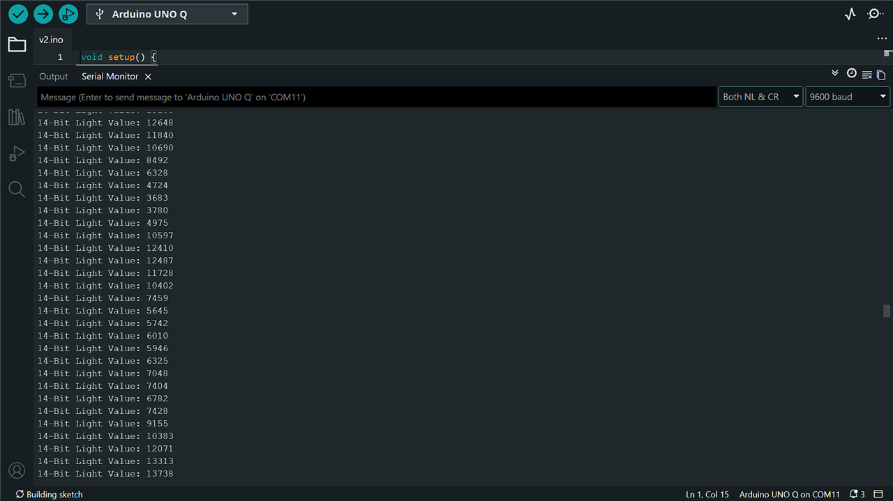

LDR Testing
A light-dependent resistor was connected to the ADC input.
void setup() {
  Serial.begin(9600);
  analogReadResolution(14); // For full 14-bit resolution
void loop() {
  int ldrValue = analogRead(A0);
  Serial.print("14-Bit Light Value: ");
  Serial.println(ldrValue);
  delay(150);
The board correctly produced varying readings according to illumination level.

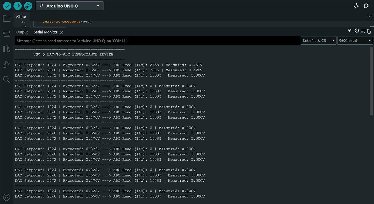

DAC Testing
DAC to ADC Loopback
The STM32U585 includes a true hardware 12 bit DAC.
For testing the DAC, I did not had a suitable amplifier circuit available, nor was I able to build one at the time. Therefore, I looked for alternative methods to evaluate the DAC capabilities of the UNO Q. I found that the board's ADC can be used to measure the output of its own DAC, creating a simple loopback test. In this setup, the DAC output is connected to an ADC input, allowing the generated analog voltage to be read back and verified by the microcontroller. I then implemented this loopback test to evaluate the DAC's functionality and performance.
DAC (A1)
ADC (A0)
#include <Arduino.h>
const int dacPin = A1;
const int adcPin = A0;
void setup() {
  Serial.begin(9600);
  while (!Serial) delay(10);
  analogWriteResolution(12);
  Serial.println("================================================");
  Serial.println("        UNO Q DAC-TO-ADC PERFORMANCE REVIEW     ");
void loop() {
  int testValues[3] = {1024, 2048, 3072};
  for (int i = 0; i < 3; i++) {
    int targetDacValue = testValues[i];
    float expectedVoltage = (targetDacValue / 4095.0) * 3.3;
    analogWrite(dacPin, targetDacValue);
    delayMicroseconds(50);
    int rawAdcValue = analogRead(adcPin);
    float measuredVoltage = (rawAdcValue / 16383.0) * 3.3;
    Serial.print("DAC Setpoint: "); Serial.print(targetDacValue);
    Serial.print(" | Expected: "); Serial.print(expectedVoltage, 3); Serial.print("V");
    Serial.print(" ---> ADC Read (14b): "); Serial.print(rawAdcValue);
    Serial.print(" | Measured: "); Serial.print(measuredVoltage, 3); Serial.println("V");
    delay(2000);
  Serial.println("------------------------------------------------");
The measured voltages closely tracked the expected DAC outputs, confirming correct DAC operation.

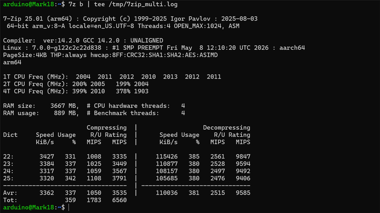

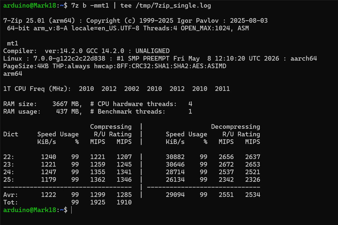

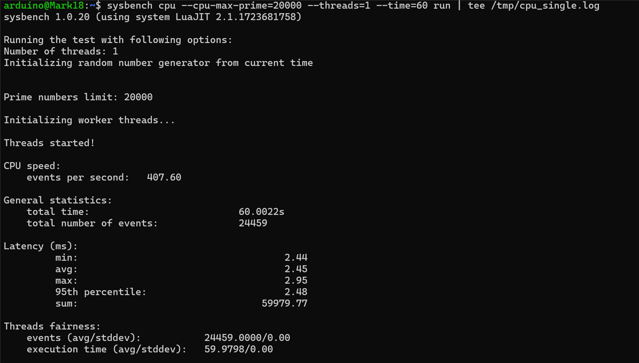

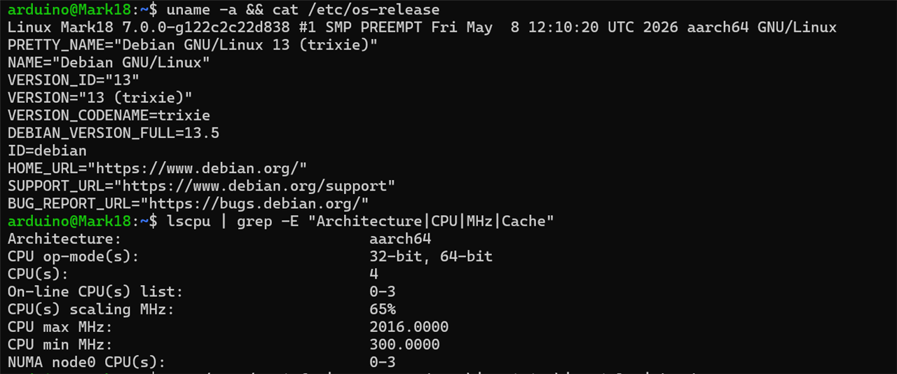

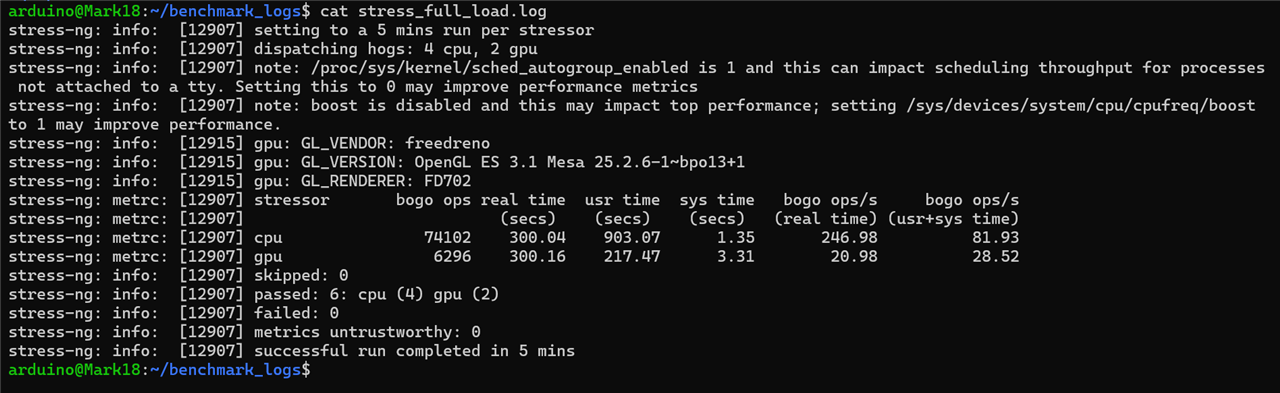

Linux Benchmarking

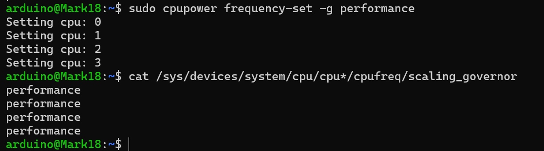

While the microcontroller handles real-time peripherals, the SBC side is responsible for Linux workloads. The Governor is Linux kernel driver that depends the speed and performance control of processor cores. It dynamically  manages the operating frequency based on workload, increasing frequency when heavy load is detected and reducing speed on low load to conserve power and maintain temperature. The term governor is taken from the physical governor that were earlier used in automobiles to keep the engine speed constant. Governor has different modes for different purpose:
1. performance: Locks the CPU at its maximum rated speed permanently. It never drops down, even if the system is idle.
2. userspace: Kernel stops managing the CPU speed automatically, it allows a user with root privileges (or a specific background daemon) to manually set and lock the CPU to a specific, fixed frequency.
3. ondemand: Dynamically adjusts the CPU speed depending on how hard the system is working, constantly checks the CPU usage. If the workload hits a certain threshold, it instantly jumps the CPU to its                                            maximum  clock speed. As the workload decreases, it slowly lowers the clock speed back down.
4. schedutil:  The modern standard. Unlike ondemand, which guesses workload by looking backward at CPU utilization statistics, It integrates directly with the Linux kernel scheduler. It calculates the exact                                            frequency  needed to handle current tasks smoothly
For benchmarking purpose and measuring raw speed, we require the governor to be in performance mode.  After setting it, following are the benchmarks to analyze the performance
CPU Performance

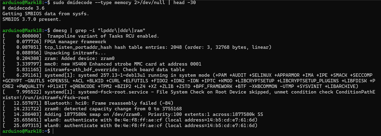

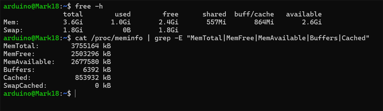

{gallery}Versions, Governor and other stats
OS version, Cpu details
Setting Governor to performance

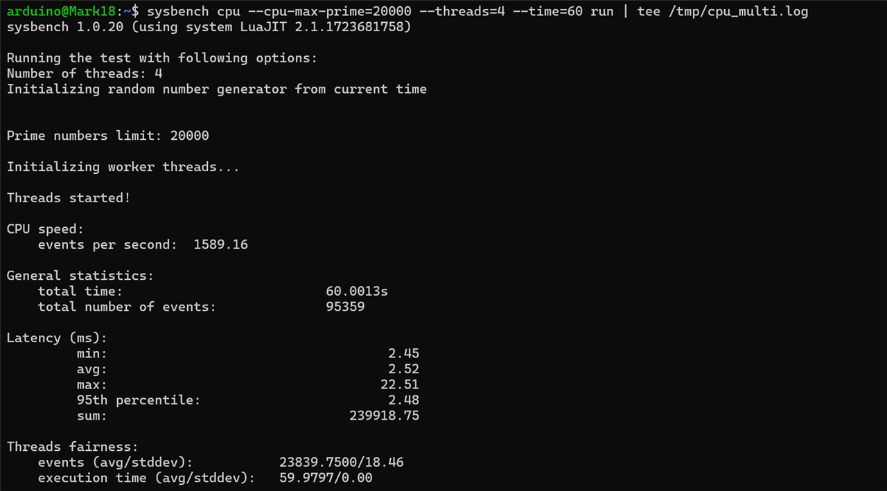

Sysbench
Single-thread result:
407.60 events/sec
Multi-thread result:
1589.16 events/sec
Performance scaling was close to four times the single-thread result, indicating efficient utilization of all available CPU cores.
Compression Benchmark
7-Zip Benchmark
Single-thread total rating:
1910 MIPS
Multi-thread total rating:
6560 MIPS
The substantial increase in performance under multi-threaded operation further demonstrates the effectiveness of the quad-core Cortex-A53 architecture.

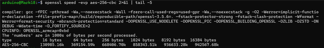

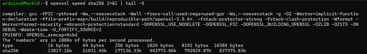

Cryptography Performance
AES-256
~942 MB/s
SHA-256
~837 MB/s

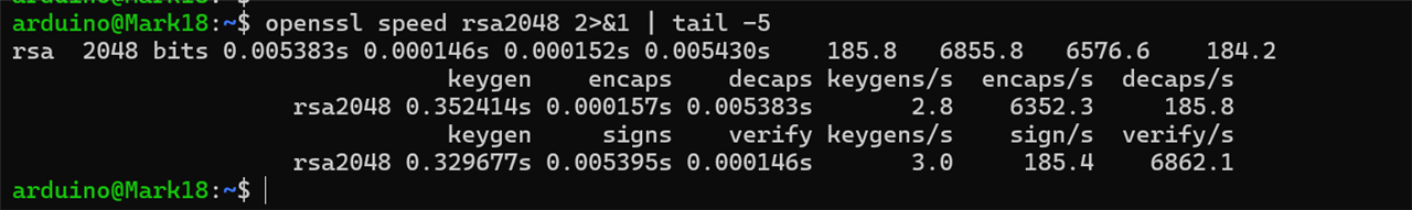

RSA-2048
Sign: 185 ops/sec
Verify: 6862 ops/sec
Hardware acceleration and ARM cryptographic extensions indeed provide strong performance.

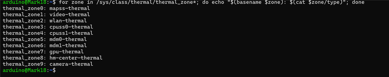

Thermal Testing
This test evaluates the system stability and thermal dissipation capabilities of the Arduino Uno Q SBC Qualcomm MPU. The Arduino Uno Q has 10 hardware thermal zones to closely monitor heat layout across different parts.
I selected zones 0,3,4 and 7 to focus on CPU and GPU
stress-ng --cpu 4 --cpu-method all --gpu 2 --timeout 300s --metrics-brief 2>&1 | tee ~/benchmark_logs/stress_full_load.log
while true; do t0=$(awk '{print $1/1000}' /sys/class/thermal/thermal_zone0/temp); t3=$(awk '{print $1/1000}' /sys/class/thermal/thermal_zone3/temp); t4=$(awk '{print $1/1000}' /sys/class/thermal/thermal_zone4/temp); t7=$(awk '{print $1/1000}' /sys/class/thermal/thermal_zone7/temp); echo "$(date '+%H:%M:%S') | MAPSS: ${t0}°C | CPU0: ${t3}°C | CPU1: ${t4}°C | GPU: ${t7}°C" | tee -a ~/detailed_thermal_log.txt; sleep 2; done
Evaluation Phase MAPSS (Zone 0) CPU0 (Zone 3) CPU1 (Zone 4) GPU (Zone 7)
Idle Baseline 39.1°C 41.0°C 41.3°C 38.8°C
Stress Peak Max 62.4°C 68.9°C 68.3°C 60.8°C
Sustained Delta +23.3°C +27.9°C +27.0°C +22.0°C
Cool-Down Baseline 37.9°C 39.1°C 38.5°C 37.9°C
I did the test without heatsink or any active cooling.
Standalone vs Desktop vs Remote Mode
Essentially the Arduino Uno Q can be used in three ways or configurations: being connected with desktop, remote desktop and stand alone single board computer.
Desktop Mode
This is the default out-of-the-box configuration and is highly recommended for first-time setup and initial prototyping. In this mode, Arduino App Lab is installed directly on a laptop or desktop computer, and the UNO Q is connected via its USB Type-C interface. After the initial Wi-Fi and credential setup, the board can also be accessed wirelessly through network mode using App Lab.
In this configuration, the desktop handles the computationally intensive tasks, such as compiling Arduino sketches and processing Python scripts. When the Run button is pressed, App Lab uploads the compiled firmware to the STM32 microcontroller over USB while simultaneously launching the companion Python applications on the Linux-powered Qualcomm microprocessor.
This is the simplest operating mode, requiring only a single USB cable to connect the UNO Q to a desktop or laptop computer.
Network Mode
Once the initial configuration is complete, the physical connection between the desktop and the UNO Q can be completely removed while retaining full programming and management capabilities. After the board is provided with the local Wi-Fi credentials, it becomes an active node on the local network through mDNS discovery. Arduino App Lab then connects securely to the board over the network using an automated SSH connection. This mode provides true desktop freedom, allowing the UNO Q to remain mounted inside a robotics chassis, installed in an automation panel, or placed elsewhere in the workspace while still being fully accessible from a laptop or desktop computer.
Firmware updates can be uploaded to the microcontroller, Python applications can be deployed, and AI models can be modified without requiring a direct USB connection.
This mode is particularly useful for hackathons, demonstrations, events, and projects where quick remote access to the board is important. It also eliminates the hassle of carrying extra cables and repeatedly connecting and disconnecting the board from a computer.

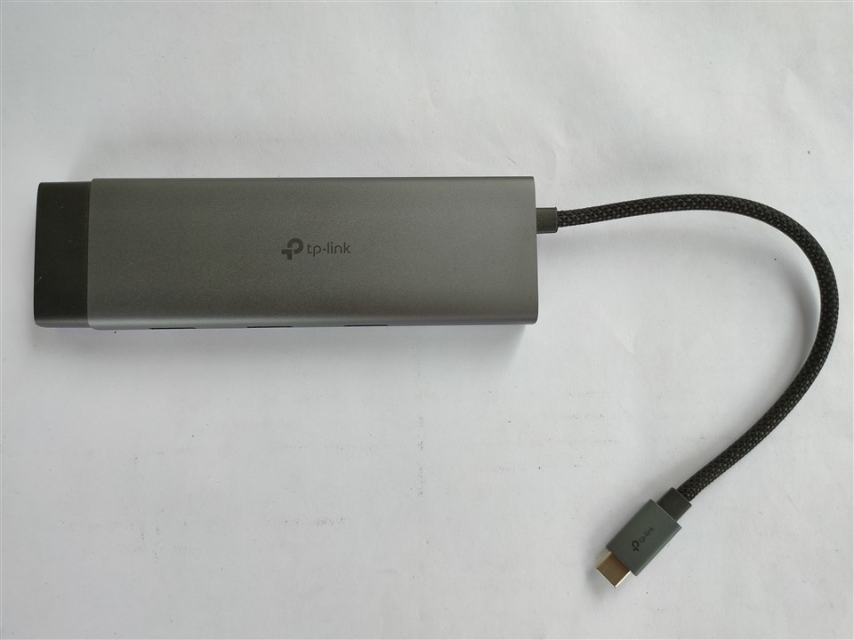

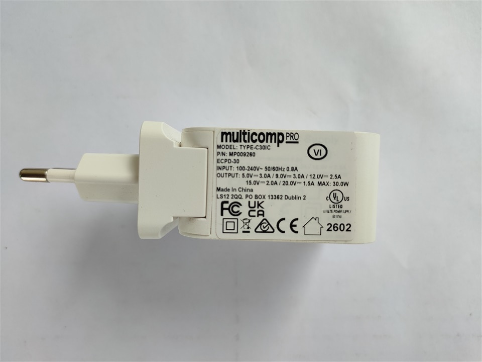

SBC Mode
In this configuration, the Arduino UNO Q moves beyond the traditional "development board" role and functions as a full-fledged Linux desktop computer. For this use case, the 4 GB RAM variant is recommended.
The board is powered using a dedicated 5 V / 3 A USB Power Delivery supply. To expand its connectivity, a USB-C hub is connected to the Arduino UNO Q. Using the hub's power pass-through feature, the board can be powered while simultaneously taking advantage of its multi-role USB-C interface for additional USB peripherals and Ethernet connectivity. Thanks to the onboard ANX7625 bridge chip, the UNO Q's USB-C port also supports DisplayPort Alt Mode. This enables the board to output Full HD (1080p) video directly to a compatible monitor, allowing it to be used much like a conventional desktop computer.
In this mode, Arduino App Lab runs natively on the board's Linux environment, utilizing the onboard quad-core Arm processor, LPDDR4X memory, and eMMC storage. The UNO Q effectively becomes a self-contained edge computing platform, capable of operating without a host PC. This configuration is particularly well suited for deployment scenarios where the board must capture camera feeds, perform local AI inference and graphics processing using the Adreno 702 GPU, and simultaneously control real-time hardware through the STM32 microcontroller and its associated I/O headers. By combining Linux-class computing with dedicated microcontroller-based control, the UNO Q can handle both high-level application workloads and low-latency hardware interactions within a single compact system.
From a performance perspective, and to fully utilize the resources available on this SBC variant, I prefer using it in standalone SBC mode. However, when it comes to convenience and ease of access, network mode is the clear winner. Once the board is connected to the same network and powered on, it can be accessed from anywhere within the network range. This eliminates the need for a direct physical connection and makes remote management straightforward through SSH.
One of the most practical use cases I can imagine is keeping the board powered in a fixed location, such as a lab, workstation, or even inside a bag, and simply connecting to it remotely whenever needed. This reduces cable clutter, minimizes the hassle of handling the exposed and relatively delicate PCB, and makes the overall setup much cleaner. Wire management is greatly simplified, while the flexibility of accessing the board remotely remains intact.

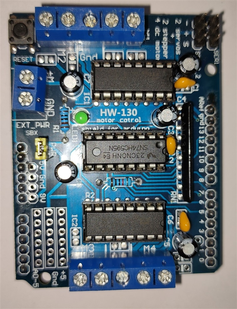

Arduino Uno Shields
Most of the Arduino Uno Shields are designed to work on 5V logic while the Arduino Uno Q works primarily on 3.3V though some of its pins are 5V tolerant. Digital integrated circuits on older shields are often designed to recognize specific voltage thresholds to distinguish between 'high' and 'low' signals, many older chips require a minimum input voltage to reliably register a 'high' state. Because the Uno Q outputs a 3.3V signal, it frequently falls below this required threshold, leading to unreliable communication or complete failure of the shield. While the risk of hardware damage is generally low, these mismatched logic levels create an unpredictable environment where signals may be misinterpreted by the shield, making it essential for users to check the datasheets of their specific shield components.
I had this L293D Motor driver shield for Arduino Uno, containing two L293D motor driver ICs and a 74HC595 shift register. It is capable of driving 4 servo motors or 2 stepper/servo motors.
I was planning to use this shield with the Uno Q SBC for a 4 wheel drive. However, I wasn't sure whether it could damage the board before I had fully reviewed it, so I decided to postpone testing the shield. I'll update this with a link to the project once I've completed it.

  • At the time of writing this review, the app.yaml file of example apps cannot be edited, even the copy of examples do not allow it.

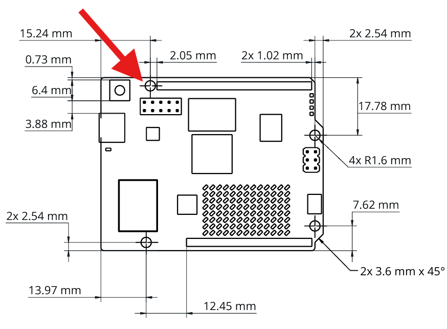

  • Out of the 4 Spacer utility holes on the pcb, the one between Power button and Digital Pins Header appears to be too close to the headers, stopping and obstructing the M3 header nut of spacer to be fitted. However the small head screws fits perfectly.

  • Hey, As i can see in DAC section you are getting 3.3v instead of instead of 1.65v and 2.4v because you are using analogWrite() function which for controlling pwm duty cycle and not for a true analog output.
    Since this board runs Zephyr RTOS under the hood, Zephyr DAC API can be used to get analog output from pins A0 and A1.
    for example:-
    #include <zephyr/drivers/dac.h>
    const struct device *dac_dev = DEVICE_DT_GET(DT_NODELABEL(dac1));
    struct dac_channel_cfg dac_cfg = {
    .channel_id = 2, // Channel 2 (PA5 / A1)
    .resolution = 12 // 12-bit hardware resolution
    void setup(){dac_channel_setup(dac_dev, &dac_cfg);}
    void loop (){ dac_write_value(dac_dev, Pin, targetDacValue);}
