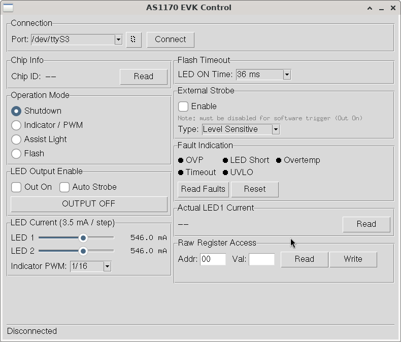

ams OSRAM provides a PC GUI application (AS1170-GUI, V1.1) with the kit. The idea is straightforward: plug in the ESP32 via USB, open the GUI, select the serial port, and get a complete graphical interface for configuring all AS1170 registers without writing a single line of code. No installation required - a genuinely useful thing to offer with an evaluation kit.
That promising start did not last. The host computer was missing drivers for the CP2102 USB-to-serial converter on the ESP32 board. Installing them was quick, but there is no clear guidance on this anywhere in the getting-started material. The answer eventually turned up not in the official guide but on a random documentation page, buried in an image.
The GUI launched and showed a connected MCU, then prompted navigation to the configuration screen - which is the only thing in that initial view. That intermediate step adds nothing; the application could simply open to configuration directly.
The configuration screen itself is functional but low-contrast and not particularly accessible to users with low vision. Those are fixable issues. The critical problem was not: the Chip ID never registered as detected. After trying reconnection, different cables, and a different computer, the result was the same. There is no troubleshooting guide to consult.

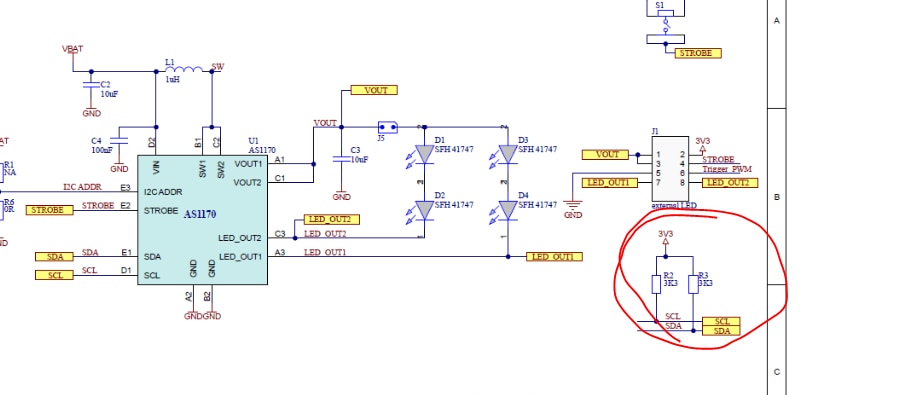

Rather than debugging an unknown firmware state, a custom firmware and matching GUI were written from scratch, modelling the interface closely on the original. A basic I2C scanner at startup detected nothing. Checking pin assignments against the EVK schematic revealed that the board does not use the ESP32's default I2C pins - it uses GPIO 12 and 13. After updating the firmware accordingly, the scanner still detected nothing.
The root cause turned out to be hardware: pull-up resistors R2 and R3 were not populated on the board. Once soldered in, everything worked. Whether this was a board assembly defect or an undocumented user step, the documentation makes no mention of it either way.
The vendor software is a starting point you will quickly outgrow. For any serious evaluation work, you will want firmware you control. The approach taken here was an Arduino driver for the AS1170 running on the ESP32-S2, exposed as a JSON serial bridge, with a Python/Tkinter GUI on top.
