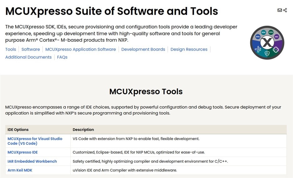

MCUXpresso IDE is NXP's Eclipse-based integrated development environment for its microcontroller portfolio. It integrates the GNU Arm toolchain, project management utilities, advanced debugging capabilities and seamless integration with the MCUXpresso SDK. The latest version of the IDE was downloaded directly from the NXP website, where several development tools are available depending on the target platform (Figure 12). For this evaluation, the Linux x86_64 installer was selected.
Installation on Ubuntu 24.04 LTS was straightforward. The provided installer automatically deployed not only the IDE itself, but also all the required development components, including LinkServer, the MCU-Link utilities, LPCScrypt and the SEGGER J-Link software package. During installation, the required udev rules were also configured, allowing supported USB debug probes to be accessed without requiring superuser privileges during normal development (Figure 13).
One small observation for Linux users is that the installer places the IDE under /usr/local/mcuxpressoide, but it does not automatically add the executable to the user's PATH. The IDE can be launched directly from its installation directory or by creating a launcher or updating the shell environment if command-line access is desired.
During the first launch, MCUXpresso prompted for a workspace location before opening the main development environment (Figure 14). No additional configuration was required, and the IDE was immediately ready for SDK installation and project development. Once the workspace had been created, the main window presented quick access to the most common development tasks, including SDK management, project creation and example import (Figure 15).
The evaluation was performed on Ubuntu 24.04 LTS using MCUXpresso IDE version 25.6.136.

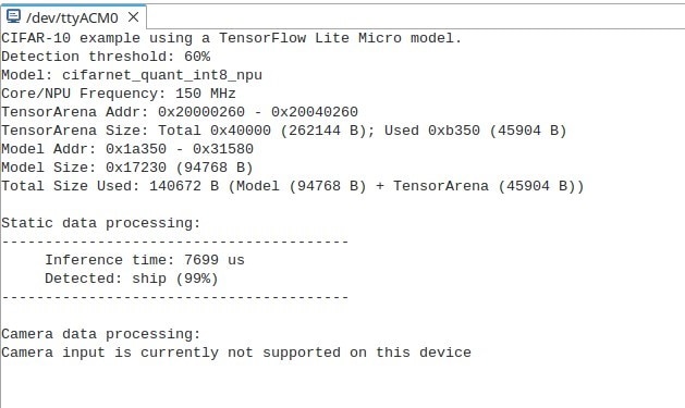

tflmImportUart
Figure 52: UART output produced during the execution of the TensorFlow Lite Micro CIFAR-10 example.
Several interesting observations can be made from the console output.
First, the application identifies the deployed model as cifarnet_quant_int8_npu, indicating that the example uses a quantised 8-bit neural network specifically prepared for execution using the NPU backend.
Secondly, the application reports both the reserved Tensor Arena size and the amount of memory actually consumed during execution.
Parameter Value
Model cifarnet_quant_int8_npu
Model Size 94,768 B
Tensor Arena Reserved 262,144 B
Tensor Arena Used 45,904 B
Total Memory Used 140,672 B
Core / NPU Frequency 150 MHz
Although a Tensor Arena of 256 KB is reserved, the selected CIFAR-10 model required only approximately 46 KB during execution. This leaves considerable headroom for larger neural networks or more complex inference pipelines while maintaining deterministic memory usage.
Another noteworthy aspect is that the TensorFlow Lite Micro runtime automatically reports the memory consumed by the interpreter, making it straightforward to estimate the RAM requirements of a given model without requiring additional instrumentation.
After the runtime completed its initialisation, the application executed inference using a static test image embedded within the firmware.
The reported classification result was:
  • Detected object: Ship
  • Confidence: 99%
This confirms that the complete inference pipeline was operating correctly, including model loading, tensor allocation, execution of the neural network and output post-processing.

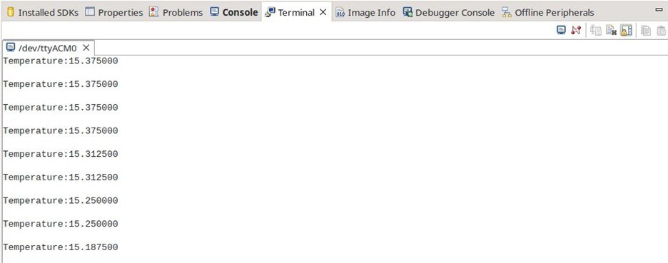

Once programmed into the FRDM-MCXN947, the application periodically reported the measured temperature through the serial console. The reported values were stable and closely matched the ambient room temperature, providing a good reference point before extending the example.
P3t1755Uart
Figure 58 : Serial terminal showing periodic temperature measurements generated by the SDK example.
Starting from a fully functional SDK example significantly reduced the amount of development effort required. Rather than implementing the communication protocol from scratch, I was able to focus entirely on extending the application with additional functionality.

As expected, the reported temperature gradually decreased over several measurement cycles, confirming that both the I3C communication and the sensor driver were operating correctly. As the measured temperature crossed the configured thresholds, the firmware automatically switched the RGB LED from red to green, and finally to blue, demonstrating the correct operation of the complete temperature indication logic.
P3t1755UartCold
Figure 64 : UART output showing the measured temperature after cooling the sensor.

10. Development Experience
Throughout this RoadTest, the FRDM-MCXN947 proved to be much more than a development board showcasing individual hardware features. Instead, it presented itself as a complete embedded development platform where the hardware, software tools, SDK and documentation work together to provide a smooth and productive development experience.
While the board includes impressive hardware capabilities such as dual Arm Cortex-M33 cores, the PowerQuad accelerator and the integrated Neural Processing Unit (NPU), what ultimately determines the usability of any development platform is how easily developers can access and exploit those capabilities. In this respect, the MCUXpresso ecosystem plays a fundamental role by providing a mature SDK, a comprehensive collection of example projects and an integrated development environment that significantly reduces the initial learning curve.
The following sections summarise the aspects that stood out most during this evaluation, together with a comparison against other development platforms that I have used in both professional projects and personal development.

  • The out-of-the-box experience was excellent, allowing productive development to begin within only a few minutes of opening the package.
  • MCUXpresso IDE integrates seamlessly with the on-board MCU-Link debugger, providing a straightforward workflow for project creation, programming and debugging.
  • The MCUX SDK is mature, well organised and includes a large collection of practical examples that can be easily adapted into custom applications, significantly reducing development time.
