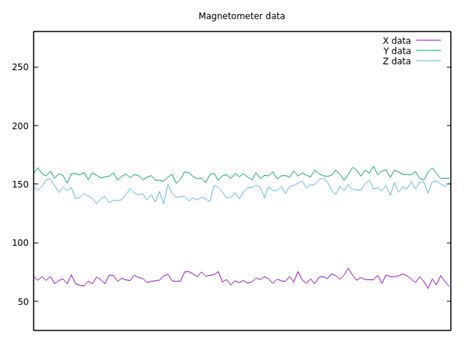

Data collected from magnetometer
The pictures with title "Magnetometer data" is the data collected from the magnetometer when the board is in rest during 5 seconds period. Data was smoothed for the plot via "smooth csplines" in gnuplot.

From the assembled solution, the following graphs show the data collected from the magnetometer.
Shooting right: X data goes up in the graph.
Shooting down: X data goes up in the graph.
Shooting left: X data goes down in the graph.
Shooting up: X data goes down in the graph.
It is possible to notice that the X axis is the more sensible one, varying during all movements. The others axis were not as sensible as X axis.
