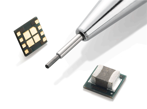

The LMZ20501 SIMPLE SWITCHER nano module is a DC-DC buck voltage converter, with inductor incorporated into it, very small in size which is suitable for IoT sensor power ups.
Unboxing
Product Description
SIMPLE SWITCHER Nano Module EVM is a evaluation board for LMZ20501. It's a DC-DC buck converter in a small package with inductor built-in. A embed regulator and inductor in a single compact package.
The size of the package is blows my mind, it's just 21mm3 called nano package, the design will require minimum components like input and output voltage filter capacitors along with feedback resistors. The LMZ20501 is capable of providing upto 1A current. It's suitable for powering low voltage sensors, ICs and MCUs. LMZ20501features include Internal Synchronous Rectifier and Current Limit Protection.

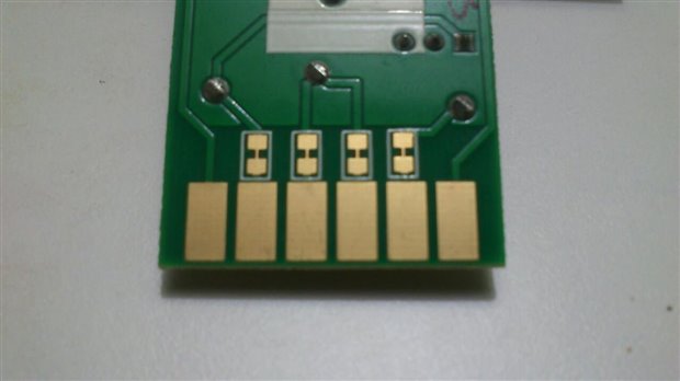

The module also has 6 traces at the bottom the module edge.
From left to right EN, VINS, GNDS, VOUTS, RTD...
  • EN - You can enable the module remotely without using the EN jumper pins in the top, you have to completely remove the EN jumper to enable the pin remotely, Just connect the trace with external source, it can be 5.5V power source with switch or GPIO pin of the MCU, this is the cool feature to use with MCUs.
  • VINS - It can be connected to DMM to check the accurate VIN voltage.
  • GNDS - Both the 3rd and 4th trace is the GND Pins to use.
  • VOUTS - Can be connected to DMM to check VOUT voltage.
  • RTD - The Resistance Temperature Detector is used to check temperature of the bottom of the board, you have connect 100ohm pulled down resistor.
