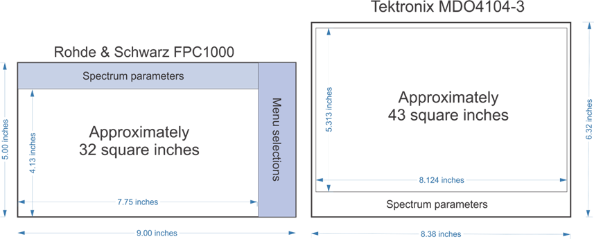

While on the topic of the screen, I took some measurements to see how the viewable spectrum area on the FPC1000 stacked up against the viewable spectrum area on the Tektronix MDO4104-3.  The two instruments are shown side-by-side below.
Rohde & Schwarz FPC1000 and Tektronix MDO4000 side by side
Initially, the FPC1000 screen looks quite generous, but not all of the screen real estate is devoted to displaying the spectrum.  From the total screen area subtract the menu text area on the right side and the parametric information area across the top. To get a better sense of the differences in screen area available to display spectrum traces, look at the diagram below, which is drawn to scale.
The R&S screen has 45 square inches of usable image space (9" x 5"). However, only 32 square inches are set aside for the spectrum traces.  Of the 53 square inches available on the MDO4000 screen, fully 43 square inches can be used to display spectrum traces.  The MDO4000 spectrum trace area is about 34% larger than the spectrum trace area on the FPC1000.  Tektronix and Rohde & Schwarz made graphical user interface design decisions during product development. Tektronix decided to develop a graphical interface with removable menu overlays that temporarily occupy a portion of the spectrum trace area, but can be removed by pressing a front panel "Menu Off" button.  R&S decided to permanently assign screen real estate to display menu and parametric information.  As far as I can determine, these areas are static and cannot be removed.
On a clear day you can see your menu options from here

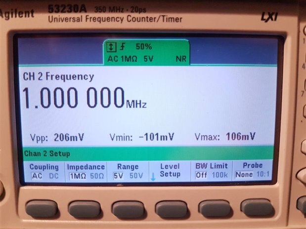

To verify the frequency output of the 33622A, I connected a 53230A counter with an oven controlled oscillator.  The counter input was set to 1 M ohm input impedance to reduce loading on the waveform generator output.  The images below show the counter measurement to 7 digits on the left, and on the right, to 15 digits (yes, it can do that).
So the generator is producing a sine wave accurate to with in about 130 mHz of 1 Mhz.  Not bad.

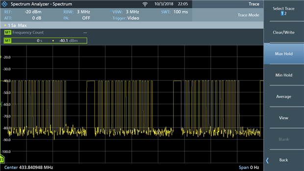

To accommodate a range of probable command code frame duration and repetition rate, let's slow the sweep down to 100 ms.  From experience, I expect that will allow us to see at least one complete code frame, and probably more.  Remember that setting a Zero Span turns the FPC1000 into a frequency selective oscilloscope.  In this case, the FPC1000 will show us what happens at exactly 433.8 MHz over a span of 100 ms.  Now, about triggering.  We don't want to run continuous sweeps.  We are only interested in capturing what happens when a button is pressed on the remote.  For this reason I selected Max Hold on Trace 1 (to retain whatever happens on the screen) and set the sweep to trigger on Video 50%.  This means the FPC1000 will sweep when the Video filter output is at 50% of its range.
At this point I added a 10 dB attenuator to the antenna (see photo) because I am holding the remote fairly close to the antenna and there is a possibility of overloading the IF section of the spectrum analyzer.
10 dB in-line attenuator added to antenna
I am delighted to report that the set up worked perfectly and the FPC1000 was able to essentially decode the modulation of the 433.8 MHz signal.  See the screen capture below.
On-Off code frames from RF remote
This is nice.  I wasn't sure the FPC1000 (without the modulation analysis option) could deliver this level of demodulation detail.   A couple of transmitter characteristics can be derived from the image above.  First, it appears the remote does indeed use OOK modulation.  This is revealed by the pulse nature of the trace which shows that the remote transmits fixed amplitude 433.8 MHz bursts (On key), spaced by zero amplitude intervals (Off key).  Second, the code frames are about 25 ms long and they do indeed repeat as long as a button is held down.  Now we can zoom in on a single code frame and, by capturing the code frame for each button, determine the code pattern for each function.  Two minor irritations to report at this point.  First, the M1 marker is located at the far left edge of the screen capture marking the start of the trace.  The trigger point itself is marked by a barely visible green icon to the left of the -60.0 dB legend.  I can't seem to move the trigger point to the right to make it more visible.  Perhaps the trigger can be moved to the right, but I just haven't figured out how to do so.  If it can't be moved, that would be annoying.  Below are the code frames transmitted by each of the buttons on the remote.  Second, while working on this investigation, the WiFi connection to the FPC1000 was lost more than once.  Not sure if the issue is with the FPC1000, or my router, but everything else that is WiFi enabled doesn't lose connection, so the FPC1000 is currently suspect.

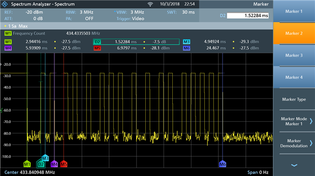

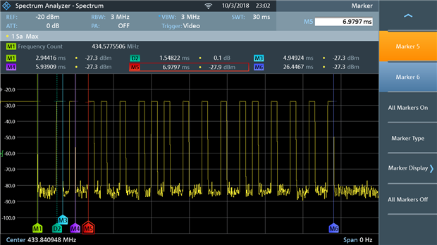

A single On-Off code frame
A single Functions code frame
A single Sync code frame
A couple more observations about the user interface came up during this investigation.  First, there are 6 markers available on the FPC1000.  The first four are accessed on one menu screen (see screen capture of the On-Off code frame), but the other two markers (5 and 6) are accessed on a separate menu list (see screen capture of Functions and Sync code frames).  Having to switch between the two menu lists is a minor inconvenience.  Second, each marker can be set to display an absolute value (time in this case, but normally frequency), or each marker can be set to display the difference between itself and marker 1.  This is great because sometimes absolute values are useful and other times delta values are useful.  However, I would like to be able to specify the two markers that are used for each delta.  For example, in the screen captures above, I used all the makers with the hope of being able to measure the duration of various pulses within the code frames.  To measure the duration of the narrow pulses following what I think might be an automatic gain control (AGC) pulse at the start of each frame I put a marker at the start and end of the first narrow pulse.  If I select delta, or difference mode for these markers, I get the delta, or difference of these markers relative to the position of marker 1.  I would like to get the delta between markers 2 and 3 instead.  Not a big deal.  Just a little arithmetic is needed, but I'd like the instrument to do the arithmetic for me.

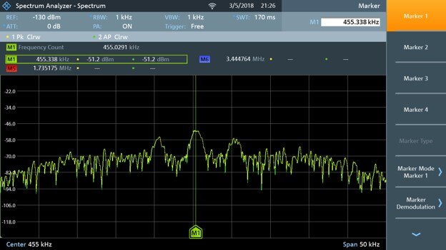

There is one more cool feature, mentioned earlier, that I would like to illustrate.  That feature is Marker Demodulation.  The base version of the FPC1000 (no K7 Modulation Analysis option installed) allows AM or FM demodulation of marker 1.  In the case being described here, AM demodulation of marker 1 (located at 433.8 MHz) allows you to hear the code frames as they are transmitted by the RF remote.   I found this to be an interesting new perspective on data communication and a potentially useful teaching tool.  Check out the short video below which lets you hear the On-off, Functions, and Sync commands as they are transmitted by the RF remote.
Marker demodulation of an OOK signal

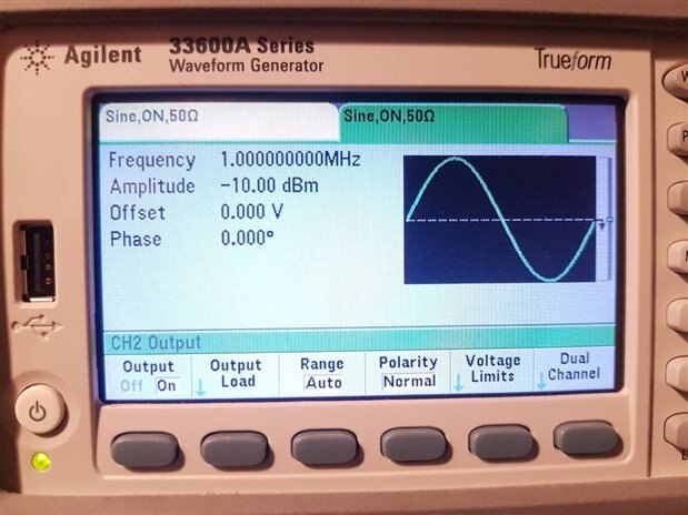

To generate a two frequency signal I used the dual channel combining features of the Keysight 33622A waveform generator.  This generator allows the outputs from its two channels to be electronically combined into a single output.  Signal amplitude, DC offset, and frequency can be coupled so that changes to the combined output channel affect both channels.  In addition a fixed frequency offset can be programmed between the channels, which is a great feature for conducting intermodulation experiments.  In the first video clip below I demonstrate how third order products are produced as signal amplitude is increased and how these products produce signals very near the original f1 and f2 signals (at 2f2 - f1 and at 2f1 - f2) and other undesired products well away from the original signals.
There is no external Device Under Test (DUT) in the demonstrations that follow.  The Keysight 33622A is fed directly into the MDO4000, and in subsequent demonstrations, directly into the FPC1000.  So where are the non-linearities coming from that create the intermodulation products?  This question is discussed in some detail in the R&S application note referenced above.  Essentially the non-linearities are coming from the generator, the spectrum analyzer, or both.  What is important is that you get to see that they are real, they are problematic, and that the FPC1000 can make automated third order intercept measurements for you. It took a lot of experimenting to find a sweet spot on the MDO4000 where everything responded as dictated by the nonlinear mathematics that describe intermodulation products.  What I looked for was 3rd order intermodulation products appearing at the expected frequencies (that part was easy) and changes in the amplitude of the products that agreed with theory (that was more difficult).  According to the math, when signals are subjected to non-linear processes, a 1 dB change in f1 and f2 amplitude should produce a 3 dB change in the adjacent (in-band) third order intermodulation products.
The 33622A was set up to combine a 10.000 MHz sine wave with an 11.000 MHz sine wave.  Initially the amplitude was set to -40 dBm.  At this amplitude, no non-linear effects are observed on the MDO4000.  With f1 = 10.000 MHz and f2 = 11.000 MHz, the math tells us that once amplitudes of f1 and f2 are sufficient to cause non-linear responses, we should see 3rd order intermodulation products at the following frequencies:

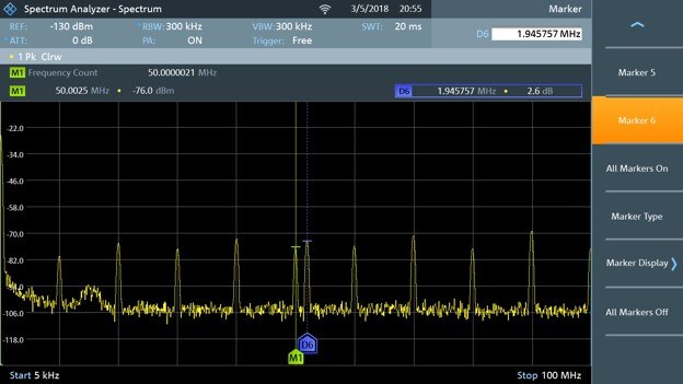

With no input signal connected, we began speculatively tracing through the signal path. The first thing we stumbled upon was a strong signal at ~52MHz, as shown.
Knowing the general architecture of the receiver quickly led us to believe that this was the first LO section. If this is indeed the 1st LO, the strongest frequency we will see in this section will be the tuneable local oscillator signal.  When powered up, these receivers go through a quick self test, then they restore the 1st LO frequency in stored in memory.  The brief video below illustrates this power up behavior.
Because there is no RF signal being fed into the input, all we see in terms of h-field emissions from the 1st LO is the local oscillator signal being restored from memory following power up.
Recalling the “down-mixing” product (fLO-fRF= fIF), we can deduce that the receiver was last tuned to receive ~11.493 MHz. How?  Because to produce a down converted IF signal at 40.455 MHz, a LO signal at 51.948 MHz would have to mix with a modulated signal at 11.493 MHz (51.948 MHz – 11.493 MHz = 40.455 MHz).  Without having the control software at hand we could not adjust the first LO frequency (note the absence of a tuning knob on the front panel), so this ended up being useful information for when we fed in some test signals later on.
At this point, I was using a fairly large sweep and a fine resolution bandwidth, which of course limited how fast I could physically move the probe around and expect to see something on the screen. Using a second trace and having it set to max-hold was helpful to avoid missing signals, and it also helped to play with the orientation of the probe to get the maximum response.

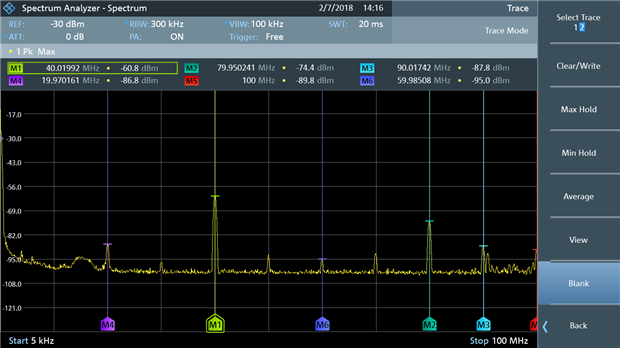

The next large signal we discovered in another section of circuitry was a sinusoid at 40 MHz – the LO of the second conversion stage.
Moving to the other end of this can, we see a large number of harmonics. Using the measurement markers, it is clear that they are spaced at 10 MHz intervals – hinting that we are seeing the frequency quadrupler that is responsible for taking the 10 MHz reference and turning it into the 40 MHz LO for the second conversion stage. Marker 6 also shows some evidence of the first LO, which makes sense as the PLL circuit is immediately adjacent.

At this point, the second IF and following signals are below the usable frequency for our nearfield probe. Luckily, the second IF is available directly as an output on the rear panel, meaning we could connect it directly to the FPC1000 using coax. Using a signal generator, we fed in a AM signal with a carrier frequency of ~11MHz -- corresponding to the receiver’s assumed tuning based on our 1st LO measurements – and a modulation frequency of 5kHz. Setting the FPC1000 in center-span mode corresponding to the 455kHz IF output, we observed the expected carrier tone and corresponding sidebands.
This rear-panel IF output is actually meant to be used as a signal monitor to see what is on the airwaves when tuning the receiver. With that in mind, we put the FPC1000 into spectrogram mode and simulated adjacent stations broadcasting 10 kHz apart.
Here, I ran into another quirk with the FPC1000 that Mark had previously mentioned. The accuracy of the signal was weirdly impacted by the scan speed – to the point where we began questioning the function of both the receiver and the signal generator we were using.

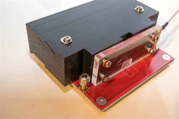

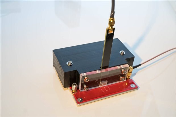

    Here is the test jig I made, which allowed me to keep the probe in a guaranteed position (the X and Y positions are fixed with this jig, and the vertical Z axis can be changed by unscrewing the clear plate at the front, and moving the probe up or down. There is no shim implemented currently, that would be done with the edge on the probe.
    Slight trimming X and Y adjustments are possible by loosening the two top screws on the black block, and then re-tightening them once it is in position. After that, the black block does not ever need to be unscrewed.
    The left side has a 50-ohm termination, and the right side goes to the signal or tracking generator.
    Slightly more of a close-up is below (also probe removed for this photo by loosening the clear plate screws), you can just about see a bit of the test signal trace on the left side:
    I was wondering about open-sourcing the CAD files once it is tweaked, and then maybe selling the probes assembled for anyone that wants it without making it. But each one takes care to assemble and then run tests to make sure the PCB factory diidn't change PCB material on me, or thickness, etc. I was thinking maybe to give it to a cousin to order PCBs and teach them how to assemble and sell it, since they could do with the money. It is hardly going to be a mass-market product though!
    EDIT: Another thing holding me back from selling them is that they may not be all that cheap, since I don't want to foist a half-done product on anyone.. so the five sets I currently made up each have specific assembly steps that I'm still tweaking, and the probes have smoothed edges etc, i.e. I'm doing hand-cutting and machining to each PCB, rather than use the factory PCB directly and be done with it image
