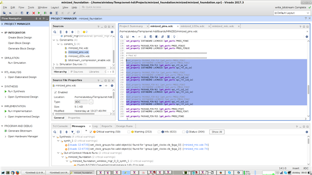

For my first experience I decided to add a new SPI controller, and connect it to one of the PMOD connectors. With the block design open, click on the “plus” sign and search for SPI. You should see a “AXI Quad SPI”. Add it to the design, and use the design assistant to connect the AXI ports. Click on the SPI_0 port with the right mouse button and click on “Make External”. Connect the interrupt pin to an empty slot of “xlconcat_0”, which aggregates the PL interrupt sources into a vector. That should be all on the hardware design side. If the “design assistant” still shows, please connect any extra ports that may still be floating.
We then can map the pins by updating the relevant pin constraints:

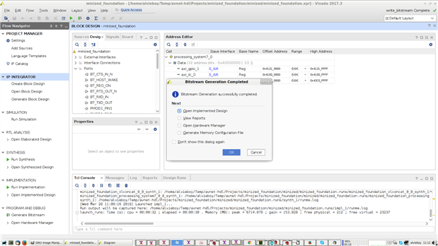

Creating the bitstream
Again, simple, just click on "Generate bitstream". Once it finishes, you get something like this:
Exporting hardware
Make sure to export the bitstream as well.

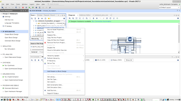

The second design aimed to integrate another CPU in the Programmable Logic. I wrote a small wrapper for my ZPUino System-on-a-Chip in order to connect it to the AMBA bus.
Importing RTL sources
First step is to start with a "bare" design including the required core logic for the Petalinux distribution. I then imported all relevant VHDL files for the design. Then just select the toplevel, and choose "Add Module to Block Design".
I also added an extra UART to connect to ZPUino serial port, so we can access its output from linux and avoid any external serial/USB converter.
The RTL design exports a few registers to the PS that allow controlling ZPUino memory contents and the reset status.
