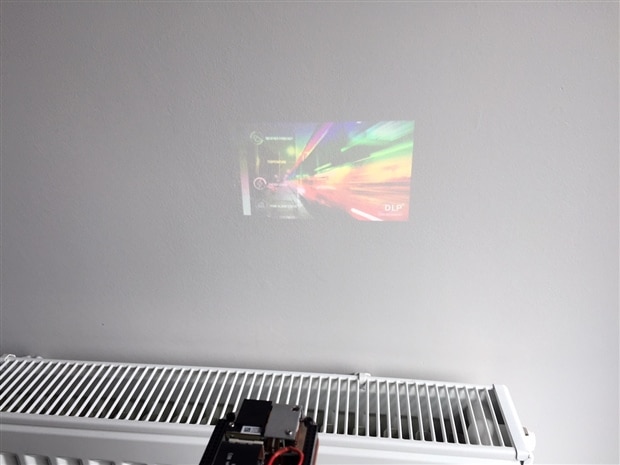

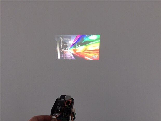

The module was pre-mounted on the BeagleBone Black, contained in an anti-static bag. There was no packaging or documentation for the module, except for a little card.
As I removed the BeagleBone Black and module from the anti-static bag, I noticed something about the module looked different from the pictures I had seen so far:
A simple heatsink was pre-installed, which is nowhere to be seen in the documentation or pictures of the module. The documentation does mention the module can get rather hot when operating at full brightness:
The DLPDLCR2000EVM optical engine can be driven to 30 lumens at maximum current settings, but will also run at high
temperatures. It is recommended that the user add a heatsink to the system when running beyond typical operating conditions to
maintain the same unit temperature.

The module comes with a 5V/3A power supply, which can be connected directly to the cape. While connected to the BeagleBone Black though, applying power to the cape is not sufficient to get it to power on (it is when disconnected from the BeagleBone black). That's a pity, as a beefy power supply as the one provided could easily power both.
Powering the BeagleBone Black via the miniUSB interface causes the projector to power on and display a default image.
While the projected image is visible in a normally lit room, the colours really pop when used in the dark. Putting the projector 1 meter away from the wall, the image is approximately 60*35 cm.
At 2.5 meters from the wall, the image is approximately 155*90 cm. The pixels can be distinguished from up close.
