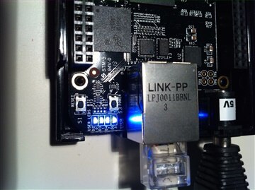

I inserted the microSD card in the proper slot on the BBB, held down the "user boot" button while powering it on. The 4 user LEDs lit up, and I released the "user boot" button.
40-45 minutes later, the 4 user LEDs remained lit up, meaning the flashing was done.
I powered down the BBB, removed the microSD card and powered it back on.
When I tried to log in via SSH again, a message appeared telling me the remote host key had changed.
This is for me an indication the flash was executed. I removed the exisiting entry from my known_hosts file and was able to log in via SSH again.

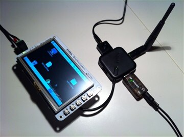

The LCD cape provided for the roadtest is the "BeagleBone LCD4 Cape" from beagleboardtoys.com.
It supports resolutions up to 480x272 and has a resistive touch screen and some buttons.

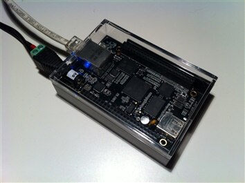

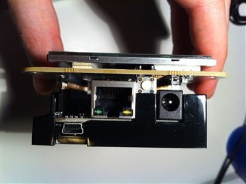

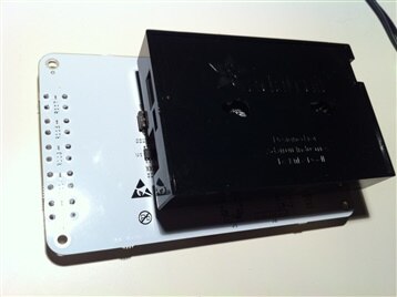

The pins at the back of the LCD cape are numbered, just as on the BBB. I ensured the pin numbers were aligned and connected the cape.
I'm not sure if done on purpose or not, but the bottom part of the Adafruit BBB enclosure can still be used with the LCD cape connected.
This provides a firm and protective base for the BBB.
Even the LCD cape's power button fits nicely between the BBB's ethernet and power port.

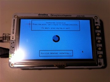

After booting a calibration screen was displayed:
I had to repeat the calibration a few times, as it kept saying a mis-click was detected. On the fourth ( ! ) attempt, the calibration was accepted.

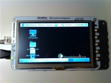

Once the calibration was done, the desktop was available:
Using the latest version of Angstrom, I can say the LCD cape was really plug-and-play.

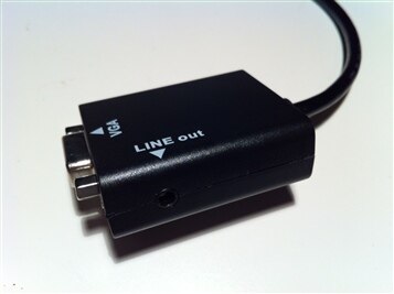

Using a microHDMI to VGA and Stereo out adapter, I was hoping to easily get audio out of the BBB.
However, when listing the soundcards of the BBB, none were found:
root@beaglebone:~# cat /proc/asound/cards
--- no soundcards ---
root@beaglebone:~# aplay -l
aplay: device_list:252: no soundcards found...
After some searches online, I came across Beagleboard:BeagleBoneBlack HDMI - eLinux.org where it is stated that audio is only supported when using specific video resolutions.
I removed the LCD cape, tried listing the soundcards again, and there it was:
0 [Black          ]: TI_BeagleBone_B - TI BeagleBone Black
                      TI BeagleBone Black
**** List of PLAYBACK Hardware Devices ****
card 0: Black [TI BeagleBone Black], device 0: HDMI nxp-hdmi-hifi-0 []
  Subdevices: 1/1
  Subdevice #0: subdevice #0
The soundcard appeared, but my microHDMI adapter still didn't show any video via VGA, nor was there any audio via the stereo jack.
I decided to park the HDMI audio solution for now and go with the hopefully more straightforward USB soundcard approach.

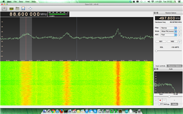

Before working on the BBB directly, I wanted to test the SDR Stick on my laptop, as I had never worked with such a device before.
Via the SDR USB Stick's product page on Adafruit, I found a nice graphical tool ported to Mac: gqrx. I installed it and started playing.
In a matter of seconds, I was listening to the radio:

Use the device argument 'rtl_tcp=192.168.0.121:1234' in OsmoSDR (gr-osmosdr) source
to receive samples in GRC and control rtl_tcp parameters (frequency, gain, ...).
On my laptop, I started the gqrx application and provided the correct connection string, the BBB reported the client connected:
client accepted!
Radio was now working on my laptop via the BBB.

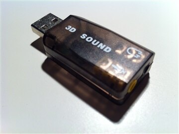

One day after posting this, my USB soundcard arrived. I should have been more patient ...
Using the same commands as before, I tried detecting the USB soundcard after plugging it in:
0 [Set            ]: USB-Audio - C-Media USB Headphone Set
                      C-Media USB Headphone Set at usb-musb-hdrc.1.auto-1.1, full speed
card 0: Set [C-Media USB Headphone Set], device 0: USB Audio [USB Audio]
  Subdevices: 1/1
Soundcard detected without any modifications. Feeling lucky, I tried playing out audio immediately:
root@beaglebone:~# rtl_fm -f 88.6e6 -s 200000 -r 48000 - | aplay -r 48k -f S16_LE
Found 1 device(s):
  0:  Realtek, RTL2838UHIDIR, SN: 00000001
Using device 0: Generic RTL2832U OEM
Found Rafael Micro R820T tuner
Tuner gain set to automatic.
Tuned to 88900000 Hz.
Oversampling input by: 6x.
Oversampling output by: 1x.
Buffer size: 6.83ms
Sampling at 1200000 S/s.
Output at 200000 Hz.
Playing raw data 'stdin' : Signed 16 bit Little Endian, Rate 48000 Hz, Mono
Audio was playing. Amazing. No need for driver installation, config file changes, etc ... just plug and play.
  • jkridner
    jkridner over 12 years ago in reply to fvan
    Ah, I skimmed right over it where you concluded the LCD cape was the issue. Good find. I tuned out too early as I already knew what was going on there.
  • fvan
    fvan over 12 years ago in reply to jkridner
    I indeed came across that page while searching for my problem, as mentioned in my blog post, no need for snarky link image
    Having the LCD cape connected had a direct effect on the "hdmi soundcard" being enabled or disabled.
    The LCD's resolution is not one supporting audio, so for now I concluded that as long as the LCD cape is used, I won't get any HDMI audio.
  • jkridner
    Audio is only supported at specific resolutions. I know that is a bit odd, but it could get you your HDMI-to-VGA+audio adapter working.
    The wiki has the info: Beagleboard:BeagleBoneBlack HDMI - eLinux.org  (snarky link: Let me google that for you)
    The use of the LCD might have something to do with the audio being disabled.
