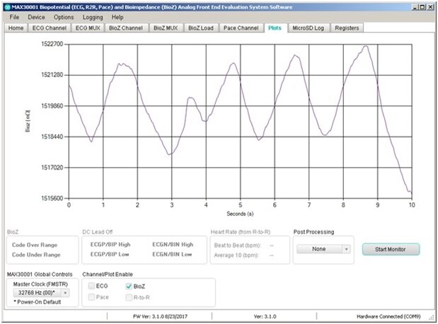

The plot in Figure 5 shows the results of the BioZ measurement using the settings recommended in the tutorial video.
Figure 5. BioZ Measurement with Tutorial Settings
The plot in Figure 6 shows the results of the “BioZ Only” Quick Start settings. Changing the current generator magnitude from 8uA to 32uA caused a shift in the neutral point of the plot but appears to not have had a large affect on the measurement. Changing the frequency of the current generator has some notable effect on the output as well. The easiest change to notice is when you change the filters on the BioZ Channel setup tab.
Figure 6. BioZ Measurement with Quick Start Settings
The GUI software makes it extremely easy to modify settings for evaluation (plug for Maxim Software guys). Playing with these settings it is possible to get reasonable results even with shallow breathing (yes, I have to give a plug to the chip designers as well).

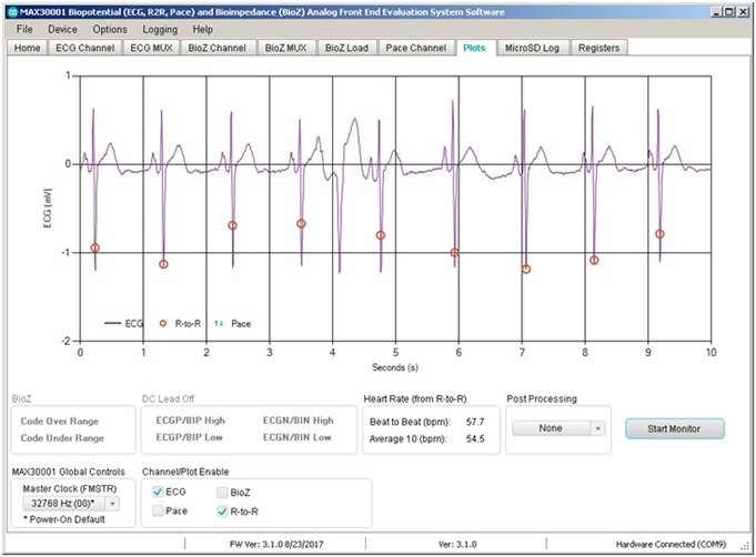

Step 4) ECG Measurement: ECG was of more interest to me (having an irregular heart beat). The “Run All” quick start setting on the GUI software Home tab works for both the BioZ feature and the ECG feature. The input leads just need to be moved on the Evaluation board. Moving the Red lead to ECGP and the White lead to ECGN sets up for ECG monitoring (no changes to the “Run All” configuration). The wet electrode positions on the body were not changed. The plot in Figure 7 shows for the results of the ECG capture.
Figure 7. ECG Measurement with Quick Start (Run All) Settings
Note that the red circles added to the graph by the R to R function (for measuring heart rate) work well on a normal Sinus Rhythm. Beats can be are missed when the heart does a short interval beat (near 3 and 7 seconds on the plot). The Beat to Beat Heart Rate measurement did change down to the 30s when this occurred indicating the beat really was missed. There are settings on the ECG Channel tab of the GUI software that allow you to tweek the sensitivity and windowing functions of the R to R function (modifying the settings provides significant improvement in the R to R function for irregular heart rhythms).
