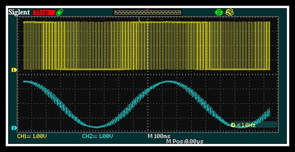

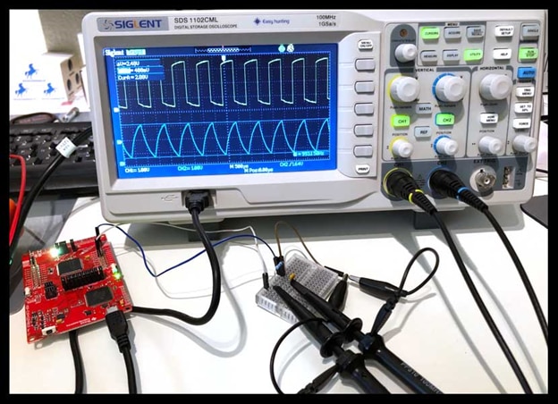

The lecture is a very basic introduction to voltage, current, and power.  The objective is to give some understanding of Ohm’s Law and what voltage, current, and power are.  High school students with some physics will have covered the material in more detail than the lecture and college students who have had a first course in physics or an introductory course in electrical engineering will have studied it in much greater detail.  It might serve as an introduction or refresher of very basic concepts for some.

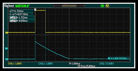

Lab 2.2 uses the LaunchPad to create a square wave at different frequencies while connected to a RC circuit on the breadboard.  The code is not explained but it uses a simple delay to toggle a pin and create the square wave.  An oscilloscope (or TExaS) can be used to the measure the voltage across the capacitor which is in series with the resistor at different frequencies and from this the reactance calculated.  The highest frequency generated was 1000 Hz – quite low.
The introduction warns that the measured and predicted values may differ (but does not explain what the causes might be) and this was certainly the case.  It does however illustrate how a capacitor can be used as a filter.  I don’t remember it discussing cutoff frequency which is in the quiz.
Lab 2.3 uses the LaunchPad as a 3V3 power source to light a LED in series with a resistor.  The resistor value is varied and the voltage across the LED is measured and the information used to generate a V-I curve.
Summary Thoughts: This is a rudimentary introduction to basic electronics and can be skipped by most electronics enthusiasts. I am not sure that the TExaS tools will be that useful (but stand to be proven corrected) and recommend at least having a digital multimeter.  I spent about an hour and a half on this module.  I recognize time is limited but an introduction to issues beginners face such as component selection is missing.

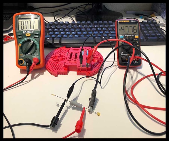

The lecture discusses sources of power (e.g. wall power with AC to DC converter, DC power such as USB, Batteries, etc.  It also covers voltage regulation including switchers and linear regulators.  There is a brief discussion of power budget and microcontroller sleep mode.  Different types of batteries and their attributes are discussed.  The kit uses six 1.2V NiMH rechargeable batteries in series (7.2V) rated at 1.8 Ah which gives roughly 3.6 hours runtime for the robot.  The robot has a linear regulator to run the microcontroller and runs the motors directly off of the batteries.  There is mention of the TI WEBENCH Power Designer and an overview of designing your own power supply.  Measurement of power efficiency is covered.
Lab 5.1 Four batteries are connected in series and then run down through a 10 ohm resistor while measuring current and voltage.  I’ve done similar experiments before and did not carry the project through to a drained battery.  I did set up the lab and run it briefly as shown in the photo below.
The experiment requires you to have a multimeter for measuring voltage and another for current.  Batteries are provided but a charger is not.  This did not seem like that useful a lab.
Lab 5.2 describes how to connect up power distribution and the mechanical assembly.  Professor Valvano (or one of his lab assistants) should demonstrate how to cut the traces and do the necessary soldering in the video.  I cut the traces with the razor edge of a box cutter and then tested with a multimeter to make sure there was no continuity.  Here it is all wired up and ready for mechanical assembly.
The description of mechanical assembly could be improved but was not overly difficult.  In addition I believe my kit substituted metal screws for plastic as the packet is labelled “.5in 4-40 plastic mach. Screws” but it contains metal screws.  The instructions state “Align the standoffs with the four holes on the LaunchPad. Depending on where you choose to mount the LaunchPad, you may have to increase the side of the hole on the chassis to ¼ inch to accept the 4-40 screw”.  I saw no possible way to align the LaunchPad with the chassis and not have to enlarge a hole.  In the end I substituted some of my own hardware as I felt it made for a nicer assembly.  Holes must be drilled in the breadboard so that it can be attached.
Following assembly I powered it up and checked 3V3 and 5V.  I also checked to make sure there were no shorts across the breadboard since it had been drilled.

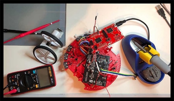

At this point I decided to go ahead and assemble much of what remained of the robot body even though the video and course materials did not explicitly say to do so.  I decided earlier in the week that I wanted to add encoders and have just received them so I soldered them to the motors first using the Pololu instructions.  The male pins on the encoders insert neatly into the motor control board.
Next I soldered female DuPont connectors to the reflectance sensor array.  There were not any screws in the kit that fit the holes in the reflectance PCB so I bought some #2 machine screws and nuts at the local hardware store.  Metric M2 would work as well.
Surprisingly (to me anyway) the holes in the reflectance array do not line up with the holes on the bed of the robot.  I could not stand the thought of nonsymmetrical parts that weren’t square so I used a Dremel tool to lengthen a couple of the slots. I placed the array further forward than the photos in the course materials show so that it could hopefully sense edges and not fall off a table.  I chose to solder to the line sensor and use duPont connectors on the MSP432.
Here is the view looking at the top after inserting the motors.
This is a view of the bottom.
Summary Thoughts:  Assembling the robot, including soldering, took about 3 hours because I kept fooling around with it trying to decide how I wanted to mount the reflectance array and then had to make a trip to the hardware store. Another thing, this robot needs more cowbell LEDs.

Lab 6.1 demonstrates how the QTR-8RC sensor works.  The basic principle is that a 10 us output pulse is used to charge a capacitor on the QTR-8RC.  Reflected IR light then causes a light sensitive transistor to discharge the capacitor.  More light from a light surface causes a faster discharge and by measuring after a fixed period it can be known whether the surface is black or white since the GPIO pin on the MSP432 goes low when it meets the threshold for a low signal.
The following photo demonstrates the experimental apparatus and the quick discharge that occurs when the sensor is receiving reflections from the white table.  The lower (blue) trace on the oscilloscope is the analog discharge from the capacitor.  The upper (yellow) trace is the digital signal interpreted by the GPIO pin on the MSP432.
In this screenshot from the oscilloscope it can be seen that the time for the GPIO pin to read low is approximately 1.5 ms.  This occurs when the capacitor discharges below approximately 1.7 V.
In the photo below the robot has been moved to the right so that the IR sensor is directly above the black tape.  Note the longer period that the digital signal remains high.  In fact, it doesn’t go low during the period shown because the capacitor doesn’t discharge that far with my setup.
Lab 6.2 takes the information learned in Lab 6.1 and uses it to determine how far the robot has strayed from the black line.  The software is written by the student who then measures the reported deviation from center of the black line as the robot is moved.  The photo below shows the setup.
I was surprised at how linear the data was although it is not particularly granular and the data plotted below is as fine as the resolution gets.  It should be quite acceptable though for guiding the robot along a line.
Summary Thoughts:  I recommend making reference to the datasheet and family reference manual in this module.  I lost time trying to figure out exactly what was required by the labs and how the downloaded CCS files worked.  This would not be as much of a problem in a group setting or with a lab assistant but may be an issue for those working through the course alone.  After saying all that, this was a very educational and satisfying module.  I spent about an hour on the lectures and around 3 hours on the first lab. The second lab was about 1.5 hours.

Running sine wave output to adjust power
The first video gives an overview of the 24-bit SysTick timer.  The first task is to create delays, but later SysTick will use for interrupts.  When the MSP432 is running at 48 MHz and the SysTick Timer is running at bus speed then 1 cycle is 20.83 ns.  The largest possible range is 349 ms at which time it rolls over.
The second lecture discusses PWM and how to create it with the SysTick timer.  Describes the time constant which is 63% of the time to turn on.  For example a LED has a time constant to turn on of 90 ns vs. a motor of 100 ms.  Describes duty cycle.  Explains how the eye responds to the duty cycle of a rapidly changing LED as a change in brightness (power).  Shows how to make a simple DAC with a low pass RC circuit
The Lab 9.1 video is difficult to hear and I found the directions hard to follow in places.  It uses the SysTick timer to create PWM to a LED and then varies the duty cycle up and down.  Switch S1 on the LaunchPad is used to turn it on and S2 is used to turn it off.  The increase and decrease in PWM duty can be seen in the following video of my working code.
The lab took about 1.5 hours.
Lab 9.2 modifies the PWM output so that the duty cycle approximates that of a sine wave through the use of a table.  It then adds a RC circuit to smooth the output so that it is closer to the average of the pulses. The oscilloscope shows a sinusoidal curve after the RC circuit which models the way the motor will react to PWM (i.e. it doesn’t stop and start with each pulse if the pulses are fast enough).  The screen capture below from the oscilloscope shows the PWM output on the yellow trace and the smoothed output on the blue trace.  Note that there is still a fairly wide band in the output even after smoothing.
Summary Thoughts:  The lecture is straight forward but lab 9.1 confused me at first and it took a bit longer than it should have – again wouldn’t have been a problem if there was a lab assistant to answer questions. In all I spent about 2.5 hours on this module.

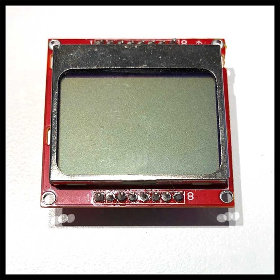

11. TI-RSLK Module 11 – Liquid Crystal Display
The Nokia display is not part of the TI-RSLK Maze Edition Basic but I happen to have one on hand as I have used them before in a number of projects.  I may come back and do this module after completing the RoadTest.  It is nice to have this training available as an option as the Nokia is an inexpensive addition to the kit.
Note: This part is not part of the TI-RSLK Maze Edition Basic kit and was not part of the RoadTest.

Labs 12.1 and 12.2 require that the robot be disassembled so that the controls from the microcontroller can be soldered to the motor driver and power distribution
board.  Took a bit less than an hour to do that and test connections.
The main effort was to write and debug the motor drivers needed for both Labs 12.1 and 12.2. This took around 2 hours, much of it spent removing self-inflicted bugs and in one case an apparent bug that really wasn’t a bug.  The motors were noisier than expected at first.  It needs a proper switch instead of a jumper from the power module to the LaunchPad (used to disconnect the power module when programming through USB). Will probably need to change the pins used for motor control as they will interfere in a later module when a BoosterPack (e.g. Wi-Fi or BLE radio) is used.  Measuring the current in Lab12.1 is difficult as are the other measurements since the motor control board is covered by the LaunchPad.

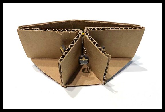

Using inputs to set and control the robot
17.2
