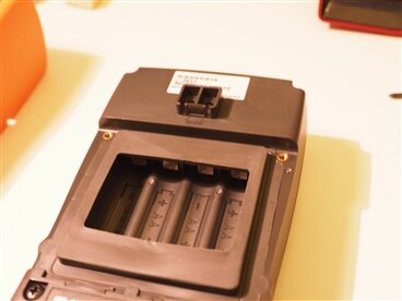

To get the batteries in, I had to get the multimeter out of its rubber sleeve, and it kinda lost its beauty. The batteries went in nicely in a nice, rubberized, and hopefully sealed compartment. Everything screws down into nice brass inserts embedded in the plastic molding, everything that you expect at this price point.

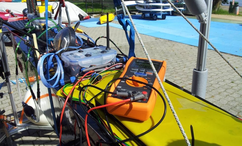

I study at EPFL and I am in the hydrocontest team in which, with a friend of mine, am responsible of the electronic, soldering and cable management on the deck of the boat.
By the way, it is a flying bi-foiler, it is pretty amazing !! Check the facebook page out !!!
In this environment the IP 67 rating of the multimeter was a game changer, because there is no-worries about dropping it in the water for a short time / or on the floor (Dave from EEVBlog made the ultimate test for us).
So it has been for me very useful, to check continuity, cable wire resistive impedance and also of course to monitor the battery voltage.
The accuracy of the measurements can be trust worthy, so much so that I won't even bother trying to test it. Because I don't have the capability, to make such verification nor the time, patience, skills... you get the point.
One thing that I didn't like at all is an annoying flickering on the screen when reading the measurements in a direct sunlight environment. Which I did for a full afternoon, to begin with, I thought I broke it, but shading the screen with my hand fixed the issue, but still for a IP67 equipment that is meant to be used outside, I was a bit frustrated. Also holding it under a bright desktop light reproduces the issue, maybe it can be fixed with a firmware revision (how can such a test not be performed in the development process of a multimeter ?)... for me it is not a big deal, but it could have potentially lead me to choose another multimeter. (If I had the budget for such piece of equipment).

I love this multimeter, it is by far the nicest piece of equipment I own, and it might be the best multimeter I have ever used (beside maybe a benchtop Fluke that we have at school).
Also the IP67 rating makes it even more valuable to me !! I can take it on the lake with me, make measurements with the multimeter on the boat's wet hull without even worrying about it. Not being afraid of it falling on the ground/in the water.
