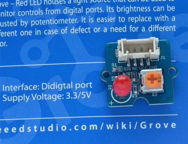

LED
The LED module has the LED removed which allows for replacement or swapping to another colour.
While this is a great idea, there is nothing to warn about inserting it the right way around.
The board has silk screening, but without something to warn the user, it is very difficult.
I'm also not sure about the new style of port that is available to connect the LED to.
The comment about the potentiometer needs clarification. What is a potentiometer?
The included potentiometer is called a "Rotary Angle Sensor" (see above pictures), so that thing called R2 on the board can't be the same thing.
Also if you've fitted your LED the wrong way around, twiddling this little control isn't going to do anything. image
When we run our Introduction to Arduino, we use the onboard LED, and then get them to plug in a LED brick to D13.
This demonstrates the LED works, and then we get the students to shift it to another Pin.
This demonstrates the proving process and how to check why it isn't working.

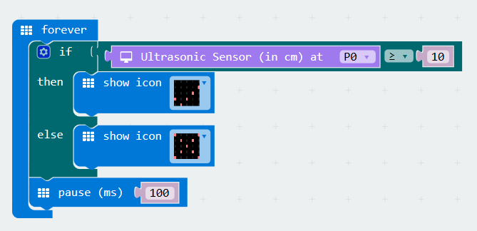

Smart Guard
This uses the Ultrasonic Ranger which I discussed earlier.
I've used the tick and cross icon as they are easier to see.
The code blocks behave a little different on the if, then, else block.
It seems the True block can't be removed.
You have to move the Values (Logic) block over the True
(which then becomes highlighted)
and then you add Ultrasonic Sensor block in place of the 0 value.
It eventually looks like this
Not exactly intuitive, and the instructions do it in the correct order, but a little more explanation saves frustration and disappointment when it doesn't work.
