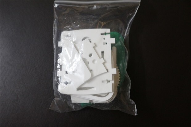

IMAGE TITLE: Contents of MOVE mini buggy kit box
IMAGE TITLE: MOVE mini body parts
IMAGE TITLE: MOVE mini body parts out of its pack
IMAGE TITLE: All the MOVE mini buggy body parts

As you can see in the above snaps that all the contents are packed nicely with foam cushions and Move mini parts are also in a bubble wrap for extra protection.
MOVE mini buggy kit box quality is average as compared to BBC micro:bit. Its body parts are looking strong, cleanly built and with some nice finishing so no sharp edges etc. Both the servos contain all the servo horns even though only one is required for MOVE mini assembly. That is something good and enable user to use these servos in any other project. Servo Lite control board`s components assembly and finishing is almost perfect and also its silkscreen quality is better than micro:bit. The MOVE mini tutorial book has very good paper, printing quality and also its made to last even after some rough use which is perfect for kids. Kitronik deserve the credit for making a perfect guide. Every thing required to assemble and run a first program is explained with detail and images.

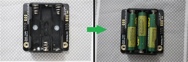

Servo:LITE control board testing
Before start testing the servo:lite control board, first check if on/off switch at off position or not. If power on/off switch is at on position simply turn it off and then insert 3x AAA cells (included in the kit). Now turn on the switch and check the voltage between 3V and GND terminals. Similarly we will also check the voltage between VCC and GND pin of both servo terminals. If we are getting ~ 3.3V (if all cells are new and each cell voltage is around ~1.6V) then our servo:lite is OK and its safe to connect our micro:bit with it.
{gallery} Servo:LITE control board testing
IMAGE TITLE: Before inserting cell turn off the ON/OFF switch
IMAGE TITLE: Insert 3AAA cell provided with the kit
IMAGE TITLE: Check the voltage between 3V and GND terminal
IMAGE TITLE: Check the voltage between GND and VCC pins of Servo_1 terminal
IMAGE TITLE: Check the voltage between GND and VCC pins of Servo_2 terminal

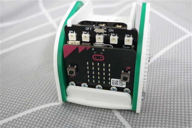

IMAGE TITLE: Clip the servo:LITE assembly under the hook of inner side panels
IMAGE TITLE: Tuck in the loss servo cable in between side panels
IMAGE TITLE: Snap in the :MOVE T in-front of micro:bit to secure it
IMAGE TITLE: Complete :MOVE mini buggy assembly with electronics

Assemble it for the first time is not too easy and you have to be little patient but after assembling few times it get easier and you also discover few tricks to attach these screws and nuts. But It is definitely FUN and some time you laugh at yourself when you don't give proper attention to the manual and assemble it in a wrong way and then you have to do it again from the beginning. Only slightly difficult part in its assembly is holding those tiny nuts in their slots properly. Overall the testing and assembly of MOVE mini buggy is not a very difficult task. There were some minor difficulties/issues and these can be improved/solved very easily by doing a minor adjustments in the design of kit.
