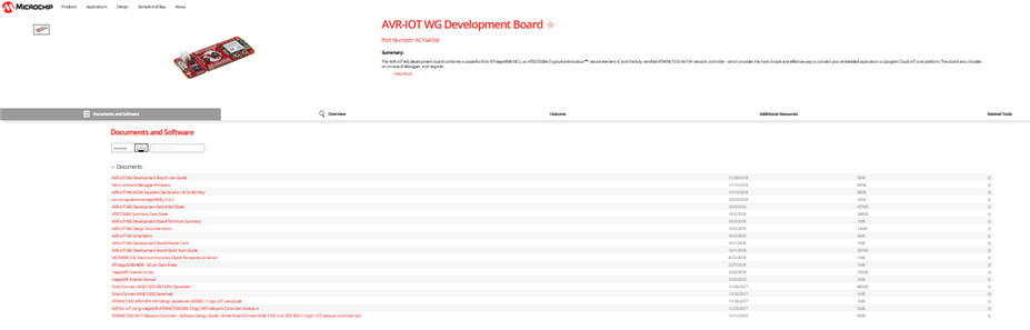

Documentation and the software
As usually with their products, Microchip prepared very professional support for its devices.
Details and links to documentation are available here
https://www.microchip.com/design-centers/internet-of-things/google-cloud-iot/avr-iot
https://www.microchip.com/developmenttools/ProductDetails/AC164160
Documents and Software are always available under onboard  "KIT-INFO.htm" link
Selection of most important documentation of the board
AVR-IoT-WG-User-Guide-50002809A.pdf
MCHP-ML3208UK-Fact Sheet Secure IoT Sensor Node)-97865M.pdf

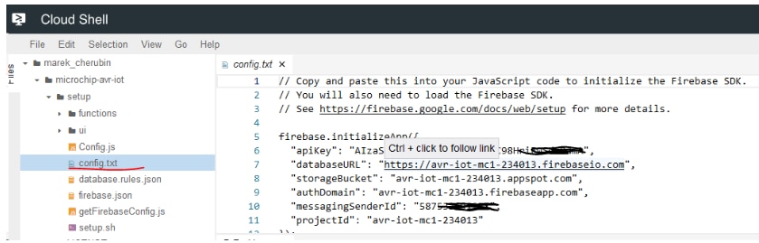

Cloud Resource Center / Google Cloud registration etc  - Leverege
All you need to start is available on Git:
imagehttps://github.com/Leverege/microchip-avr-iot
additioanlyy you can use that link as the support
Leverege - Getting Started with AVR-IoT: Pushing Data from Device to Cloud
https://www.leverege.com/blogpost/avr-iot-guide-pushing-data-to-cloud
I found most valuable information about the Leverege solutions concerned AVR-IoT here:
https://www.leverege.com/blogpost/iot-connectivity-options-for-asset-tracking
https://www.leverege.com/blogpost/cellular-iot-security
imagehttps://console.cloud.google.com/cloud-resource-manager?pli=1
imagehttps://cloud.google.com/iot-core/

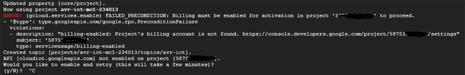

GCP Google Cloud Platform
I realized, that google Chrome is most convieneient when working with GCP - specially that concern the cloud shell interface.
Run the Quickstart Script
in the GCP window
Google Cloud, you'll see IoT Core on the side bar in the BIG DATA section.
If you forget to add the key before - in the shell there is possibility to correct the mistake here:

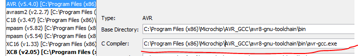

after the struggle with AVR-GCC compiler toolchain connection with MPLAB X
- The simple steps condusted according to the microchip instructions failed... - It's described some lines below.
I decided to install the whole ATMEL STUDIO.
After embedding avr-gcc-toolchain
BUILD SUCCESSFUL (total time: 18s)

I decided to add the AVR-gcc - to compare compilers capabilities etc...
https://www.microchip.com/mplab/avr-support/avr-and-arm-toolchains-c-compilers
Avr8-gnu-toolchain-3.6.2.1759-win32.any.x86.zip
According to the picture below, the GCC compiler is available now:

I realized that gcc toolchain form installation above works properly as the gcc compiler in MPLAB X.
I was able now to build AVR-IOT projects using MPLAB X with both compilers"XC8 and AVR-GCC.

but at the very beginning of setting my AVR-IOT google cloud project I wasn't asked to set account billing options.
I was sure, I can use it as the trial one year free, without account activation, card connection etc...
Moreover I didn't get any warning about lack of billing in Google Cloud Shell.
Only dealying with next project version, when, after desperate removal of the first "edition" some new errors appeared
ERROR: (gcloud.services.enable) FAILED_PRECONDITION: Billing must be enabled for activation in projec
After correction of that negligence my project worked properly.

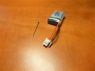

above attempt to use the simple LiPo battery from the ordinary toy
WRONG POLARITY!!!

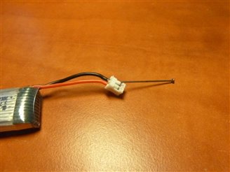

let's fix it as simple as possible:
it works now!
