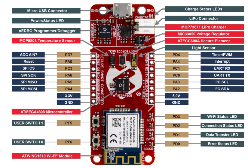

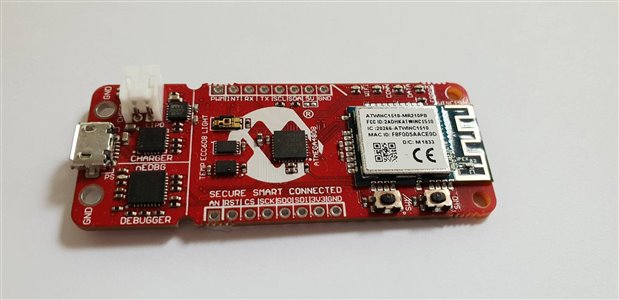

1.1 What is the Board and what does it do?
The AVR-IoT board is a development board aimed at the Internet of Things.  It has an on board Temperature and Light sensor for which the measurements are sent to the Google Cloud IoT platform every second.
It has a built in Debugger and Programmer that supports drag and drop programming, debugging and access to the built in MCU UART.
The user manual describes it as the following:
The AVR-IoT WG development board is a small and easily expandable demonstration and development platform for IoT solutions, based on the AVR® microcontroller architecture using Wi-Fi® technology. It was designed to demonstrate that the design of a typical IoT application can be simplified by partitioning the problem into three blocks:
• Smart - represented by the ATmega4808 microcontroller
• Secure - represented by the ATECC608A secure element
• Connected - represented by the WINC1510 Wi-Fi controller module

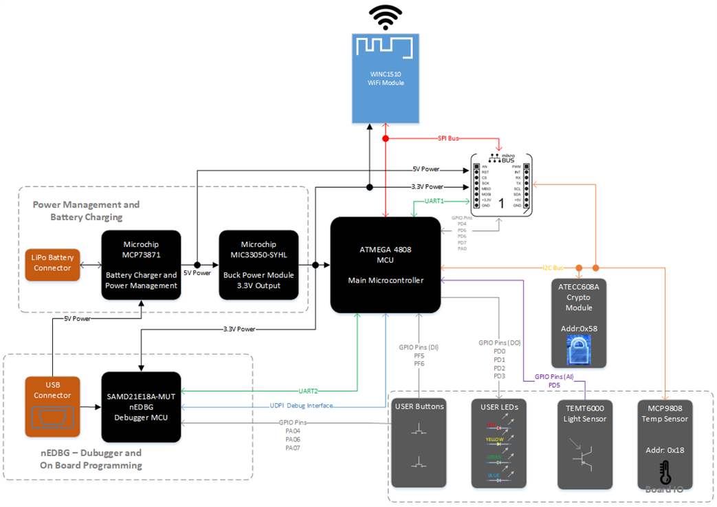

The main processor for the board is an ATMEGA 4808 MCU
2.1 Block Diagram
2.2 Key Components Overview
The following is a summary of the components used on the board :
ATMEGA 4804

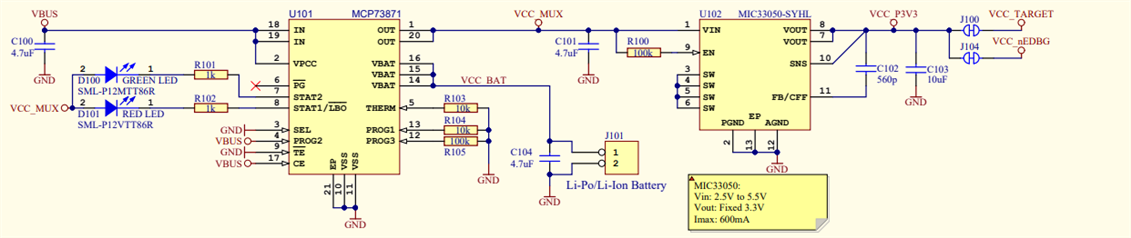

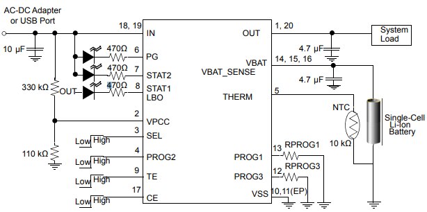

MCP73871 LiPo Charger
MCP73871 LiPo Charger with Power Path Management - Datasheet
This little IC is a fully integrated power management and Li-Ion battery charging solution for small electronic systems.
It will take power sourced both from a wall AC-DC adaptor, USB ports or from a connected Li-Ion battery.
It requires a very low number of components to operate making it great to use on a small embedded board such as this one.
Here is a complete example circuit implementation from the datasheet:
MIC33050 Voltage Regulator
MIC33050 Voltage Regulator - Datasheet
Features
  • Input Voltage: 2.7V to 5.5V
  • 600 mA Output Current
  • Fixed and Adjustable Output Voltage Options
  • No External Inductor Required
  • Ultra-Fast Transient Response
  • 20 µA Quiescent Current
  • 4 MHz Switching in PWM Mode
  • Low Output Voltage Ripple
  • >93% Peak Efficiency
  • >85% Efficiency at 1 mA
  • Micropower Shutdown
  • 12-Pin 3 mm x 3 mm HDFN
  • –40°C to +125°C Junction Temperature Range

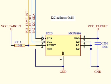

MCP9808 Temperature Sensor
MCP9808 Temperature Sensor - Datasheet
This is a digital temperature sensor that will measure and convert a temperature of between -20degC and +100degC to a digital word with a typical accuracy of +/- 0.25degC and maximum of +/-0.5degC.
It communicates over a 400kHz 2wire I2C bus.
The key features from the datasheet are:
  • Accuracy: - ±0.25 (typical) from -40°C to +125°C
  • ±0.5°C (maximum) from -20°C to 100°C
  • ±1°C (maximum) from -40°C to +125°C •
  • User-Selectable Measurement Resolution:
    • +0.5°C, +0.25°C, +0.125°C, +0.0625°C
  • User-Programmable Temperature Limits:
    • Temperature Window Limit
    • Critical Temperature Limit
  • User-Programmable Temperature Alert Output
  • Operating Voltage Range: 2.7V to 5.5V
  • Operating Current: 200 µA (typical)
  • Shutdown Current: 0.1 µA (typical)
  • 2-wire Interface: I2C™/SMBus Compatible
Here is the Functional Block Diagram taken from the datasheet:

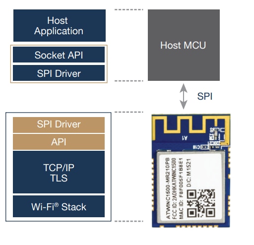

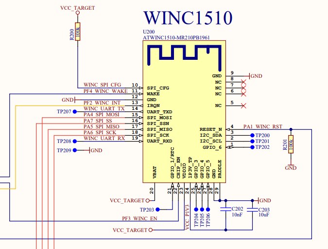

WINC1510 WiFi Module
WINC1510 WiFi Module - Datasheet | Wi-Fi Network Controller Software Design Guide
This component is a Certified 802.11 b/g/n IoT network controller System on Chip.  It abstracts a large portion of the network communications away from the host processor making it much simpler to implement a WiFi base IoT system.
It is especially optimized for low power IoT applications.
It contains a fully integrated power amplifier, LNA, switch and power management and printed antenna.
The module hosts the WiFi Stack, TCP/IP and TLS stacks with corresponding API and an SPI driver.

nEDBG Circuit
nEDBG Circuit

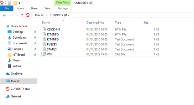

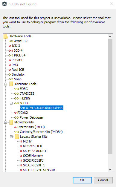

The board features a complete Embedded Debugger that allows on-board programming and debugging.  It has a number of interfaces making it very useful!.....
  • A Debugger - this allows a range of debugging features that can be used from within MPLAB or Atmel Studio
  • Mass Storage - This makes available a number of files such as the public key and a website shortcut to get you connected to the Microchip sandbox account
  • Virtual COM port - this is directly connected to the UART on the 4808 MCU.  This is very useful as it allows some handy run-time debugging messages to be sent from the application and displayed in a suitable terminal emulation program such as PuTTY.
The Embedded Debugger connects to the MCU via the Unified Program and Debug Interface which is an Atmel proprietary 1-wire debug and programming interface.

The board was protected in a small Anti-Static bag
The board itself is very compact

Step 1
Plug the board in to a computer
Step 2
Double click on the CLICK-ME.HTM link on the CURIOSITY drive
This file contains a link to AVR-IOT.com - Microchips sandbox account that will show data received in real time from the board.
<meta http-equiv="refresh" content="0; url=https://AVR-IOT.com/device/01235779C93D870BFE"/>
Step 3

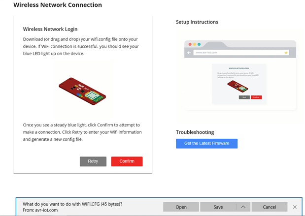

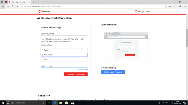

Generate WiFi Connection File
When navigating to the sandbox page initially, as the board is not connected, you are presented with a page to enter the details for a local WiFi network.
Step 4
Once the WiFi details have been entered, you simply click the Download Configuration button to download a small text file containing the WiFi connection details.
You save this file to the Mass Storage drive which then loads the Wifi credentials into the MCUs EEPROM

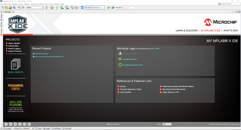

Step 1

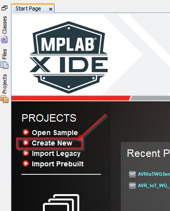

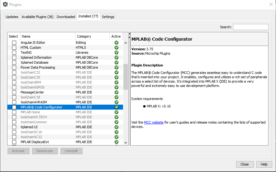

Step 1 - Open MPLAB X IDE

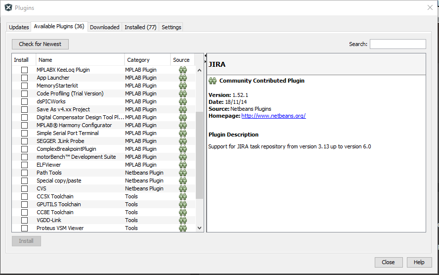

When I first opened MPLAB X IDE, I was presented with the Start Page that has some quick links on the left and allowed me to sign in to my Microchip account.  It Also shows a summary of recent projects.
to go to the next step, I had to have the Microchip Code Configurator Add-In downloaded and enabled.  To install this, I clicked on Tools->Plugins then choose the Available Plugins tab, found and selected MPLAB Code Configurator, then clicked install.
As I had already installed it when I took the screen shots, it does not show up in the screenshot above - instead it shows up in the Installed Tab:
So far, so good!! image
Step 2
Create New Project

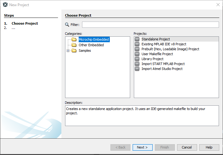

I next clicked on Create New in the Startup Page
and then left the standard selections of Microchip Embedded and Standalone Project

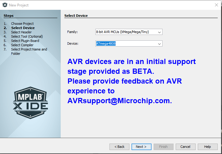

Choose MCU
Next I selected the MCU that is on the board - 8-bit AVR MCUs (XMega/Mega/Tiny) and then ATmega4808

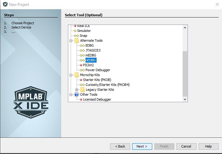

Choose Debugger/Programmer
I then chose the debugger that is part of the board - the nEDBG.  This is under the Alternate Tools tab.

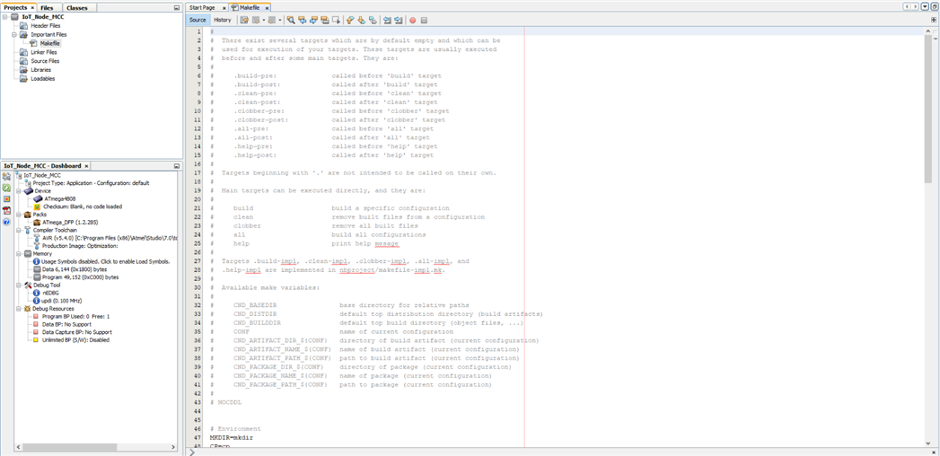

Step 6
Choose Project Name
Finally for this part of the set up, I chose the Project Name and Folder location.  I called it IoT_Node_MCC for easy future reference:
Once this was done, a bare bones project was created - at this point there is only a basic Makefile and a basic project configuration.

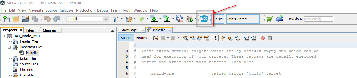

I clicked on the MCC icon on the tool bar to invoke the configurator....

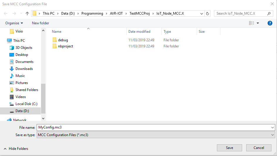

I then got a dialog to save the MCC project file..... for this I chose the default filename and location.

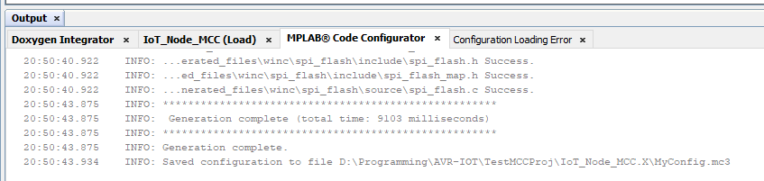

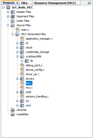

I now clicked the Generate button in the Project Resources pane to create the code from the MCC project set up.
Once complete, I had a Generation Complete message in the MPLAB Code Configurator status pane.
To check the file generation, I had a look at the Project Tree Pane where I could see the various project files.....
I thought the folder organisation is actually pretty good - it is well structured and easy to navigate.

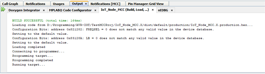

Building and loading the project is very simple - you simply click the Make and build icon....
and then chose Make and Program Device Main Project.
I was asked which debugging tool I wanted to use - my board was already plugged in, so it showed up with the serial number in the list under nEDBG....
I selected this, click OK -
The compiler then compiled the program, once it was compiled it was automatically loaded to the board.

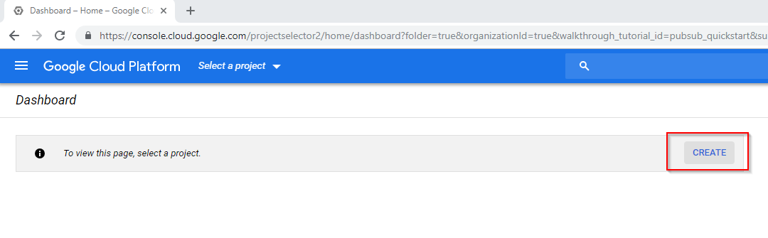

Create Google Cloud Project
Within the Console, I first clicked on Home to open the Dashboard
and then clicked on CREATE to begin a new project.
I then gave my new project a name and clicked CREATE.

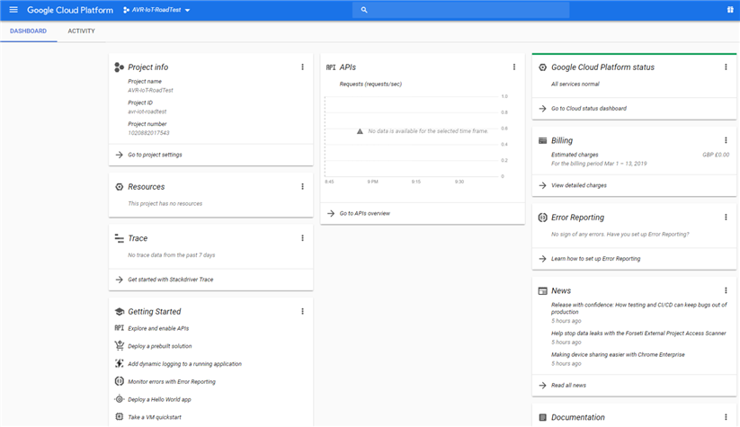

It took a few seconds to create the project, but once it was created I was presented with a range of widgets on a dashboard to give a project overview
On the Leverage instructions, it states that you need to enable billing for the project.  In my case as I am the billing administrator on one billing account, this new project was automatically linked to my billing account.
When I set up my Google Cloud account up, I had to add my card details to enable billing - as I have the free credit and am only running basic functions, I had no concerns I would get any charges.
You can see the status of your account at any time by going to the GCP console menu and selecting billing.

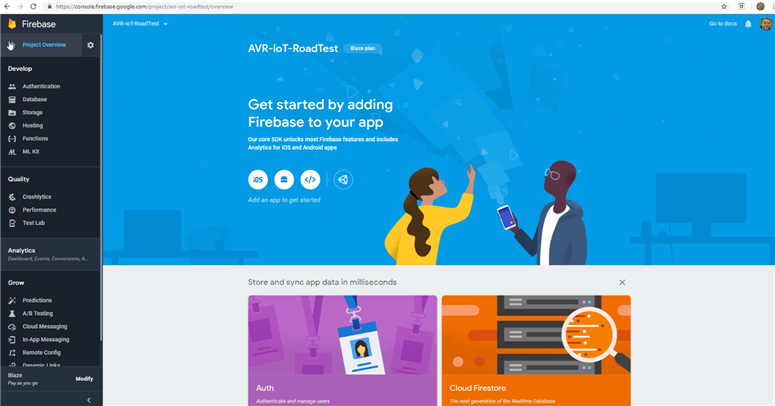

Create Firebase Project
I navigated to the Firebase console and clicked on Add project
I then had a dialogue where I added my Google Cloud Project just created to Firebase.
Once I had selected to accept the terms, the Create project button changed to Add Firebase and became clickable.  Once clicked, a dialogue opens to confirm the billing plan.
Once I had clicked Confirm Plan, the project was created in Firebase and the dashboard opened.

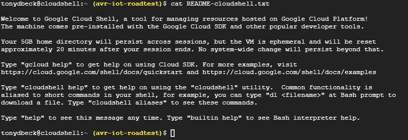

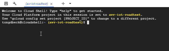

I first activated the Google Cloud Shell which gives a command line access to configure your project. I did this by clicking the CLI button in the tool bar.....
This then opens a command line shell at the bottom of the page.
This is quite a neat and powerful feature.  The Cloud Shell evironment is a Docker Container that is started from a Google-maintained image.  It is also possible to create your own Docker image and use that!
There is a README file located on the folder that contains the following:

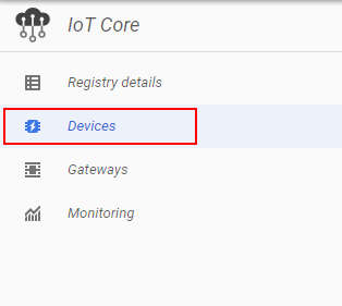

Step 6
Add Device Public Key to IoT Core Registry

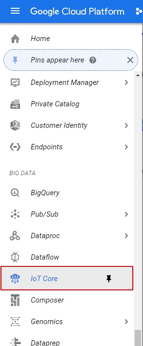

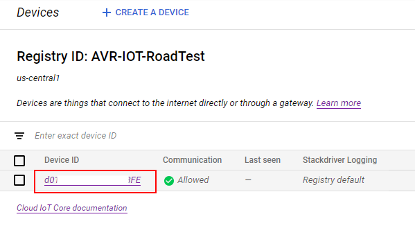

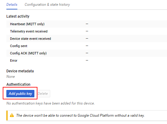

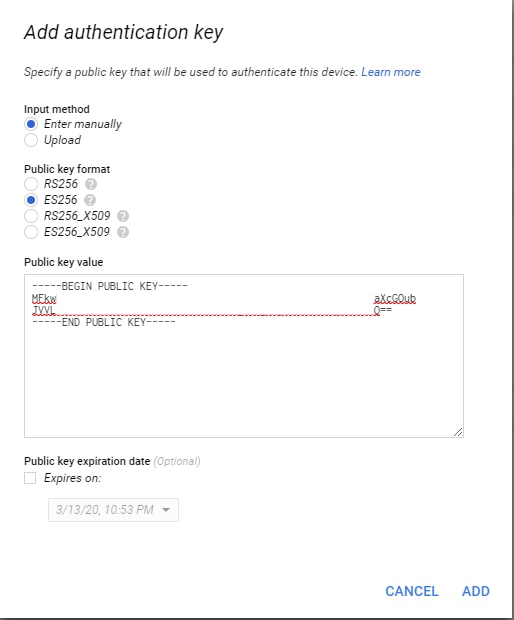

To allow my device to talk to Google Cloud, I need to add the Public Key to my account.  To do this, I selected IoT Core from the Google Cloud Console Menu.
Then selected my registry that had been created.
Then selected Devices
And then selected my device that had also been created.
From there I could see the option to add a public key
The key is contained in the PUBKEY.TXT file on the board.  I simply copied the text from this and pasted it into the Add authentication key dialogue.
I had to also select ES256 as the key type as it is a key based on Elliptic Curve Cryptography.

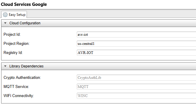

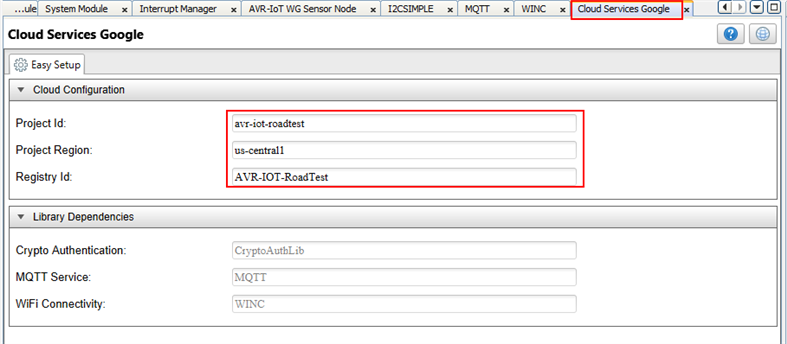

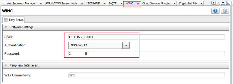

First with the MPLAB AVR-IOT project still open, I had to re-open the MCC from within MPLAB by clicking the MCC button on the toolbar.
Then, in the Cloud Services Google tab, I entered the corresponding details for my project.
Then, in the WINC tab, I entered my WiFi details so these would be saved in the firmware.

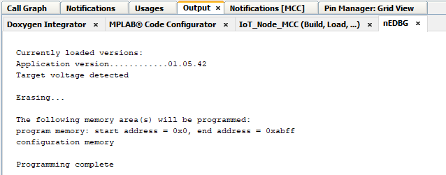

Click to build and load the project.image
Once loaded successfully, I saw the following in the Output and nEDBG panes:

Top Level Application Files
Top Level Application Files (shows up in the second tab)
