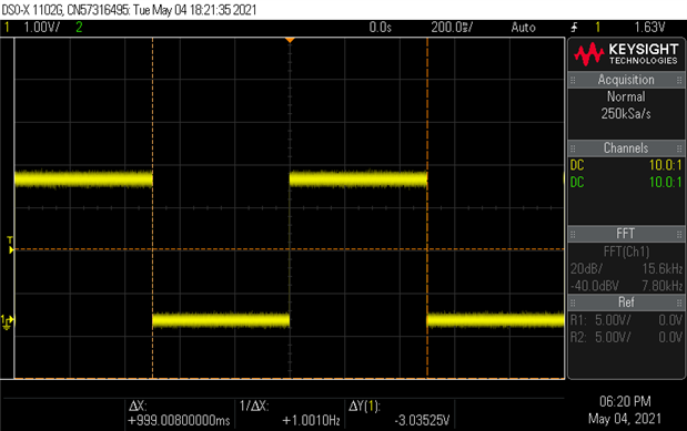

Square Wave
The RTC has a 1Hz temperature compensated square which is shown in the screenshot from my oscilloscope below:  Accuracy is 1ppm/V according to the datasheet.
Summary: The oscilloscope shows 1Hz as expected.

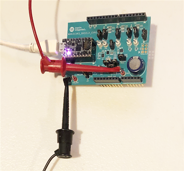

The MAX31343SHLD# can be set to supply power from an onboard Super Cap or external battery upon power failure.  The jumper settings on JU2 are changed according to the diagram shown below:
Credit: Maxim MAX31343SHLD# User Manual
The tests for external battery backup were performed as follows:
  • Jumper changed to VBAT and battery simulated with a Multicomp Pro MP710086 DC Power Supply set at 3V.
  • To start, MAX31343GUI was powered from USB with the GUI Shield Software running
  • USB unplugged
  • After ~10 seconds the USB was plugged back in
  • When the GUI software stabilizes the time on the PC is compared to time on GUI
The Shield is shown below setup for the battery backup test with power coming in through the mini-grabbers.
The experiment were run several times and the MAX31343 maintained time without issue on the power supply simulating a battery.
The test was repeated but by charging up the super capacitor with the power supply to 3V (rated at 5V5) and changing the jumpers to back up from the super capacitor. Note that the MAX31343 has a trickle charger that can be used instead of a power supply to charge the super capacitor or a battery but this was not tested.
The MAX31343 was run for 1 hour on the super capacitor backup and maintained time with the voltage falling from 3.018V to only 2.969V.
