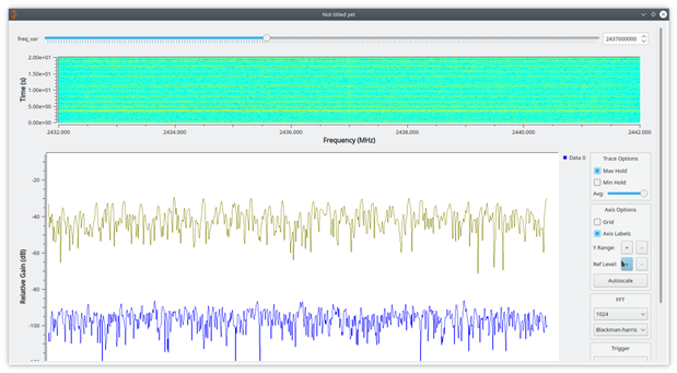

Once that was installed I fired up GNURadio-Companion which is the GUI based radio system design tool and made a quick spectrum analyser application.  I plugged the B205 into one of my USB 3  ports and ran the application, but alas, an error.  GNURadio reportsnit cannot find any hardware.  I'm quite familiar with the Universal Hardware Driver (UHD) which sits between GNuRadio and the USRP devices so I knew where to look, but you'd need to go googling if not.  On the command line I used the low level uhd_usrp_probe command which lists all USRP devices found on the system or network.

Finally I looked at the WiFi from my laptop. you can't see this very clearly in the frequency plot and I think I would need 20MHz bandwidth to see the whole transmission but you can see the bursts as bright horizontal lines in the waterfall very clearly.
