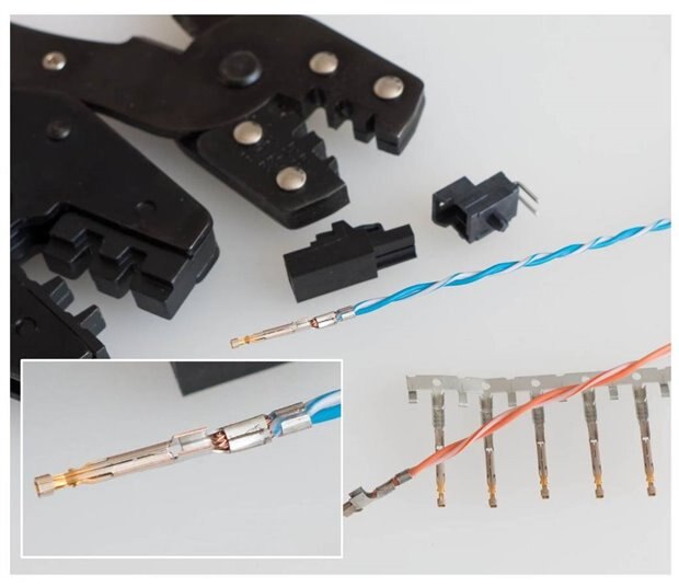

    I am about to buy a crimping tool for 0.1” DuPont and JST type headers and pins but don’t see the PA-09 mentioned above in the stock that Newark carries.  They do have the  Multicomp HT-225D however.  Do you have a preference for one or the other of these two?

    I recently purchased a PA-09 too for the smaller crimp connectors, and have to agree, it is really nice! I was initially worried because it looked like the lap-joint tools used in all bad in-car entertainment installs : ) but it is a compact tool and very precision cut, which give very successful crimp joints each time I used it. Thanks for the recommendation!

  • I'm already sorted for crimping headers, JST connectors, etc., thanks. I'm happy with and can recommend the Engineer PA-09 or PA-21.
    I can't believe that only a year or so ago I was still making do with a small pair of pliers! Definitely a worthwhile tool to have.

    For 0.1" header pin sockets (and similar style) I'm using a Multicomp toolMulticomp tool. it works really well, and low cost. (photo below)
    But for ring/spades a duratool crimperring/spades a duratool crimper. The latter is just average. I waste at least one crimp each time I use it : ( I need to find a much better alternative. For ring/spades I suspect the cost is justified in buying a more expensive tool, to get a more reliable join more often.
