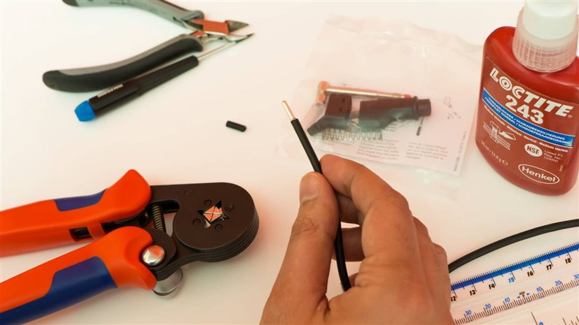

I needed some custom test leads recently and after experimenting with a few types of banana plugs and cables I found a nice combination and set about assembling them. This short blog post contains a possible recipe, i.e. what worked for me. It was also an opportunity for me to use a ferrule crimp tool. The end result was good – it appears to be a reliable set of test leads. (For innovative ideas on test probes, see here: Shop Tips -  Intrusive Meter Probe  ).
In the end I went for stackable banana plugs for my particular need, and they also have a retractable sheath to prevent accidental shorts. Internally there is ample room to fit the 4mm overall diameter cable that I wanted to use. The entire parts list is further below.

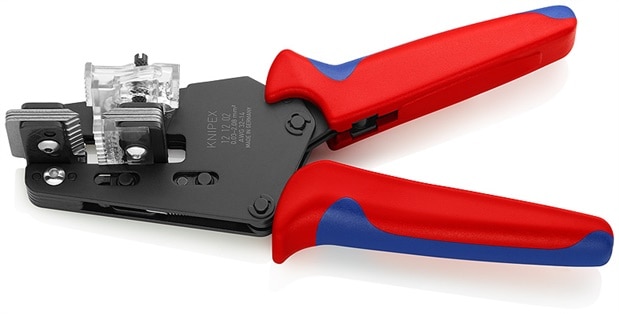

Ordinarily I’d use a wire stripper for cable stripping but this 4mm cable wasn’t something I normally use; it has hundreds of very thin copper strands and a very thick and soft plastic insulation for extra flexibility and therefore I was worried about the risk of nicking copper strands with the strippers I had (electrician’s wire strippers which are designed for solid core wire of certain sizes).
Since I wasn’t making many lots of leads it was very easy to gently slice at the insulation with a scalpel, bend the wire slightly to confirm that it hadn’t reached the copper core, and then dig a fingernail into the insulation and tear apart the insulation. After that the wire was twisted back into its original lay. These Knipex wire strippersKnipex wire strippers would possibly make the job a lot easier; this style of wire stripper does not rely on the strength of the insulation.

Applying the Ferrule
The wire has more than 500 strands; I wanted all strands to be captured and attached to the banana plug. I therefore made use of the Knipex Crimping Pliers reviewed here and a sleeve-less ferrule. The result was perfect, every strand captured. For this type of extreme multi-stranded cable the ferrule is essential otherwise the strands will just bunch on either side when the screw is tightened.
Attaching the Banana Plug
The user instructions for the banana plug specify that 6mm of wire needs to be bared; the ferrule exposes more than that so it was measured with a ruler and the excess was cut off with wire-cutters.
The banana plug shell is in two pieces and the cable was threaded through the rear piece.
Next the cable was inserted into the screw terminal and held in a centred position until the screw was tightly fastened. To keep it from working loose over time, thread-locking adhesive can be applied before the screw is tightened. I tightened very firmly since there was no chance of the strands breaking up under the crush of the screw, due to the use of the ferrule.

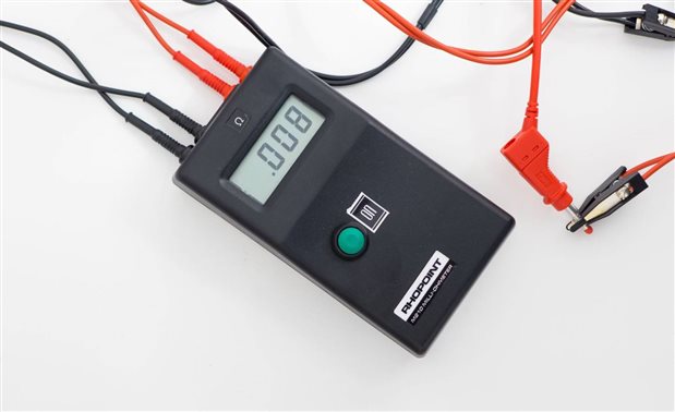

As an electrical check the resistance was measured. Of course, for many measurements the precise resistance (or having very low resistance) does not matter, but for want of measuring something, the resistance was measured. The two banana plugs at either end, plus 140cm of cable (which alone has a resistance of around 7mOhm) totalled 17mOhm (checked with a 2-wire and a 4-wire measurement; the 2-wire measurement had the banana plugs inserted into the multimeter, i.e. how the test lead would ordinarily be used. For the 4-wire measurement a dedicated resistance meter model M210resistance meter model M210 was used).  It was concluded that the resistance was as good as many typical test leads, some in fact have a much higher resistance.

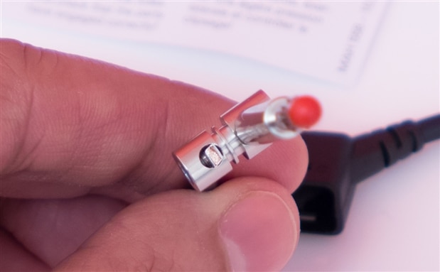

    Hi Enrico, Thanks! I make quite a few test leads now, although it can take time initially, I find that I learn more about materials and cable joining methods. Here is a photo of some different ones: The…
    The banana plugs in the photo have a hole for soldering the wire and were intended for 1.5mm2 wire, so I needed to drill (to 2.0 or 2.1mm diameter I can't recall) the holes to make them bigger to fit 2mm2 wire, but it results in a thin wall so I drilled deeper (into the square part) which worked great. It does need a fat soldering iron though, lots of heat! The resistance of these leads is extremely low (5mohm total for two banana plugs and 60cm of cable), but a lot of effort to drill very centred. To solder the wire I first tinned it, then applied solder paste into the hole, pushed the wire in, then when heating I also supplemented it with some additional solder wire into the hole.
