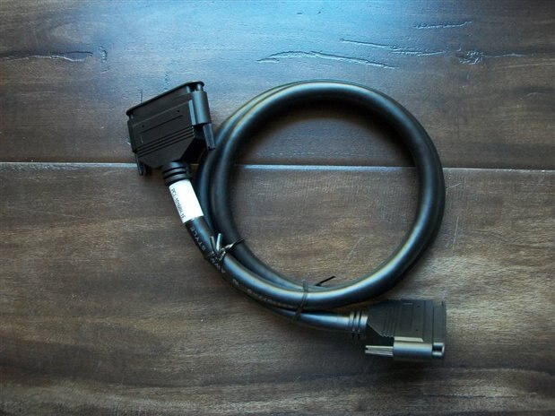

The bag contained a 68-pin SCSI-68 cable with part number PCL-10168H-1E printed on a label.

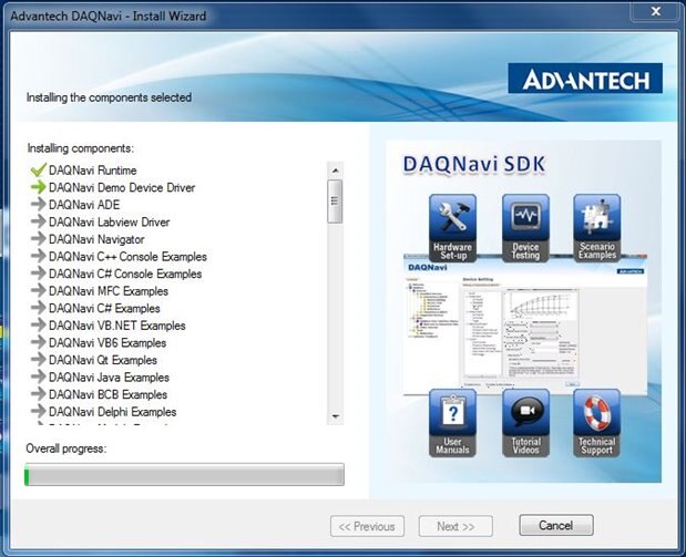

Next I started the software installation by first inserting the DVD that came in the package, which took me to the driver installation screen:
Actually, both the driver and DAQNavi software are on this DVD, so I could choose to install only the driver or both the driver and DAQNavi.  I decided to select “DAQNavi Windows All Products”, which took me to the installation of DAQNavi SDK, DAQNavi driver, Datalogger, Multimeter, and Updater.
Installation has started and a screen window showed me one by one all the software components that where installing.
This installation process took a while and I was happy in the end when I saw all the components with a green checkmark.

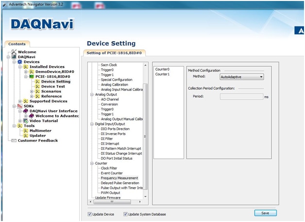

I then wanted to see if I installed correctly the PCIE-1816 DAQ card, and I started the Advantech Navigator from the startup menu.  In the left side I found my PCIE-1816 DAQ card listed, and I also found a “Demo Device”, which is good to have in case anyone wants to explore the DAQNavi features before buying a DAQ card.
In my case I selected the PCIE-1816 card and on the right side screen I got a control panel with four waveform display graphs.  There are five tabs at the top that select and configure each of the main functions of this card: Analog Inputs, Analog Outputs, Digital Inputs, Digital Outputs, and Counter.
I briefly went through these selections and configurations to make sure my the PCIE-1816 DAQ card is functions, and all my experiments proved that I have installed the card properly and that it functions correctly. Here is an example of the Analog Output panel:

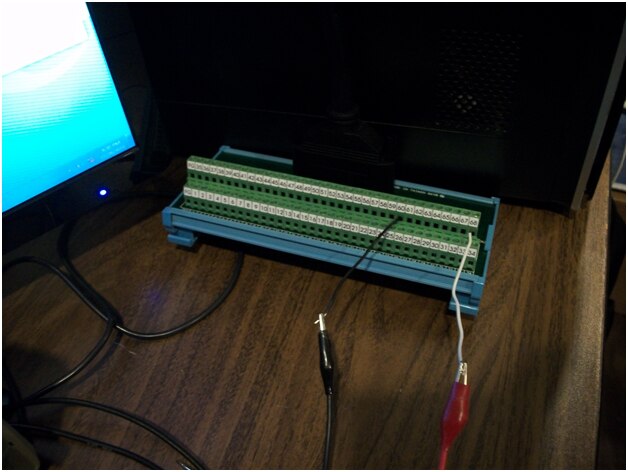

After mounting the PCIE-1816 DAQ board in the computer and installing the DAQNavi software I started with a simple measurement of a DC voltage source.  First I had to configure the inputs of the DAQ board, and I found quite useful the “PCIE1816_User_interface.pdf” document, in which I found “visual” diagrams showing how to connect signals to the DAQ board inputs, like the example below:
Based on this diagram I connected my voltage supply to AI0 at pin 68, and I used pin 60 for ground:

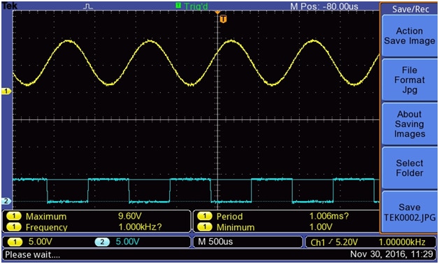

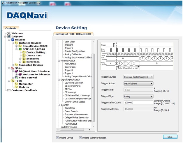

Next I evaluated external trigger functions of the Advantech 1816 DAQ card.  Again, I found very useful the “PCIE1816_User_interface.pdf” document, which shows in simple to quickly understand the connections for external analog and digital trigger:
The rest of trigger settings I have done in DAQNavi settings panel, which uses a great graphical interface to quickly show how the trigger works and what each setting means.  The panel for setting the digital trigger is shown in the screenshot below:
And for the analog trigger:

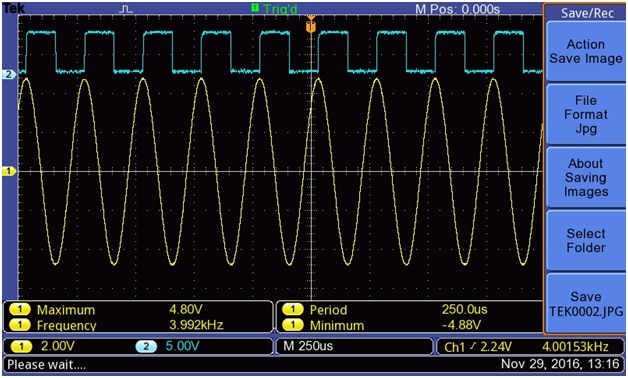

I have looked at various waveform frequencies and trigger settings; here is one example with digital trigger:
And the corresponding input signal (yellow) and trigger signal (blue):

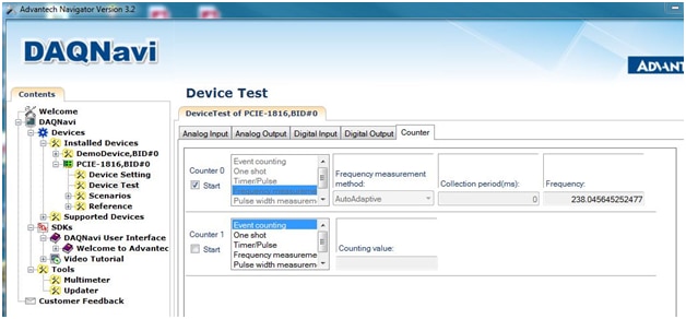

Next I setup the 1816 DAQ board counter to measure the frequency of a digital input signal.  The counter can perform various other measurements like: event counting, one shot, timer/pulse, pulse width.  In this experiment I chose to measure the frequency of a signal provided by an external frequency generator.
Here is the DAQNavi measurement panel:
The measured frequency was 238Hz, and the same signal frequency measured with the oscilloscope was also 238kHz, as shown in the picture below:
