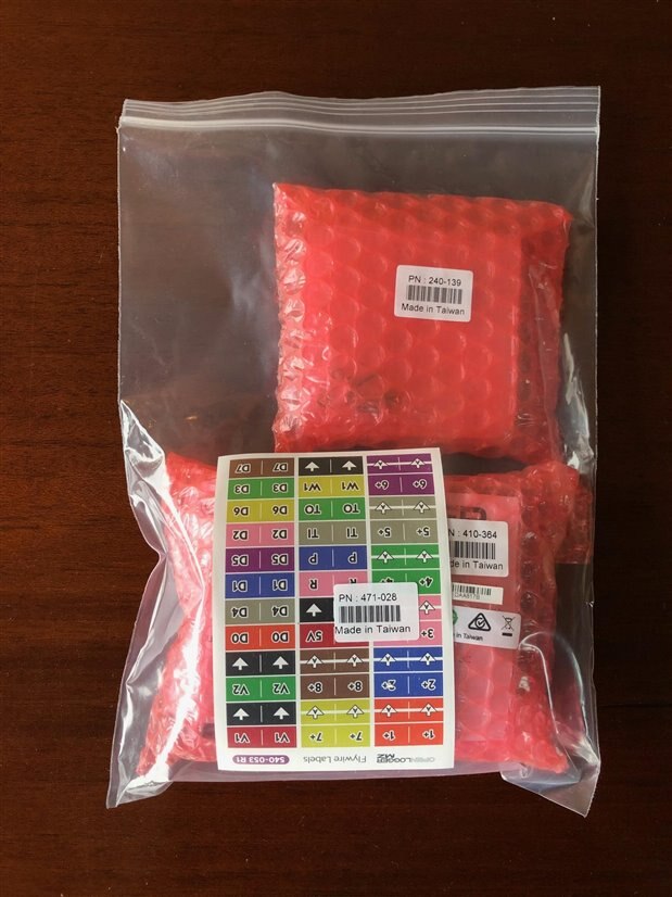

Unboxing
The instrument came well packaged and undamaged in a plastic bag surround by packing material inside a Newark corrugated box.
The parts are spread out below:
The package included:
  • Getting started instructions
  • Flying leads
  • Acrylic enclosure parts
  • Hardware for enclosure
  • OpenLogger
  • Flying lead tags
UPDATE:  Element14 sent me a package with the screw terminal adapter a few days after starting this review.  Thank you! The screw terminal adapter is a worthwhile option in my opinion.

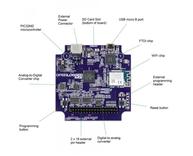

Overview of OpenLogger
The OpenLogger was originally a stretch goal of the OpenScope Kickstarter project.  It evolved into a separate project according to this Digilent blog post and the OpenLogger Kickstarter was funded in January 2019.
Digilent made an OpenLogger new product announcement on their blog April 11, 2019.  The most recent firmware on Github is Version 1.2.0 dated May 30, 2019.  However, the latest version loaded by the Digilent Agent is Version 1.3.0 so Github does not appear to have been updated.  Waveforms Live was last updated November 2019 as documented here.  The changes were Cloud logging, log on boot, save console logging behavior between uses, bug fixes, and some changes that appear minor.  The log on boot was an important addition for data logging for my use.
The OpenLogger is based on the PIC32MZ with separate ADC and DAC.  The ADC is an ADS8332IBRGE.  The DAC is a resistance ladder with Microchip MCP6H91-E/SN Op Amp.  The WiFi is an ATWINC1500-MR210PB1952.  A schematic is available here.  The annotated overview below of the instrument was taken from the Digilent website.
The OpenLogger hardware and firmware are marketed as being open source.

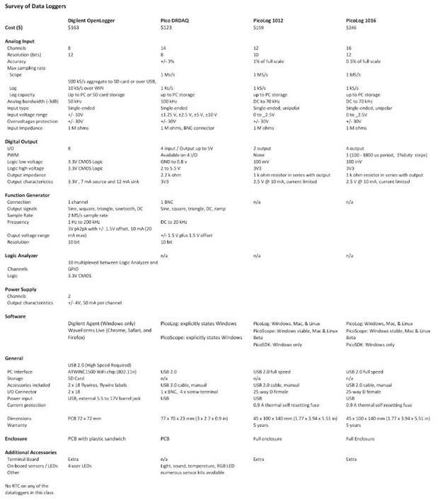

Market Comparison
Pico also makes data loggers and a comparison to the Digilent OpenLogger is shown in the table below (click to enlarge).
The Digilent OpenLogger compares well feature and price wise but software performance is a determining factor for this type instrument.  Since the Pico instruments were not evaluated and a software comparison made the relative value was not determined.
Another option might be microcontroller based daughter boards like the Adafruit Data Logging shield for Arduino  which while having resolution and voltage limitations does have a real time clock.

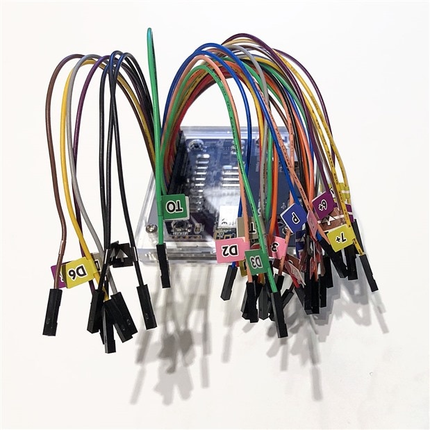

RECOMMENDATION:  Install the case before calibration which I did not do.  The flying leads must be removed before the case is assembled and the connection to the flying leads was quite tight.  The PCB was flexing even though the leads were removed slowly and evenly.  No damage was done but still removal and replacement should probably be minimized.
The case is fiddly to assemble but the instructions are clear and it went together without incident.
The tags for the leads took a while to attach and though taking care not to place them wrong I still put one in the wrong place.   Pulling the adhesive apart is impossible so I ended up cutting it and then reattaching it in the correct place with sticky tape.

Before going further, a word about the flying leads.  The leads are handy for breadboard activities and students but more robust connections are desirable for many activities and a daughter board with screw type connectors is available.  Below is a representative setup using a breadboard and the flying leads.  I find the flying leads difficult to sort through and prefer the connections made by screw terminals.   Fortunately Element14 provided a screw terminal adapter which arrived after the RoadTest began but in time for most of the testing.

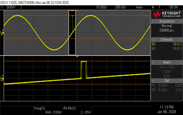

The waveform generator (and a number of the other features) cannot be adjusted on the fly.  It is necessary to stop streaming / datalogging  before making changes.  The waveforms available are sine, triangle, sawtooth, square, and DC.  Frequency, amplitude and DC Offset can all be adjusted. A control panel screen shot is shown below.
After starting up the Wavegen at the default setting in the panel above a clean signal is seen.  But immediately upon starting streaming of the OpenLogger inside Waveforms Live a glitch occured which can be seen in the screenshot below from Waveforms Live.
The glitch was observed only on the first attempt after start-up and disappeared when the Wavegen and Streaming were turned off and then on again.  It was reproducible whenever the OpenLogger and Waveforms Live were started anew (but again disappeared when Wavegen and Streaming were restarted).  The screenshot below from the Keysight oscilloscope shows the glitch zoomed in.
If the Wavegen is turned off and then restarted inside the same session the glitch disappears as shown on Waveforms Live below.
Most of the time things behaved more or less as expected although there was lag noted in the controls.  The browser interface is not overly responsive.  This behavior is shown in the videos below.  There were also times where things froze completely and the browser needed to be restarted.

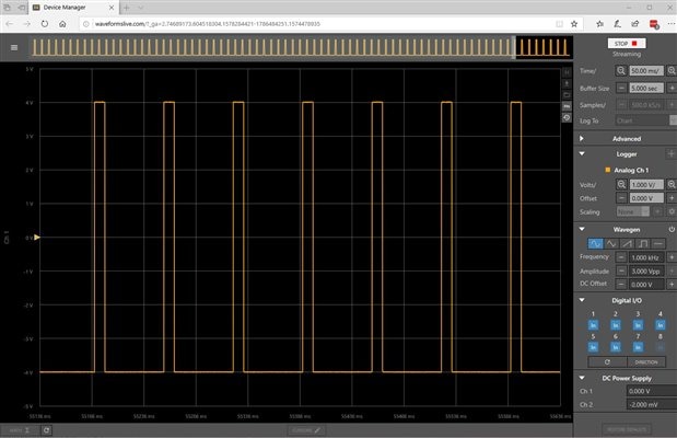

The test setup for datalogging is shown below and used the screw terminal adapter.  The Keysight DSOX1102G was used to generate a 10 ms pulse from -4 V to +4V which is displayed on Waveforms Live and on the oscilloscope.
In the photo above the pulse is being fed to two channels of the OpenLogger.  In the screenshot below Waveforms Live is displaying a single channel.

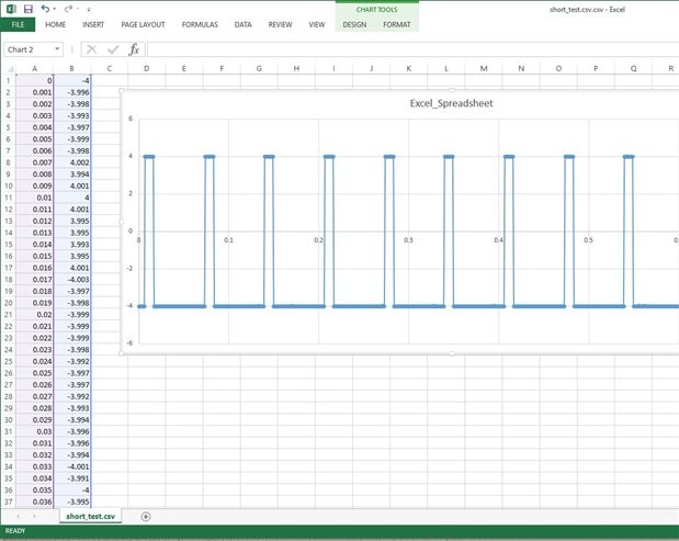

During datalogging output to the SD card is made in a binary compressed format that cannot be read directly in other applications such as a spreadsheet.  There was not a converter when the firmware / software was first released but subsequently an executable that can be run from the command line was released which will convert the binary file to a comma separated value (CSV) file.  The conversion instructions are described here.
It is also possible to directly export CSV files from Waveforms Live using the button circled below and the flyout input panel although I did not see it mentioned in the tutorials.
On the first attempt to log data the default values in the data logging entry form were used and logging left running for quite some time (minutes).  This resulted in a binary log file of size 434 MB.  When the converter was run it grabbed 15.9 GB of memory on a 16 GB memory machine and took a very long time to convert (on a very fast machine).  The resulting csv file was 3.2 GB.  This made the data difficult to analyze so pay attention to the samples / second when setting up to log data.
The input panel settings were then changed to 1000 samples / second and saved into a new file called Short_Test for 5 seconds.  The resulting file was 14 KB (much more reasonable) and the csv file was 87 KB. The csv file was opened up in Excel without issue and plotted to demonstrate the integrity of the data.
Summary:  The data is not timestamped which would be nice and imperative in some applications.  Data can be captured on a SD card, moved to the computer, and converted for use via a command line executable. Data conversion for large files is not efficient for very large files but does work.

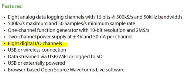

Digital I/O
The marketing material says this (yellow highlight added) about digital I/O:
The training material says this:
Since the control panel does have the digital I/O panel I tried it anyway and found that it is not implemented.
Summary:  While the marketing data states that there are eight digital I/O channels, the instructional material states that it has not been implemented in software and a test showed it not to be there as well.

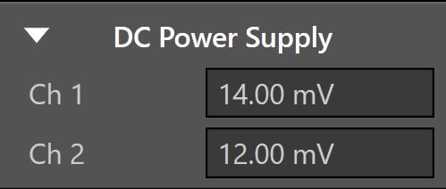

DC Power Supply
The OpenLogger has two DC power supplies that can provide plus or minus 4V and up to 50 mA per channel. The input panel is shown below.
Input is done by typing in the desired value.  After input the panel reads back the value – in the default case above values of 0 V were entered for both channels and the measured output is displayed as 14 and 12 mV.
Limited testing was done. The values for each channel were set as shown in the table below and checked with an Extech EX330 multimeter. All values in Volts.

00.0140.01000.0120.009
11.0091.00011.0111.002
22.0061.99022.0011.994
32.9982.98032.9932.987
43.9953.97143.9983.980

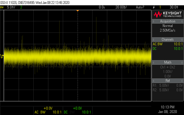

A screenshot from the Keysight DSOX1102G showing output noise with Channel 1 set at 4 V with a 100 ohm resistive load (40 mA being delivered) is shown below.  The major vertical divisions are 5 mV and time base is 20 ms / division.
Summary:  The DC power supplies were not tested extensively but look acceptable for an instrument of this type and where no more than 50 mA at plus or minus 4 V is required. It is nice that there are two channels. Current is not displayed and there is no current limiting. As will be seen later, the DC power supply does is not remembered when logging from boot up and thus is not available.  This would seem to be an omission that could be added in a future software / firmware update.

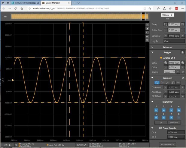

Math and Cursors
The OpenLogger is capable of setting cursors and providing some additional information on a waveform called math. The input panel for cursors is located at the bottom center of the WaveForms Live window and looks like this:
Cursors can be set for time, “track”, or voltage and can be moved about with the mouse.  These settings are rudimentary but work well enough. It is not possible to independently move both time and voltage settings.
The math input panel is shown below and is located at bottom left of the WaveForms Live window.
These are not the traditional math function of an oscilloscope but rather various measurements taken from the waveform / trace.  If selected, the measurement is shown at the bottom of the Waveforms Live Window.  Unfortunately the software has a bug and can produce erroneous results as described below.
The following is a screenshot from the Keysight DSOX1102G which is producing a 100 Hz, 2 Vp-p sine wave to be read by the OpenLogger.
And here is a screenshot from the OpenLogger that shows the problem:
It is hard to read but the frequency is shown to be 250 Hz when it is actually 100 Hz as demonstrated by the oscilloscope and by counting time divisions in Waveforms Live.  There is a forum entry posted July 2019 on the Digilent site explaining the problem.
If insufficient time is given for the math function to process the buffer, which is more likely with a large buffer, then erroneous results can occur. Unfortunately the errors are posted without warning that the calculation was not completed.  It is possible to get accurate answers by using a smaller buffer or by stopping streaming early as shown below:
Summary:
The cursors are rudimentary but work.  There is a bug associated with math that allows it to make erroneous reports without warning to the user which will be demonstrated in one of the videos that follows.  The math functions are actually measurements of frequency, amplitude, voltage, etc. If the sample size is small enough and sufficient time is given then the math function gives correct output.  Math function output should disappear along with the cursors when streaming is started up again.
While not demonstrated here there is a scaling feature in the channels menu that allows simple multiplication by a factor which is useful for say using Ohm’s Law to convert voltage to current across a known resistor.  This was tested and works.

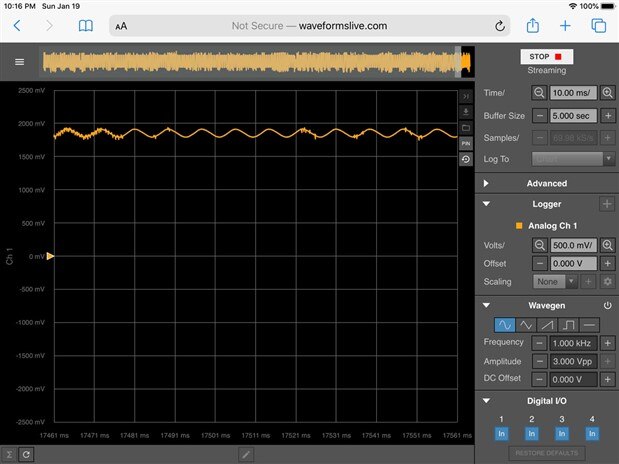

The OpenLogger had more difficulty obtaining a reliable WiFi connection in my lab (which is located some ways from the network connection) than other devices I commonly use there.  By placing the OpenLogger closer to the router a reliable connection was obtained. There is a WaveForms Live app for Apple devices that was successfully added to an iPhone and an iPad.  However, WaveForms Live would not open up and show the OpenLogger in either device and gave the message "No Response Received".  Perhaps it is for the OpenScope and was not implemented for the OpenLogger.
It was possible however to connect to the OpenLogger through an iPhone and iPad using a browser and advice from the Digilent forum.  The WiFi connection was set up over a PC and the IP address recorded.  The screenshot below is from an iPad displaying the first channel from the Demonstration Project which will be described shortly.
My experience was that the sample rate needed to be quite low in order to keep from losing data and the connection dropping out and similar issues are reported on the forum.  The example above is at 60 kS/s.  Controls were not reliable and this method is not recommend for anything other than monitoring output at the lowest rates with a tablet.  Control is best done using a USB connection.
Summary:
It is possible to observe data from the OpenLogger using WiFi but only at low sample rates using a browser connection.  The connection was easily dropped.  The controls were not useable with a tablet and it is recommended that be done over USB.

    I wrote this RoadTest as I completed each section and it stretched over an extended period of time which is probably the cause of confusion. This approach does accurately reflect what I was thinking at the time I was evaluating however which hopefully is of use to Digilent.  The Summary and Conclusions section is admittedly brief.  When an issue was encountered I did a search of the forum to see if others had encountered it.   This was often the case and where something was found the solution, discussion, or still open issue was linked.  The software appears to be the cause of the issues although there may be underlying hardware limitations I am not aware of.  Below is a summary list of issues and areas of improvement.   They have been included in a RoadTest update as suggested.
    Marketing Features not Implemented
    • Digital I/O
