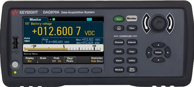

Keysight DAQ970A Signal connection method
The Keysight DAQ970A uses removable multiplexer modules that fit into slots at the back of the chassis.  The unit I road tested previously for element14 came with  DAQM901A 20 channel armature multiplexer.  Signal wires are routed through an opening in the back of the module to screw terminals situated between two banks of relays on the surface of the modules PCB.  The images below illustrate signal connection to the DAQM901A module.  In this illustration three thermocouples and four two-wire signals (bundled in a single CAT5 cable) are routed to the terminal blocks.  In this example, 7 of the available 20 channel inputs are used and the routing path out the back is already getting crowded.
To add, remove, or preposition a signal, the logger is powered down, then the module is removed from the back of the chassis, and the transparent cover lifted.  Signal wires can then be adjusted and repacked for exit out the rear of the multiplexer module.  Although this process is not difficult to perform, it is tedious.  For this instrument it is best to plan your data logging signal requirements carefully in advance to avoid having to repeat the connection set up process.

Keysight DAQ970A Entering an IP address
Don't need to enter an IP address.  The Keysight instrument uses DHCP to get an IP address, then when BenchVue is started, it automatically (usually) enumerates all of the instruments on the network and places them in a graphical image list on the right side of the screen.  Example below.
My preference: Keysight DAQ970A

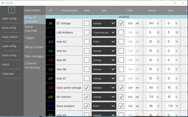

B&K DAS240-BAT
The PT100 RTD sensor presents a resistance of 100 Ohms at 0 degrees C.  The copper cable running from the sensors to the data loggers is about 80 feet (24 m) long.  Copper wire has a small but measurable resistance.  Over an 80 foot run the resistance is enough to add a significant offset to the measured RTD device resistance.  This cable resistance needs to be measured and compensated out of the data logger measurements to obtain accurate temperature readings. To measure the cable resistance I used a shorting bar in the shed and an ohmmeter in the lab.  The measured cable resistance for both runs was about 4.70 Ohms.  The 5k thermistor mounted below the PT100 RTD was not used in the experiments described here.
To provide something of a temperature reference for the RTDs, I placed a wireless temperature sensor near the RTDs.  The receiver was located in my lab next to the loggers.  The wireless sensor only provides integer resolution (no decimal digits), but it gave me a reference when compensating for the wire resistance between the logger inputs and the RTDs.  My plan was to enter the measured wire resistance, then adjust to get the value computed by the loggers to agree with the wireless sensor.  This worked well for the DAQ970A, but the resulting compensation value for the DAS240-BAT ended up well off of the measured 4.70 Ohm value shown above.
To set up input channels on the DAS240-BAT, the Channels icon is tapped form the Home screen, which brings up the rather busy screen below.  The three channels of interest are A8, A9, and A10 detailed in the three columns toward the right side of the screen.
A very nice feature of the B&K DAS240-BAT is the ability to connect a standard USB keyboard to one of the two USB ports along the top edge of the instrument and use the keyboard to enter text or numeric values for menu fields.  It may seem minor, but I think this is pretty much a must have feature on modern test equipment.  The scroll and select menu keyboards that are provided on other tools are error prone and tedious to use at the best of times.  Also, you can connect a standard USB mouse to the DAS240-BAT and use it to control the cursor on the instrument screen.  Because there are two USB ports on the DAS240-BAT, you can connect a mouse and a keyboard at the same time.  I am giddy with delight!
There are a couple of oddities and annoyances in the channel set up menu.  First, you can perform screen captures of some, but not all, screen images.  The camera icon next to the record button is not always available.  For example, when I click on the Type field under A10, a sub menu appears, but I can't screen capture from the DAS240-BAT screen because the capture button is disabled for sub menus.  One work around it to make use of a Virtual Network Connection (VNC) which enables remote desktop use of the DAS240-BAT from a PC.  You need VNC software running on your PC to accomplish this.  I used Ultra VNC (uVNC) available as a free download under the GNU General Public License.  The UltraVNC Viewer application simply requires entry of the IP address for the DAS240-BAT on your network, followed by entry of the VNC password (set up in the DAS240-BAT under the VNC menu button).
The gallery below shows the sub menus selected to set channel A10 for connection to a PT100 2 wire RTD.   The last set up menu is for entering the wire resistance for long cable runs.  I entered 4.70 Ohms, based on the measured cable resistance.  This resulted in a significant error between the wireless temperature sensor value and the value reported by the other RTD connected to the Keysight logger.  I made adjustments until all three values were in agreement and ended up with a wire resistance value of 1.65 Ohms.  Odd, but, whatever, it works.
I will report a minor annoyance here:  The wire resistance sub menu is titled in French (Resistance du fil), even though the instrument is configured for English.  I figured out what the menu was for, however, there are other examples where a clean conversion to English has not been accomplished (example: channels are labelled "Voie" in the set up table).  I am not a language elitist, but these scattered bits of French in an English configuration show sloppiness in the Quality Assurance department.  This sloppiness impacts customer opinion of brand quality.
{gallery} DAS240-BAT RTD submenus
Channel Type sub menu: Selecting the type of sensor/signal
Channel Type sub menu: PT100 details
Channel Type sub menu: Adding a wire resistance value
Now to a more series bug.  The VNC connection only works properly for setting  up some of the channel parameters.  I had success in using the VNC to select a 2 wire PT100 sensor and entering a wire resistance value.  However, I could not get the VNC interface to work properly when trying set a temperature range, Center zero, Max or Min value.  The remote connection provided the correct screen images and I could enter values at the PC, but any changes I made were ignored once I hit the green check mark icon.  This is also true when trying set range, min, max, and center zero for the two voltage channels. Very frustrating.
I resorted to local entry of range, center, min, and max on the DAS240-BAT touch screen.  I noticed that there is interaction between the parameters that is important to be aware of.  Setting a range of say 30 degrees C will automatically set the Max and Min temperatures based on the Center zero setting.  In another scenario, setting a Max temperature will then set Range and Center zero based on the existing Min setting.  Something to be aware of.  I ended up wishing there was an auto range setting because I was dealing with wild temperature swings from -30 C to +10 C in the span of a couple of weeks of logging.  If I set the range too wide I would not be able to see some of the smaller micro-climatic shifts, so I had to frequently adjust the range when temperatures went outside the fixed range settings.  For the experiments discussed here I chose a range of 30 C, Max of +10 C, and a Min of -20 C.

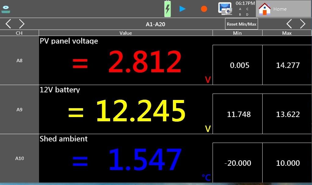

B&K DAS240-BAT
Once the channel parameters are set up and the desired channels selected for viewing or logging, the user has the option of making the logger behave like a strip chart recorder (via the F(t) option), or getting a live numeric update of selected channels (via the Numeric option).  An example of the Numeric mode display is shown below.  This screen shot was taken near sunset, so the PV panel voltage is dropping rapidly toward zero.  The Min and Max numbers appear to be correct for PV panel voltage and 12V battery voltage, however, the Min and Max values for Shed ambient temperature appear to from the values I setup during channel configuration.  A strong plus working in favor of the B&K instrument is the expansive touchscreen.  Look at the size of those readouts!
I have been using the DAQ970A for two months now.  The F(t) mode behaves like an adjustable graphical strip chart recorder and is very useful, but it has a few bugs.  One example is seen in the screen capture below.  The image shows a data log stored locally in the instrument captured over a full week at a sample interval of 100 ms/sample.  The ability to store a weeks worth of data at this sample rate is outstanding.  I could have logged for longer at an even higher sample rate without reaching the limit of this instruments capability. In terms of memory depth and range of sample interval, I am very impressed, however, code sloppiness in the user interface is apparent.  Look at the cursors on the Shed Ambient trace (blue trace).  The availability of cursors is great, but temperature ranges should be labeled as delta T, not delta V.  Oh, and the font size on the vertical axis labels is . . . well, to my eyes, nearly unreadable.
To illustrate the impressive density of data that is included in the example log shown above, I used the "Zoom between cursors" feature to isolate four of the PWM charge controller pulses from the fourth day of the log.  In the image above, the red trace shows PV panel voltage over time.  Each pulse represents one day of sunlight generated voltage.  Once the sun rises, panel voltage increases quite rapidly, and as the sun sets, panel voltage rapidly decreases. On clear days when the sun is unobstructed and the incident angle is approaching perpendicular, the PWM controller can enter a mode where current from the panels charges the battery until a maximum cutout voltage is reached, causing the controller to disconnect the panels. The battery then feeds charge into the loads and battery voltage decreases as the stored energy is depleted.  Once a lower voltage threshold is reached the controller reconnects the panels to the battery.  This charge controller behavior creates the voltage spikes riding on top of some of the pulses seen in the top trace.  Because the sample interval is 100 ms/sample, it is possible to zoom in to a group of individual charge cycle pulses, or even on a single pulse out of hundreds of pulses in the 7 day record. The screen capture from the DAS240-BAT front panel shown below illustrates this zoom in capability.
Without too much fuss I was able to zoom into a group of four charge/discharge pulses on the fourth day of the record.  This particular zoom went from a 7 day view covering 604,800 seconds to a view covering about 20 seconds.  B&K provide a wide choice of tools to interact with data log records.  To achieve the image shown above I first used the touch screen on the DAS240-BAT to position time cursors on the PV panel voltage trace, then zoomed between cursors repeatedly until I had the four pulses in view.  I then used UltraVNC viewer running on my laptop to control the DAS240-BAT with my laptop mouse. I switched the cursor to horizontal mode on the battery voltage trace, then dragged them to the peaks.  The delta V calculation readout was obscured by the trace, so I dragged it over to make it readable.  The only issue I encountered was a flaw with the VNC interface that does not allow numeric values to be entered from the desktop using the mouse to control the virtual numeric keypad.  To enter new range position values (to enlarge the relatively smaller delta V range) I had to use the touch screen on the DAS240-BAT.  In the Remote Instrument Operation section I show how the Sefram Viewer application can be used to explore this same data set on the laptop.
Keysight DAQ970A
Local viewing of multiple data streams is limited on the Keysight DAQ970A.  Options include a text listing of the last sweep values, or individual channel histograms, trend charts, or DMM style numeric displays.  Each option is illustrated below. What is missing, perhaps as a consequence of the small screen, is the ability to look at trend charts for several channels simultaneously on the same screen.  As shown in the screen captures for the DAS240-BAT the ability to examine multiple channels together on one screen supports easy comparison of relationships between system signals.
I have run trend charts on the DAQ970A that last for several days.  The auto scale feature on this instrument  is very helpful in that the scale adjusts as values move outside of the current display range.  The B&K instrument does not seem to have this option.  The Keysight instrument also allows the trend chart time scale to be flipped between "All" and "Recent".  The "All" setting graphs the entire accumulated data record on the screen.  "Recent" shows only the most recently gathered values over a period selected by the user.  The B&K instrument allows fixed time intervals to be set on the trend chart from 100 ms/div to 20 min/div.  With 10 divisions across the screen, this allows viewing the most recent 1 second to 200 minutes of signal activity.  Longer time periods, like the week long record shown above can be brought up on the screen locally once a data logging mission has been completed.

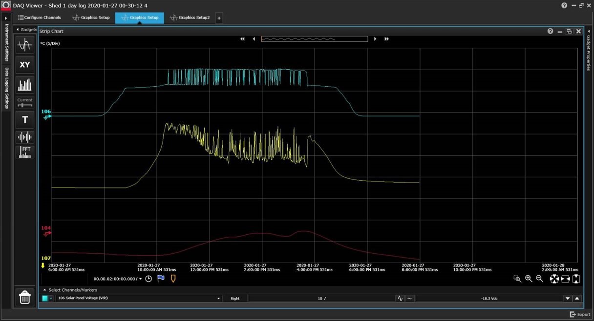

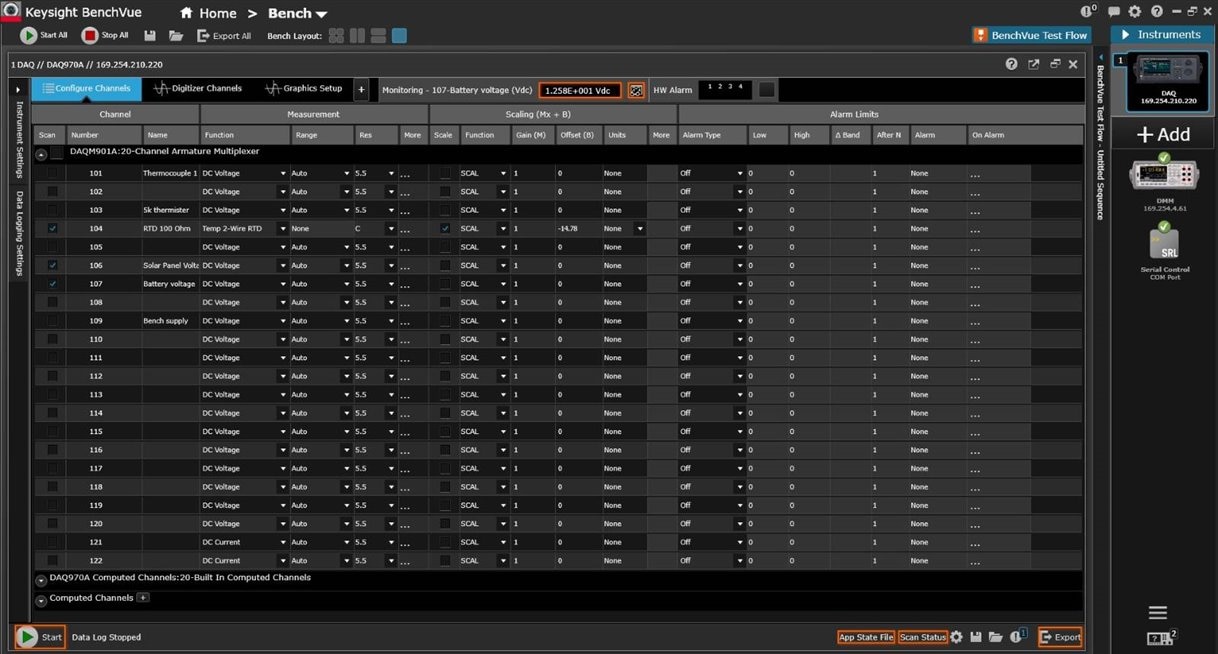

Keysight DAQ970A (BenchVue and LXI Web UI)
Keysight provides a really slick LXI Web UI that supports remote instrument control, just like the remote instrument control that UltraVNC provides for the B&K DAS240-BAT. The differences I notice in the Keysight Web UI are the top notch graphics and menus, the fully functional interface, and (so far) blissfully bug free operation that makes sense to me.  If you want to operate the instrument remotely from a realistic front panel proxy, the LXI Web UI, illustrated below, is recommended.  Simply use mouse clicks to operate front panel buttons, or turn the rotary knob left or right. Commands are sent to the instrument and changes to the screen are reflected on the Web UI on your PC.
Because the Web UI mimics the DAQ970A front panel it suffers from the same limitations imposed by a relatively small screen on the instrument itself.  If you are trying to set up several channels for a complex data logging mission, I recommend using the BenchVue platform instead.  BenchVue is a beast of a platform.  It provides a lot of capability across many Keysight instruments and it can be difficult to master.  I also found it agonizingly slow to load until recently.  I ran a registry cleaner app that removed a bunch of broken links and put a bunch of apps to sleep, including National Instruments software that was slowing start up down considerably.
If you need to set up multiple sensors, configure test sequences involving several instruments, or have a need to upload and analyze data logs, then BenchVue might be a good choice.  Once BenchVue starts and enumerates the instrument array connected via USB or LAN, the user has the option to launch specific instrument applications or to bring up recorded logs for analysis.  The channel set up screen for the DAQ970A allows all channels to be configured via a table array, very similar to the arrangement provided on the DAS240-BAT.
Sample interval is set up under a separate menu. For the data log shown below, I configured the two voltage channels with integration times of 1 power line crossing and the temperature sensor was integrating for 10 power line crossings. Limitations on sample interval range at the lower end are where the DAQ970A with a relay multiplexer module comes up short.  I found that sample intervals under about 500 ms become problematic.  Relays in the multiplexer have a difficult time keeping up with short sample intervals.  Rapid switching accelerates wear on the relays, moving the muliplexer module closer to end-of-life.  The chart below represents one day of activity on the PV system as captured by the DAQ970A.  Panel voltage is on top, battery voltage in the middle, and temperature on bottom.  The sample interval is 1 sample/minute.
The traces have the general shape characteristics I expect and they agree in general with traces I had taken with the B&K DAS240-BAT and before that with my Fluke 287 logging multimeter.  Zooming in on a portion of this log around noon reveals the drawback of using lengthy sample intervals on rapidly changing signals.  See the illustration below. The behavior of panel voltage and battery voltage do not look quite right, especially when compared to the behavior captured by the DAS240-BAT when it was sampling at 100 ms/sample.  There are runt pulses in the panel voltage trace, the pulse durations are very uneven and the pulses lack the sharp switching edges revealed in the DAS240-BAT log.  Traces taken at 1 sample per minute only provide a high level perspective of system behavior.  From these traces you could determine that the battery was being pulse charged and roughly determine when that mode of charging started and stopped during the day, but you could not reliably determine how long each charge pulse was, or the trip thresholds on the PWM charger.  So, the data set is somewhat useful, but it is imperative to be aware of the relationship between sample rate and signal frequency when using a data logger.
To demonstrate that the DAQ970A can capture fine details similar to the detail captured by the DAS240-BAT I set up a short data log mission that took 60 samples at "min value" scan interval. From what I have observed, "Min value" scan interval means the relays will operate as fast as they can limited only by integration time set up on each channel.  Integration time was set to 0.01 PLC on all three channels for the log shown below.  With min interval and short integration times the relays made a lot of chattering noise during the roughly 6 seconds it took to gather this logs below.  However, these settings were adequate for capturing the charge detail that I was looking for.  I can clearly see the PWM behavior on the charge controller and can measure the trip voltages on the battery that cause the controller to switch in and out.  Note that the very short integration time of 0.01 PLC causes the temperature trace to be rather noisy.
Even though the DAQ970A with a relay switch module can be configured to gather data at a rate sufficient for analysis of this particular PV system, the settings stress the relays and it would not be sensible to run a day long mission, or a multi-day long mission at these sample rates.  The B&K DAS240-BAT handles long duration missions at high sample rates with ease and, in general, is a better choice for the sort of work I am carrying out during this upgrade project.

BenchVue provides a much slicker, full featured UI, but it is slow to load and slow to process data logs, even after I optimized my PC.  Keysight has also imposed a pay model in order to obtain updates to application modules.  DasLab and Sefram Viewer are free, but they are also clunky, buggy, and awkward to use.  They get the job done and are quite responsive once loaded.  So each interface has its advantages and disadvantages.  Both need work to make them truly effective and responsive to user needs.

  • The Keysight unit also has a multifunction card and an output relay board that allows an element of control to be introduced into the application that I believe the B&K unit cannot do, other than drive something wth one of its alarm outputs. In general, the expansion boards for the Keysight seem to be more cost effective than the 20 channel input board for the B&K. I am quite surprised at the cost of the B&K really.
    Kind regards
  • I'd second that - after all, the DAQ would have far superior resolution at the cost of speed which is perhaps what is more important for certain sorts of bench-top tests. It's not really designed to travel or operate standalone, like the DAS is. As a comparison, it's interesting but probably not the same target market or applications. With regards to input switching, I suppose a solid-state relay switching module would not have the same wear-out issues as mechanical/armature relay modules would and might make better sense where constant scanning is required.

  • Interesting to see the B&K unit compared to the Keysight DAQ. Whilst they have similarities, I think they are aimed at different applications, the Keysight unit being more of a laboratory / workshop based unit than the B&K unit. Whilst in its basic form, the Keysight is perhaps not as flexible as the B&K unit, as you start to add in different expansion boards for the Keysight it becomes quite a different unit.
    Kind regards.
