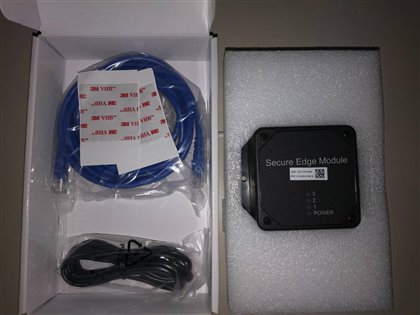

Unboxing -
I would like to thank @Randall Scasny and Element14 community for giving this opportunity to test Azure Guardian 100

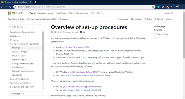

1. The Azure sphere setup is not completely mentioned in the brochure so I suggest you to follow this link.
The overview of the Azure Sphere module setup is given briefly and has good information on the hardware prototyping and updating the hardware. The procedure for this module requires a few software setups demonstrated in the link. The prerequisite is as follows:
It is mandatory to download all the file mentioned in the link for initial setup to the local server and setup to cloud connection.

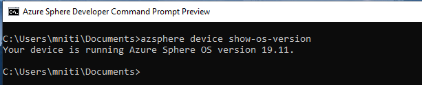

For checking the device version, we can command "azsphere device show-os-version"
