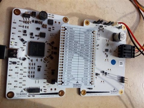

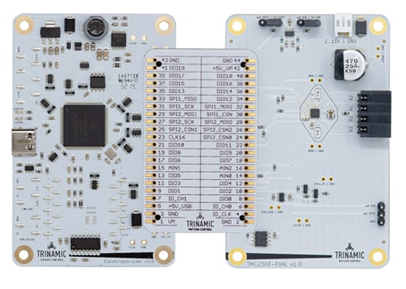

The TMC2300-EVAL kit allows you to explore all functions of the TMC2300-LA. The TMC2300-EVAL-KIT is a set of one MCU board Landungsbrücke, an Eselsbrücke bridge board and one TMC2300-EVAL driver board. It allows for a quick and simple start within only minutes to make your motor turning, while still providing full access to all registers and full functionality and diagnostics.
Each of these has a good supply of information on the TRINAMIC website.

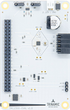

The first card is the: TMCL2300-EVAL
Features:
  • 2-phase stepper motor up to 1.7°
  • coil current (2.4A peak)
  • Supply Voltage 5. . . 28V DC
  • UART
  • 1...256 microsteps
  • Step/Dir interface
  • StealthChop™ silent PWM mode
  • SpreadCycle™ smart mixed decay
For diagnosis, all signals between MCU and TMC2300 are accessible with probes on the bridge board. TMC2300-EVAL can be used with or without the Landungsbrücke MCU board.
As for the development software, comprehensive sample code can be found in Trinamics Technology Access Package TTAP.
The second card is “Landungsbrücke”. It is the connection between a desktop computer and Trinamic’s Chip solutions. Just connect the desired board combination and start to discover Trinamic’s unique features.
The heart of the Landungsbrücke is a Freescale MK20 cortex M4 processor. A single firmware design covers all evaluation boards of the Trinamic evaluation system. Users can download the latest revisions, modify the firmware or create their own and easily update it via USB. The code of the Landungsbrücke is open source for download.
The third board is called “Eselsbrücke”. The Eselsbrücke is a connector board for Trinamic’s evaluation board system. With probes on the "Eselsbrücke" bridge board, all signals between MCU and corresponding evaluation board are accessible. Therefore, it allows quick and simple diagnosis for your application.

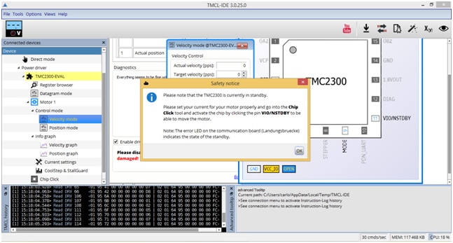

A pop-up at the start of the program warns the user that the card is in standby (this condition is also indicated by the lighting up of the red LED relating to error situations). It can be activated, after setting the maximum current in the motor, by clicking on the VIO/NSTDBY pin.

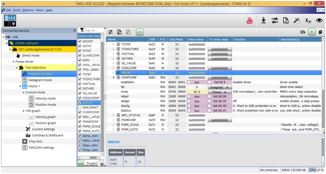

  • The Register Browser window allows the user to select and view the registers and, by clicking on the individual registers, it is possible to see all the register flags with their current values.

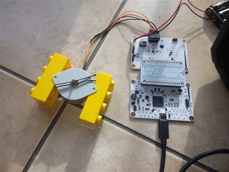

Second activity: We observe the card at work controlled by a PC
The second practical activity carried out using the kit was the installation and configuration of the basic scheme in which the stepper motor is controlled directly from the PC, thanks to the TCML-IDE program and the TRINAMIC cards.
The students already knew about DC motors and had used them in simple robotic applications with Arduino. When they saw the operation of the stepper motor they were very impressed both by the jerky motion with which it proceeds and by the intense torque it manages to exert.
The first laboratory experience was spent piloting the motor with the graphic interface of the TMCL-IDE.
Especially at low speeds, the difference between a stepper motor and a DC motor has been remarkable. An optical count of the steps was also made by which we calculated the amplitude of the single step.
Tests were then performed using the position-based control, both considering relative and absolute position. The students were very impressed with the precision with which the motor returned to its starting position even after thousands of steps taken.
The measurements were made without using sophisticated tools since the aim was not so much to assess the accuracy of the kit cards as to make students know a technology that they had only seen on books and that allows you to solve problems that with the use of DC motors cannot be properly managed unless using additional sensors.

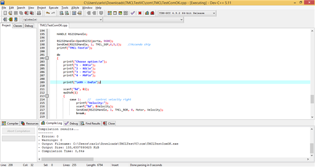

The third activity carried out by the students was to create a simple C program that could manage the command board without using the TMCL-IDE software.
Obviously the purpose was limited to executing a few instructions but I thought it was necessary not so much to create software capable of managing all the instructions of the TMCL language but to show students how it is possible to interface with a control board using the correct language and syntax through a serial channel.
The starting point was offered to us by TRINAMIC itself thanks to a C code as simple as it is efficient, found at the link: https://www.trinamic.com/fileadmin/assets/Support/Software/.
A simple C code was created which, at startup, allows the user to choose which instruction to send to the control board and with what parameters. Everything was done at the command line, without spending energy to create a graphical interface.
Commands such as ROR (Rotate Right), ROL (Rotate Left) and MST (Motor Stop) have been implemented very easily simply by analyzing the syntax of TMCL commands derived from a manual of the TMCL language.
Some problems have been encountered in the implementation of the code necessary to activate the card, or to bring the voltage on the VIO / NSTDBY pin to VCC.
The difficulties encountered by students in activating the chip were resolved by observing the TMCL-IDE logs in correspondence with the board startup instruction.
From reading the values of the datagram associated with the desired operation, the students traced the precise syntax of the command which, in the manual, was unclear and obtained the correct functioning of the code.

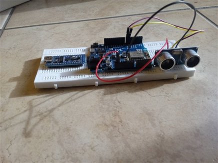

Activity 4: Check the motor with an example of IoT
The fourth "challenge" that I proposed to my students was to make sure that the speed of the stepper motor depended on an external quantity, for example, a temperature, a distance, etc.
The aim I wanted to achieve was to simulate an IoT system that had to control a stepper motor based on the values read by a sensor.
To complicate matters a bit I have imposed that the exchange of information between the sensor and the control board should take place via wifi.
Also, in this case, the students tried to reuse knowledge already acquired in previous laboratory activities and decided to use an ultrasonic sensor configured to measure distances as the source of the control signal.
As for the transmission of values using the wifi network, a simple WeMOS D1 card was used to create a very light web server in which to periodically publish the distance value read by the ultrasonic sensor.

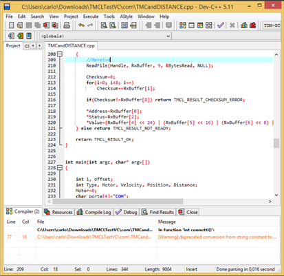

A C++  code based on that produced in the previous experience periodically reads the distance value and varies the speed according to the value received.
Obviously this experiment, although not having its own utility, was very interesting because it forced the students to choose the hardware and software components necessary to create a real IoT system by adapting different technologies in order to make them communicate with each other. The solution found, although not particularly elegant, is however functional.
In this project, we have created a small web server with a WeMOS D1 card, thanks to which the distance detected by an ultrasound sensor is published every second. The value, detected by a C application, is used to manage the speed of the stepper motor. In particular, we calculated the value to be assigned to the speed through a simple mathematical law.
Once the speed has been calculated, the value is sent to the stepper motor control board using the classic datagram built by the C program according to the syntax of the TMCL language.
With this simple example the speed of the stepper motor varies according to the distance between the ultrasonic sensor and an obstacle.
The purpose of the simple example is to see how to interface the motor to an external card, simulating a usual situation in the IoT.
