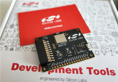

Introduction:
Hey Guys, This is my first review, and I hope you guys enjoy it.
This review is mainly aimed at the BGX13P Blue Gekko Xpress Bluetooth 5.0 devkit that was released by silicon Labs on the 16th of August, 2018. It is a nice board in black and looks really cool with the silver BGX13P module pre-soldered to it. Unfortunately, I really feel that silicon labs really wasted a lot of space in routing the PCB (especially in accommodating their logo) and could have fit the board in a form factor of around 30x30 mm2 instead of 38x45mm2 since the module itself without the board is just 12.9x15 mm2 in size which is quite small. A single BXG13P board costs around 21-22$ on Digikey, which means it will cost you around 35$-40$ with taxes and shipping. This makes it quite costly to its competitors (eg. RSL10) that are smaller in size and even provide more than just a Bluetooth capability.

Detailed Scrutiny:
The datasheet for the BGX13P module can be found here, and for the SLEXP8027A devkit can be found here.
image According to the datasheets, some important things to remember -
  • The power pins (VSS and VDD) can take 200mA at a time.
  • This means that the maximum total allowable cumulative current onboard is 200mA for all the rest of the GPIOs to source/sink together.
  • Every GPIO can individually source/sink a maximum of 50mA of current.
  • The BT works at a recommended baud of 9600 bps. However, you can set other bauds as well as per requirement at the cost of higher energy consumption (in order of a few mA).

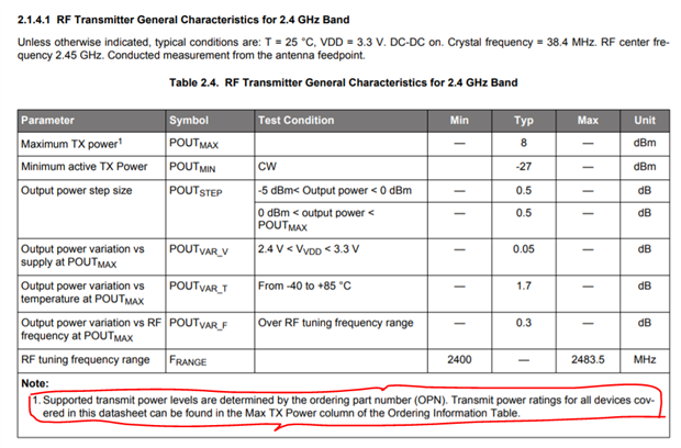

  • The Bluetooth transmitter transmits anywhere from -27 to 8 dBm(0.5 dBm step) depending on the requirement and current available.
  • The receiver can receive 2.4 to 2.4835 GHz freq and has a pretty low spurious emission. It is also very sensitive (-94.8 dBm).
  • The models BGX13P22GA meet the given SAR/RF Exposure requirements when the minimum separation distance to the human body is 20 mm.

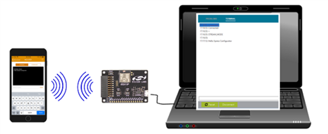

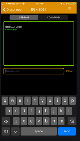

    2. Phone to BGX13P connection
It is possible to connect your phone to the BGX13P using the official mobile application meant for Xpress modules called the BGXCommander, available on iOS and Android both, which is good news for Apple users. But as is the case with other BT 5 proprietary devices, you CANNOT communicate without the official app or some other generic apps. So it's not like an HC05 that'll directly get patched to your mobile. But yes, it is fairly simpler to handle than the RSL10 which becomes more and more of a nightmare as you delve deeper into the highly abstracted BLE protocol of theirs. The app is fairly simple and you can see how it works here. As explained, there are two modes in which the BGX can operate - STREAM mode and REMOTE COMMAND mode. In-stream mode, you can send/receive the data to/from the BGX13P device that is connected with your mobile. In the remote command mode, you can push commands for setting baud rates, power values, advertise, connect to a peripheral, etc. The entire command list can be found here. Apart from this, you can also update firmware wirelessly using the OTA or 'over the air' functionality of the app and module. This is a pretty good feature that is common with most BT 5 devices, including the RSL10. Some firmwares though will create a problem, especially if they are outdated and will make your device unrecognizable on the phone. Don't worry, you can directly connect the board using the BGX13P as a standalone device connected to the PC directly using USB, and push the original factory loaded firmware that the devices came with, serially. This will make it recognizable again and brings us to the next use case -

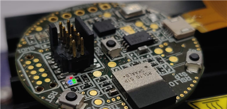

image<--- RSL10 SIP on the RSL10-SENSE-GEVKimage
It so happens that like with other devices like RSL10 that run a proprietary Bluetooth stack, this device cannot connect with other devices running some other proprietary stack of BT5 due to possible inconsistencies. A lot of in-depth knowledge of BT 5 stack and differences between the different proprietary protocols will be required to patch them up, which might still give inconsistent results. This is where your HC-05 is more convenient than the BGX or RSL10. Acting like an Arduino in today's world of much better and Hi-Fi MCUs, the HC-05 might be pretty outdated (running a BT 2.0 stack) but is still the most widely used of RSL10, BGX13P and itself due to its simplicity in getting the work done. That being said, convenience does not necessarily mean better; especially not in this case.
imagePlease note that the HC-12 module is not a BT device like HC-05/HC-06 even though it might appear to be of the same family.

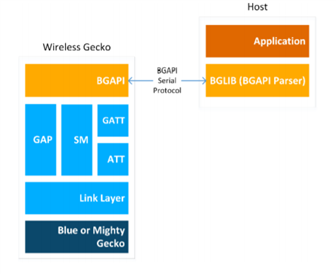

Blue Gekko Bluetooth Stack: The official document from SiLabs for its proprietary BT stack can be found here - QSG139. As this document clearly mentions in its 3rd page itself, you will need to read more than 10 documents even after going through that guide to fully understand the complete working of their stack. You can see the following diagrams on page 4 -
The diagram on the left is the stack for standalone operation, and the one on right is for remote or peripheral operation. The Dark blue layer labeled as Blue or Mighty Gekko is called the Physical Layer. It comprises of the Bluetooth BGX13P chip itself.
     image The following are some important features about the BGX BT stack -
  1. It is BT 5.1 version
  2. It has a variety of features like anon advertising, long-range, periodic advertising, extended advert packet size, etc.
  3. It has 2M PHY, meaning the Physical layer of the stack can transmit 2Mbps (1 bit per symbol assumed) which is double the usual 1M PHY. It was a bit of smart work applied in BT 5.x that doubles the speed. Read more here.
  4. You can connect 8 devices together, irrespective of their roles.
  5. Throughput: 1300 Kbps over 2M PHY, 700 Kbps over 1M PHY. RSL10 can handle up to 2000 Kbps.
  6. AES 128 Encryption.
  7. It has a higher power consumption, detailed comparison can be viewed in the last section of the review.
You can delve much deeper into the stack using the QSG139 documentation. The document clearly mentions all the functions and libraries used in the stack. However, for this review, this much touch upon this aspect of the BGX BT Stack is sufficient.

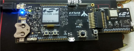

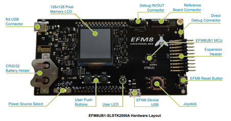

We all are now aware of the fact that the BGX13P can be developed using another MCU (EFM8 in this case) or with Simplicity Studio (using the BT SDK). But before that, let's learn and review these things a bit.
EFM8 board: This board is a good board, and has multiple ways to power it. This board could also have been a bit smaller but still its pretty compact on the left side. What you can see in the above diagram is the USB debugging mode, which can be used to flash code, binaries, etc in the chip. In case you choose to insert the USB cable (micro-USB) from below, it will run the current code in the flash memory, which by default is a Space Invaders demo game that can be played using the onboard joystick. To know how much work it does during this small demo, check out this page. When this board came to me, I was absolutely amazed at how classy the game looked on the onboard 128x128 pixel LCD. I absolutely loved the feel and responsiveness and tbh, I ended up wasting 2 days in nostalgia playing the old arcade game on this board.image The datasheet of the board can be downloaded from here.
What I loved about this board is -
  • The EFM8 is based on the good old 8051, just 100 times faster and much better than its predecessor. This is amazing and can be really useful to students and teachers who want to experiment with the basics, but not as outdated as the 8051
  • The LCD that comes with the board is amazing - the look, feel, thinness - everything
  • The multiple power options and the possibility to power the entire board with a single coin cell. Which also means that the board is pretty much low power.
  • Compatibility with the BGX13P - simple header to header attachment
  • Onboard buttons, joystick, ample GPIOs and a couple of I2C, SPI and UART interfaces.
  • The look and feel, presence of expansion headers, etc are also a plus.
  • Easy to learn and use once you start getting a hang of things.
  • imageAn inbuilt power profiling module is present onboard to check the power consumption of the board itself or any of its peripherals using the Simplicity Studio without the requirement of any special tool or profiler. This is the most useful and unique feature of the board - an onboard AEM.
The things I didn't like -
  • Outdated CPU - Frankly speaking, besides being a good learning tool this board is outdated especially given its price.
  • Hard to find documentation - This board does not have enough support since the EFM32 series has succeeded it so it is almost abandoned.
  • Large size, lack of standalone applicability - Every board is good at a few things and compromises on some other things. So each board has a special application or domain. this board has none where I cannot think of a more suitable alternative.
  • Too pricey - At around 30$ without taxes and shipping, it is not a cheap board, considering it requires additional tools to make it more useful, like the BGX13P board which costs another 40-45$
  • Lack of community use and support - Frankly speaking, no one uses this board much. So don't expect much answers on stack overflow or something in case you post a library or some other non-generic error because it is unlikely anyone else must've come across the same error.
  • Lack of takers: People who will easy understand this board, will know there are better alternatives. The people who are just starting might find this board a bit too much due to lack of community support. Hence there is no section of the embedded community except a select few where this board can find takers. The only useability for this board is its onboard AEM. However, this feature is also present in the more recent EFM32 version.
That being said, it is sufficient to play with the BGX13P and since the main motive of the review is to test out the BGX13P and Not the EFM8, I ain't complaining. But if you are thinking of buying an EFM, go with an EFM32 since that might serve you better. Hence, I have not considered this board in my review marks. However, if an EFM32 would have been shipped, I would have surely used it much more even after the review, while this EFM8 will probably just sit there most of the time on my table once I am done with my review.

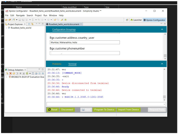

Simplicity Studio: This is an eclipse based IDE, developed for Silicon Lab devices, much like the ON Semi IDE built for ON Semiconductor devices. It is a simple to use IDE, containing multiple tools including the BGX Configurator, Energy profiling tool, the Hardware configurator tool and much more. The IDE is almost completely free except for a few utilities that won't get downloaded automatically until you purchase the license required. So here is how it works - You install the Simplicity Studio 4 IDE from here. Once it gets installed, you can directly plug in your Silicon Lab devices and the necessary free files will automatically be downloaded for you by a wizard that steps you through a login and device registration process. Hence, Simplicity Studio is highly intuitive and very easy to use as it basically does all the work, you don't even have to select the device number like SLSTK2000A, etc. The Entire guide on how to use the SS IDE can be found here - AN0822. The BGX Configurator is a wonderful tool to configure and use the BGX Stack, as explained from page 13 in the QSG139 documentation. Documentation for the Energy profiler tool can also be found here - UG343. Mesh Network performance and comparison for BGX devices can be studied in this document - AN1142. Finally, the Hardware Configurator for 8-bit devices like the EFM8 can be utilized by referring to guide AN0823. This guide will teach you how to make use of the onboard AEM in the EFM8, which can measure current use up to 50mA in realtime. As you can see, despite being very simple and intuitive, the feature-rich SS IDE can only be fully utilised by going through a lot of documentation. Also, this IDE is very much skewed to the use of Silicon Labs devices. This means using a more generic IDE like Eclipse will also be required along with this IDE in case you wish to work with other embedded devices that are not from Silicon Labs.
BGX13P Use with Simplicity Studio and BGXCommander App
As you can see, the BGX configurator tool is directly downloaded once your device is registered and your ID is created on the Simplicity Studio.
Clearly, the configurator works great, in proper sync with the BGX commander app.

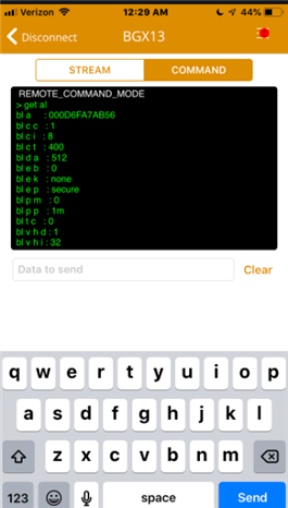

Here's how the BGX Commander looks in the Stream and command modes on various mobiles running android. The command mode can be selected using the toggle tab. The entire list of commands can be seen here. The app works nicely in most of the devices in the market.

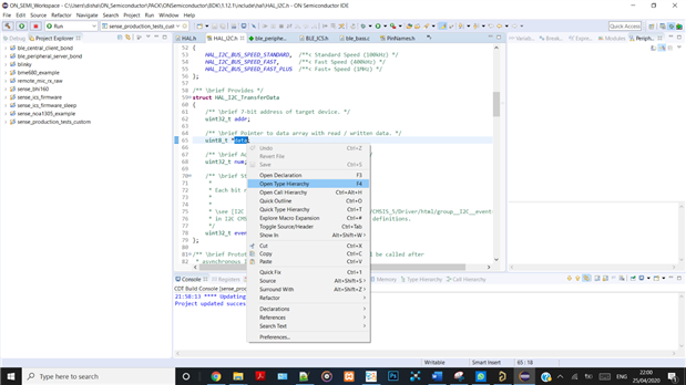

The On Semi IDE is eclipse based, neat and useful for RSL10 devices. However, it is also quite suitable and flexible towards Non-On Semi devices. This IDE is really great, it has really nice hierarchy and source finding options, which means if you are confused about what a variable or function is for, you can just search it down the abstraction hierarchy. You can also check the call hierarchy, in case there are nested functions and all. This is really helpful in abstraction and can save you hours in tracing things. Unfortunately, other than this there are no special plugins or something that are offered by this IDE. It relies heavily on the segger tools, which are great by the way. This IDE also a bit buggy though.

  •   wrote:
    ..It is nowhere mentioned in the datasheet whether the values are for 8dBm transmission or 0dBm.
    Hi Dishant, if it's not mentioned, then the power comparison is meaningless. The difference between 0dBm and 8dBm could almost entirely account for the conclusion you wrote in red:
    The BGX13P consumes more than 5 times the power consumed by RSL10 to transmit 1 symbol. Quite a result.
    I'm not sure it is possible to assume that 0dBm is a standard for reporting power consumption.. where is that a standard?
    I'm not saying your conclusion is wrong, just that I can't see how there's any confidence in this conclusion in red. Or at the very least, it would be worth mentioning in the review that this is based on an assumption that's not been confirmed with silabs.
    Also, regarding the power calculation, as Aswin says, there's likely an error, because you mention 7kHz for the RSL10 but then swap around with the BGX13P for the calculation. Even if that's correct, it's not fair to equate an audio stream with a UART replacement. How do you know what codec the RSL10 is using, since that is proprietary? It's not necessarily transmitting at 7k bytes per second. Let's say it was using G.726. If it was, then it could be transmitting 2kbytes per sec, even though the sample rate is 8k samples/sec. That too could easily make the power consumption per symbol comparison hugely different.
    Anyway, I'm not trying to pick holes here, it's just that if you're going to make a claim (and then even stick it in red!) then I feel it either needs to be correct, or at least clearly caveated if it is based on assumptions.
  • Hi Dishant,
    • The power consumed while transmitting at 20 ms intervals is 15.51mW (4.7mA, 3.3V) while for the RSL10 the power consumed for 5.5 ms interval while transmitting audio at 7 kHz is just 2.25mW (1.8mA, 1.25V).
    While the data rate is lower in the RSL10, its transmission interval is much higher. To normalize things, let's consider a 110 ms interval -
    • In 110 ms, the BGX transmits - (110/5.5)*7k = 140k samples and consumes 2.25*20 = 45 mW power.
    On the other hand,
    • In 110 ms, the RSL10 transmits - (110/20)*9.6k = 52.8k samples and consumes 15.51*5.5 = 85.305 mW power.
    • Considering the power consumed per sample transmitted will be 0.321uW (45m/140k) for RSL10 and 1.61uW (85.305m/52.8k) for the BGX13P.
    • Meaning, The BGX13P consumes more than 5 times the power consumed by RSL10 to transmit 1 symbol. Quite a result.
    quoting your power consumption math.
    Did you measure these values on a scope or just calculated it?
    First of all 20ms is the advertising interval not the connection interval. As far as I know all the BLE chips (BLE SIG specification ) can only advertise to minimum of 20msec interval. The minimum connection interval is 7.5 in the case of BGX13P.
    Even you consider 20msec packet transfer connection interval. I think something is wrong in your power consumption calculation! Or may be I can wrong.
    • In 110 ms, the BGX transmits ( you meant RSL10 here because you are diving it by 5.5 !! )- (110/5.5)*7k = 140k samples and consumes 2.25*20 = 45 mW power.
    On the other hand,
    You swaped the chip name here I guess.
    Can you explain a little more detail how you calculated these numbers?
    I never used RSL10 so I can't comment on that chip.
    Reference : https://docs.silabs.com/gecko-os/1/bgx/latest/throughput
    Thanks and regards.
    Aswin
  •   wrote:
    I did the comparison because I have used both the modules, and they are priced similarly as well. As you said, the RSL10 has many more features than this module, having DSP and uC inbuilt inside along with BT stack, while the BGX13P is just like an easy to use wired UART solution. But then it should have been equivalently priced, but it isn't. For me, I would anytime go for a controller with more capabilities than a device like the BGX that can only do a specific thing. Especially when the price difference isn't much to what all the tiny board provides extra. And their coding syntaxes, work environments, etc are all quite similar as well. For me, it was a very suitable comparison of two BT 5 capable devices.
    Yes, you are right they are priced similarly but, in my opinion, the two products serve quite different markets (as you also pointed out).
    Maybe the Silicon labs BGM210P product range would be a more similar type of SiP to the RSL10 SiP for evaluation purposes. These BGM210P modules are cheaper than the RSL10 and are based on the ARM CortexRegistered-M33 MCU Core with DSP, but then these modules don't come with the additional core, which the RSL10 has. So evenly matched; price vs features, in my opinion.
    The BGX13P closest match is probably the microchip RN4871 module, which is also cheaper. I bought one of those RN4871 modules a few years ago but never got it to work. I had all sorts of firmware issues and the firmware update process was very troublesome. So from a convenience point of view the BGX13P wins this battle. It is whether this convenience and performance is worth that price.
    Personally, if Silicon labs added one or two more BLE specific features to the BGX13P then I would choose this module hands down over the RSL10 and others for quite a few add-on serial link or pure data transfer use cases. The part I find odd about the BGX13P is a resilient use case for I2C...
  • Hello shabaz.
    Thanks for reading the review. It is nowhere mentioned in the datasheet whether the values are for 8dBm transmission or 0dBm. However, it is mentioned in one table that the max tx power is dependant on the part number ordered (OPN). As the datasheet is common for all the BGX13P modules, my guess is that all specifications are mentioned for 0dBm because -
    • It would show lesser current values, which is better. 8 dBm is the max it can go, but it doesn't need to go there.
    • 0dBm is like a standard value for comparison as most BT devices support 0dBm max transmission power.
    • The reason I already mentioned - All BGX13P modules support 0 dBm power transmission.
    As far as the transmission power is concerned, you can check any datasheet of any transmission device. I have worked with XBEEs, LORAs, BTs, WiFis and many other RF transceivers. And I have always found the datasheets to clearly mention that tx current consumption is > rx current consumption, which seems quite logical to me as there is no power being spent to receive a wave, while in transmission, the energy of the signal transmitted is also spent.
    I work in a CanSat modeling team that participates in the American International Cansat Competition. We are 13th currently worldwide, and expect a top 10 rank this yearimage Most of my RF related power consumption experience comes from there.
  • Hi Dishant,
    Regarding the current consumption, I think it's likely not a like-for-like comparison:
    Is the BGX13P power output 0dBm or 8dBm? The RSL10 datasheet value states 0dBm output. The BGX13P spec may be at 8dBm perhaps (I'm not saying it is, but I couldn't see where it was specified), in which case is the BGX13P more efficient?
    Also, the devices are for different purposes, because the BGX13P is an easy-to-use wired UART connection replacement device it seems? whereas the RSL10 is a complete microcontroller with full BLE capabilities.
    One other minor point:
    In fact, the transmission always needs more power than reception.
    That's not generally true with low-power transmission devices. Most of the circuitry in the chip is powered on for receive too, plus additional amplification; it can end up taking as much, or more power consumption, to receive, unless the receive circuitry is powered down sometimes (i.e. then the sleep modes current consumption, and time to wakeup become important).
