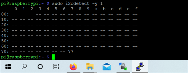

Once I installed the parts, I tested the sensors by probing the I2C bus.

The I2C sensor shows up on address 0x77.
