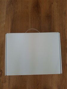

Unpacking the kit
The components of the kit have arrived in a nice white box with elements well protected by foam
