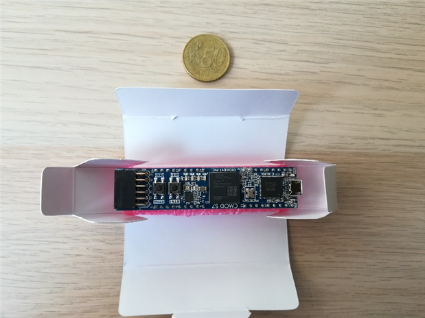

The product: Digilent CMOD S7
The package itself is very small, as the board, that has the nice feature to be easily integrated on a breadboard, or in general, on a DIP-40 2.54mm socket. The board is shipped with no cable, but they are quite common, and therefore it is not such a problem. It is noticeable the absence of any instruction manual and/or schematic, which are available directly on Digilent website along with schematics and other useful information.
The package and the board are shown below (0.50€ coin as reference).
The Board
The board is basically composed by:
  • the Xilinx Spartan-7 FPGA, xc7s-, manufactured in 28nm technology.
  • the FT2232H, used as JTAG programmer (compatible with Vivado, and surely also with OpenOCD, but I did not test yet) and as serial interface. In this case, Digilent decided that it was easier to only use it as UART, and therefore only RXD and TXD pin on the dedicated channel are connected physically to the FPGA. On my own designs I use to connect at least a full MPSEE engine (or, in other words, a full 8bit data port) of the FT2232H to the FPGA. From my point of view it is a big drawback, as a user cannot take advantage of all the functionality of the FT2232H as versatile serial engine. On this board, most of the FPGA pins are not connected to an outer header or to other ICs. Hence, the FT2232H could have been connected to the Xilinx Spartan7 with 4 pins to implement a minimal SPI (much faster and flexible) to the FPGA without complicating that much the design of the board.
  • A flash memory to store FPGA configuration, that can be used also to store the firmware for a soft-core microcontroller to be embedded on the hardware.
  • Two momentary buttons
  • 4 green leds + a RGB led.
As listed above, the board is very basic (and it explains its low price compared to other Digilent products) and thus, many features that FPGA users use to see on bigger boards, as SD-card dock, RAM memory, etc., are not available here.
