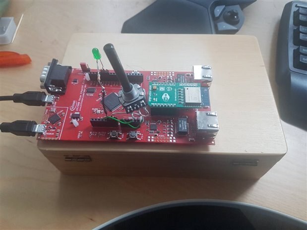

And here I quickly started running into other problems: I used the CE setup to be able to use components and this allowed me after a lot of doing to, for example implement an interrupt handler for a user-button. But this was really something to get used to. This did however lessen the learning curve for using the ADC to read the resistor. In the end I had input from both the button and pot, and a blinking led to boot.
The left picture above is a simple hardware setup with the components mentioned. The right picture is a Dave Configuration to use both a led and a button.
The nice thing about configuring most of the application in UI's, is that one can then use the button for example to switch off the PWM device:
