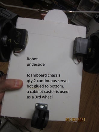

I run a robotics and makers club at the local library.
My Road Test Mission: Build a simple robot(s) using RPi Pico, record experience and compare with other beginner robot platforms.

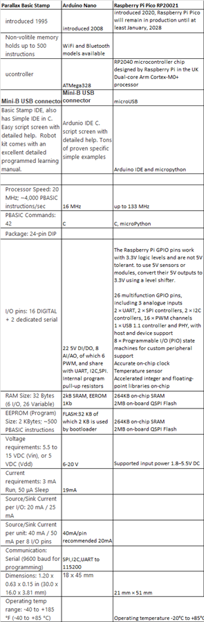

Comparative beginner robot platforms – Parallax BoeBot (Basic Stamp with PBASIC) , Arduino Nano
Comparative matrix of RP2020 controllers:  Adafruit & Sparkfun.  MicroBit and CircuitPython weren’t considered for this road test, altho robots can be built with them, they really are better suited for premade accessory boards.
Road Test Results In a nutshell:
Raspberry Pi Pico blows previous microcontrollers for robots out of the water !
The analog and PWM resolution is so much better in the Pico, and easy to program. Reliably driving servos and H bridges is a piece of cake !

Robot photos: a 7.4v Lipo powers the robot. A Buck boot power supply converts 7.4 V to 5.5V to a forward biased diode.
The diode output is fed to the Rspberry Pi Pico VSYS. The diode blocks 5V from backfeeding the robot from the Pico USB port when plugged in from the programming PC.
Level shifters are used in between the 3V GPIO pins to the servo 5V signal pins.
With a working mobile platform, ping sensors, PixyCams, GPS, QTIs, etc can be easily added to enhance the functionality of the robot.
