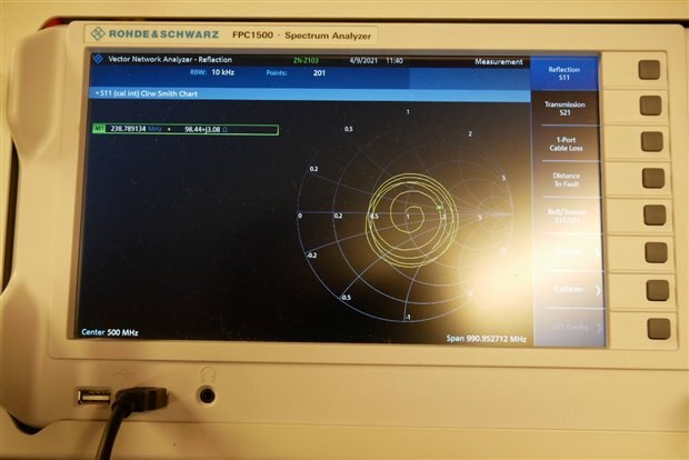

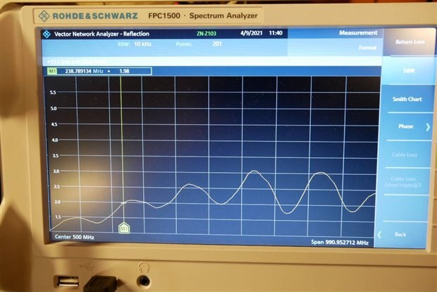

    Here are a couple of pics of the TEM cell. It starts off at 50MHz or so with SWR = 1.4 and it rises to 3 at about 650MHz - which I expect will be the upper limit of it's usefullness. That's a 45cm ruler…

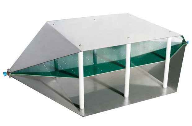

    The TEK box looks as if it is made of sheet metal.
    It just looks like it, but no I think about. I think it's a µ-metal plate that is annealed at 1100 ° C for 5 hours. This stabilizes the plate's permeability.
    I posted the link from the company Vakuumschmelze, there it is described in the pdf how the shielding plates are finished (Chapter 5).
    PB-PHT-001 e neu (vacuumschmelze.com)
    Or its another material, I don't know; next week I'll ask Tekbox.
    It is made entirely of double sided copper clad board.  The two copper layers are joined by "vias" (holes withe wire soldered in) at regular intervals.
    It's OK up to 1GHz, .
    Aha, ok thanks.
    What I think is, hm..., the septum is a PCB with striplines and resistors (zoom the picture, I thinks you can see this).
    Here is a fine description (it is in English):
    Tekbox TBTC3 TEM Zelle, für EMC Pre-Compliance Testing, 103,8x50x30,5 cm - Rekirsch Elektronik - Ihr Partner für Messtechnik, Telekommunikation und Touchscreens
    From this link:
    "A TEM cell is a stripline device for radiated emissions and immunity testing of electronic devices. It is not a replacement, but due to its size and cost it is a convenient alternative to measurements in an anechoic chamber.
    A TEM cell consists of a septum, the conductive strip in the centre section and walls which are connected to ground. The geometry is designed to present a 50Ω stripline. The device under test (DUT) is placed in between the bottom wall and the septum.
    The TBTC1/2/3 are so called “open TEM cells”, which got no side walls for convenient placement of the DUT. It may pick up RF background noise, which however can be taken into account by doing a measurement of the cell output signal before powering on the DUT.
    Tekbox open TEM cells got a better frequency response compared to standard TEM cells of similar size. TEM cells suffer from higher order wave modes which limit the usable bandwidth. A unique design feature of the Tekbox TEM cells implements resistance perpendicular to the desired propagation direction of the wave. Consequently higher order wave modes and resonances are supressed."
    You don't need an enclosing box, except maybe to reduce emissions that may upset your neighbours.

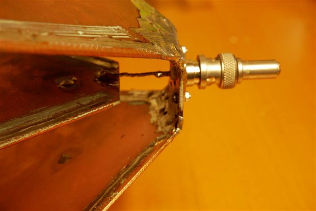

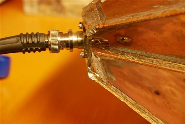

    From the pics below you will see that it's not very symetrical (I didn't make it !!), it works much better if the short end is driven and the long end is terminated (SWR below 3 up to 1GHz)
    Last pic re-inserted because some members can't see it.
    Sorry about the grim pics of FPC screen.
    MK

    How looks on the other side of the septum in details?
    What are this holes? Are they vias, (and) or resistors?
    Best regards
    Gerald
