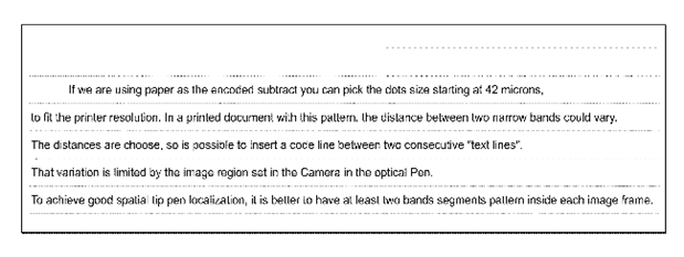

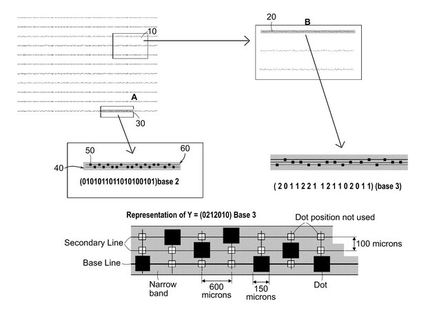

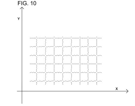

    shabaz over 12 years ago in reply to morgaine
    Here is one method someone devised.
    It would be nice to have some open source engine that could be used to detect position from an image, and some software to generate the co-ords of where to print dots on a surface.

    morgaine over 12 years ago in reply to shabaz
    ... which the open source community has to explicitly avoid as it's patented, at least until such a time as Google makes it royalty-free.  Fortunately there are a billion and one other encodings available.
    Yes indeed.  I wouldn't be at all surprised to find that it already exists in one of the many image processing communities, especially in machine vision since pattern recognition is one of its core elements.  I doubt that 3D printing will have to invent much that is new in this particular area, only apply it in creative ways.
