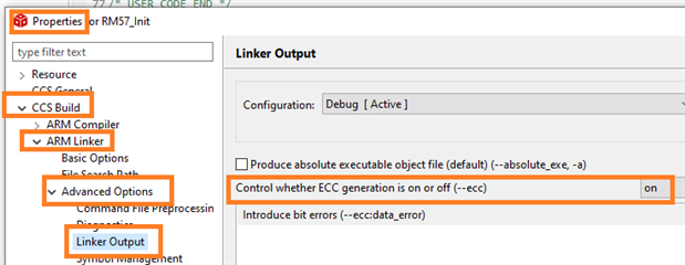

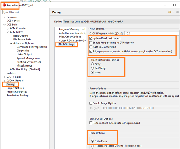

Adapt Project Properties for Tool Chain and Programmer
Handling ECC has changed across tool chain versions (specifically the linker settings).
I forgot from what version on, but certainly TI Compiler V 20 and above have this.
The project properties dialogs in CCS adapt to the tool chain you are using.
Here is what I set for TI Compiler V 20:
Compiler / Linker:
Programmer:
I hope that this small set of instructions helps.
