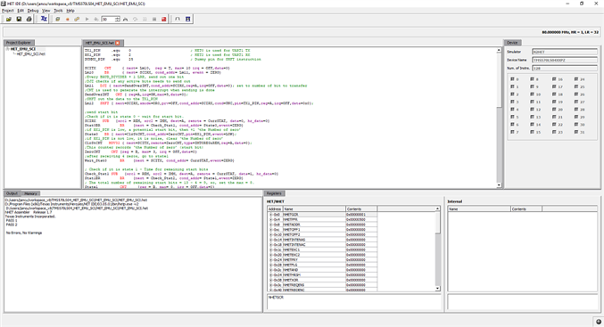

The High End Timer Script
The NHET controller has its own language. One I'm not fluent in.
On my own, I would not be able to develop this script.
Luckily, the application note comes with the NHET code. The only thing to do is adapt it to the frequency of the controller I'm using.
On two places in the script, the timer skips a few counts to precisely achieve 115200 baud.
You can find the script in the HET_EMU_SCI folder of the project I attached. Here are the two lines that are different from the application note example:
SCITX    CNT     { next= Lm10,  reg = T, max= 10 irq = OFF,data=0}
State2 CNT     { reg = A, max= 9, irq = OFF,data=0}
How is this loaded to the NHET controller?
The HET assembler converts the script into a C .h and .c file.
If you look at these files you'll see that they don't contain readable code, but an array of raw data:
HET_MEMORY const HET_INIT0_PST[34] =
  /* TX1_PIN_0 */
0x00002CA0,
0x0000000A,
0x00000000,
0x00000000
  /* Lm10_0 */
0x0000BA00,
0x00004080,
0x00000000,
0x00000000
  /* Lm11_0 */
0x00007480,
0x0000A000,
Those are the machine language instructions for the HET timer.
At the startup of your firmware, this chunk of instructions is loaded into the HET memory.
From then on, the timer will constantly run through that code. Always. Even when you halt the main controller in debug mode (except if you take special measures).

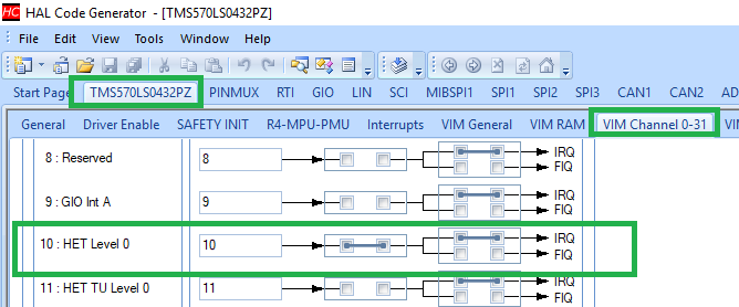

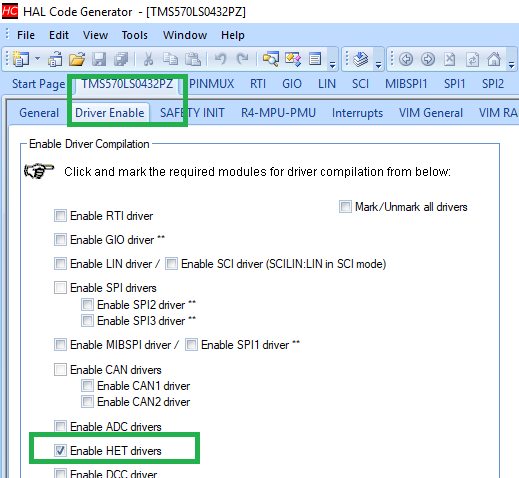

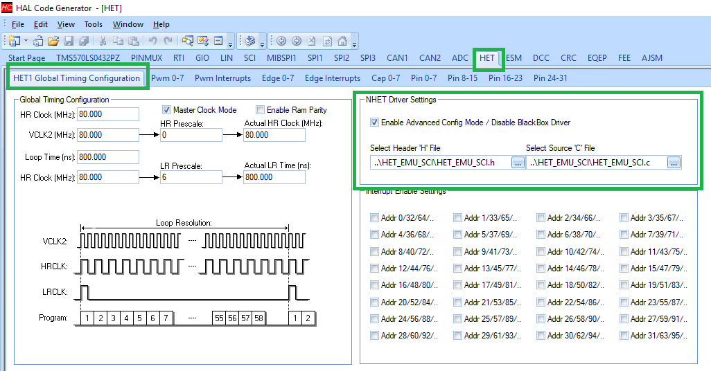

Hardware Configuration
That's done in the HALCoGen utility for this controller family. Here is an overview of the settings.
The timer module is enabled
The interrupt is enabled:

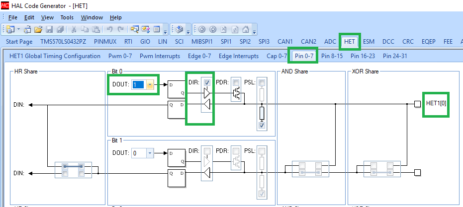

Configure HET to use the .het script:
Set the HET TX pin to output, high by default:
That's it

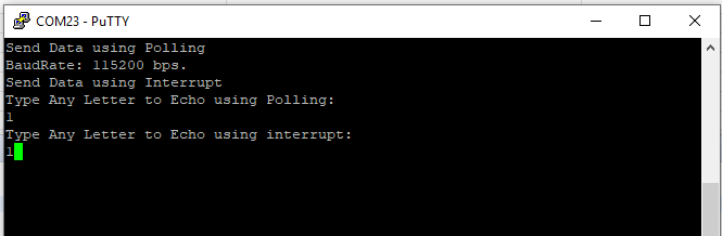

The end result is an additional serial port running at 115200 baud, where HET0 pin is TX and HET2 is RX.
In PuTTY, here is a capture of a session:

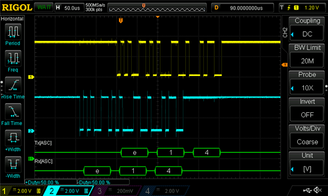

    Jan Cumps over 7 years ago +4
    I forgot to post the geeky photo where I use the debug side of a MSP432 LaunchPad as the other side of the UART link
