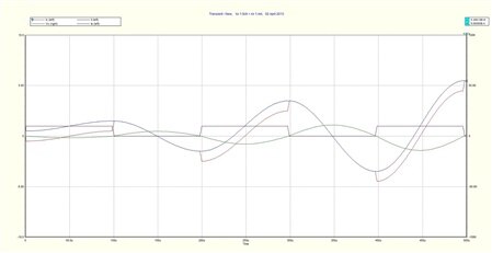

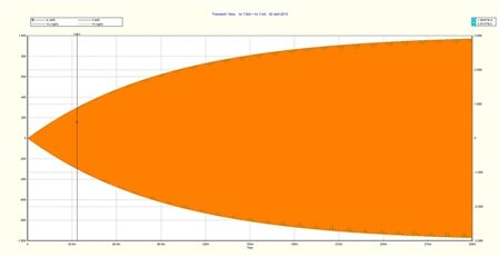

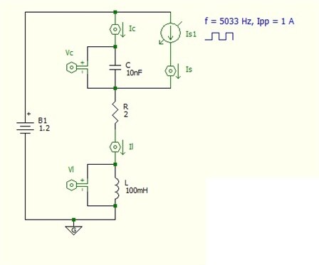

    The following diagrams show how an inductance can be driven at any current and voltage above the source voltage, using a switched ideal current source running at resonance. It can be used to drive a high voltage DC motor (designed for 36V), from a low voltage high current battery (parallel connected 1V2 lithium-ion batteries).

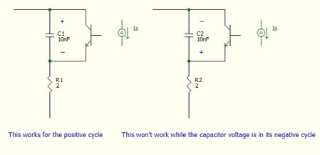

    Is there an ideal constant current source device that will work if the voltage polarity on its two terminals appose the current flow?
    A BJT will work while the capacitor voltage (green trace) is positive, and the C-E voltage is positive, but not while the C-E voltage is negative. The current must continue in the same direction. A MOSFET won't work, because it is not a constant current device. The diagrams show: the LCR circuit; circuits showing two capacitor voltage half cycles using a BJT current source; the initial waveforms over several cycles using an ideal current source (the black trace shows the current source and the phase relation to the other voltages and currents); the same waveforms showing how the voltages and currents build up to scary levels.
    Any answers would be much appreciated.
    *Note: simulations and diagrams are from '5Spice Analysis'
    For those that can't read the axis, the left current axis on the last diagram goes from -1.00 kA to 1.00 kA, and the right axis goes from -2.00 MV to 2.00 MV (yes, read Mega)

    Hi,
    The ideal current source, is something that doesn't exist in real life as a standalone component (and in real life it will
    only appear to be an 'ideal' current source over a defined range).
    For example in real life, a current source circuit may behave like an ideal current source only for a certain current value
    (e.g. preset to a value between 0 to 1mA only), and only for some defined load impedance (e.g. from 0ohm to 10kohm).
    Furthermore, a real life current source relies on a voltage source (e.g. 12v supply) to function, so the fact that the rest of the
    circuit is powered by a 1.2V supply doesn't mean that you won't need another supply too (the current source requires
    power to function).
    If you wish to step-up a lower voltage to a higher voltage, your best bet is to google for a topology of a 'boost converter', which
    is a DC-DC converter which relies on a switching device (MOSFET) and an inductor.

    There is no such device - ie there are no simple component 2 terminal current sources - why not - because it would be a source of energy when the current is in one direction and  a sink for energy in the other. A battery is an approximation of  a two terminal voltage source, when the current is in one direction energy comes out of it , if you force current in the other direction then energy goes into it - if it's  a re-chargeable battery it charges up.
    It is possible to make (complex) circuits that work rather like a 4 port current source (two terminals for the power in and two for the current source bit).
    There are several components that operate as two terminal current sinks (ie they only work in one direction, the one where you put power from outside) but this won't help you.

    Well no ......... and yes:
    A perfect 1V voltage source in series with 1 ohm behaves EXACTLY like a perfect 1A current source in parallel with 1 ohm. http://en.wikipedia.org/wiki/Th%C3%A9venin%27s_theorem
    I don't think this will help you much becaue I think you want a very high parallel resistance, which would be equivalent to a large voltage in series with a large resistance.
    I'm afraid that in real life there are no physical equivalents to the current sources in spice.
