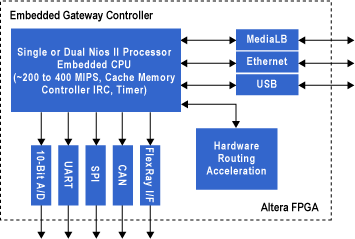

Figure 1 shows a typical automotive gateway controller system. Altera's low-cost CycloneRegistered series FPGAs are used for the next generation of embedded gateway controllers. AlteraRegistered FPGAs offer fully-flexible, real system-on-chip (SOC) solutions with a configurable number of ports and types along with hardware routing acceleration. Additionally, the NiosRegistered II 32-bit RISC embedded processor architecture allows for easy integration of network services protocols.
All the types of interfaces shown in Figure 1 are available as intellectual property (IP) cores from Altera or Altera partners. Using Altera’s SOPC Builder, you can implement a Nios II processor along with all types of IP on a flexible bus system within a few minutes.
Figure 1. Automotive Gateway Controller
