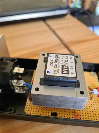

    Found an answer elsewhere.... easy really and makes perfect sense My transformer is as below... I need to run secondary's in series which will give me a center tap... so i need to do this... join terminals…

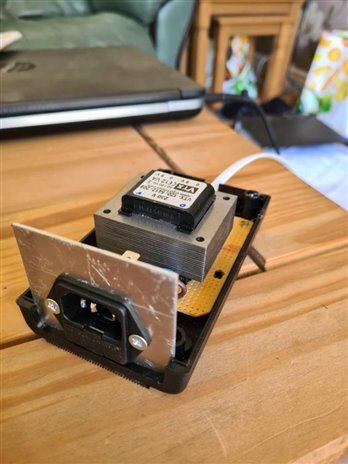

    Question: I'm wiring up this thing to a mains plug (i'm in the UK) so a mains plug generally has live, neutral and earth.... Do i need the earth or can it be wired safety as the guy above has done his without an earth?
    If i had it earthed where would I connect the ground to??
    shabaz over 6 years ago in reply to Andy Betts
    Hi Andy,
    If you've got anything metal exposed such as a screw, or a metal enclosure then the earth is needed, and it would be connected to that.
    Some transformers may need it too, but it's likely you won't need that if the manufacturer has not provided an earth point on the transformer and if it's indicated as a safety or isolating transformer.
    If you have nowhere to connect the earth to, then the connection on the IEC connector socket can be left disconnected, as the person has done with the power supply in the photo above.

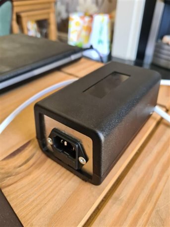

    Andy Betts over 6 years ago
    UPDATE: wired the transformer, and it worked perfectly. Just bought a plastic Hammond enclosure, and after a little bit of snipping of the PCB board with some snips managed to fit it perfectly. Superglued the board to the standoffs within the encl;osure, and also added some glue from a hot glue gun as a belt and braces to ensure it doesn't come loose....
