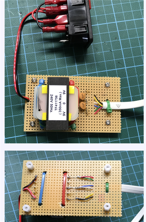

I've just bought an SM82 from the US, and got it for good money ($50 inc shipping) Obviously the PSU it came with is for 110v power so i've gathered together all the bits to make my own 230v PSU. they do sell reproduction PSU's on EBay but they go for around £50 and I can make one for around £20. i do have quite a bit of experience with soldering and electronics, but NOT with PSU's, never made one. But it's one of those things i want to have a go at to tick off the bucket list of things to do.
A guy previously made one and posted his build on another site (I've also posted on that site to try and gain more information) his build is here https://www.thegearpage.net/board/index.php?threads/diy-rane-rs1-power-supply-for-sm26-and-sm82.1838728/
he built his with no thermistors in series, which i don't want to do, I want to play safe.

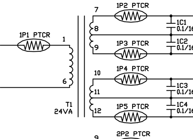

I've purchased a transformer from Rapid Electronics (Vigortronix VTX-120-5412-209 PCB Transformer 230V 12VA 9V+9V) which should do the trick, but my question is around the thermistors. The PCT Thermistors are there to prevent inrush current into the transformer so i'm a little loath to build this without thermistors in place.
The schematic for the original PSU is not available, however there is a schematic for a Rap 10. The Rap 10 is the same as the single PSU, just multiplied 10 times, so please ignore the other 9 outputs on the schematic.... Here is the schematic https://www.ranecommercial.com/legacy/pdf/old/rap10sch.pdf
As the thermistor is variable resistance how do i know what one to buy?? Is there a way of calculating the zero power resistance? Rapid have the following on their site
https://www.rapidonline.com/Catalogue/Search?Query=thermistors&Tier=PTC
Any ideas??

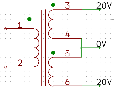

    Found an answer elsewhere.... easy really and makes perfect sense My transformer is as below... I need to run secondary's in series which will give me a center tap... so i need to do this... join terminals…

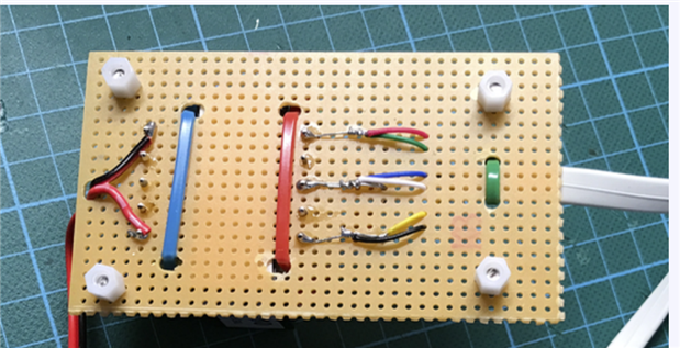

    It's not a symbol I've seen before, but it's not normal practice to have a PTC device on the primary side. It is not normal practice to place it on the secondary side where it is currently placed either. It is normal practice to have it at the input of the end device (optionally) - perhaps theoretically at the output of the end supply, but even there, it really depends on the end device, i.e. you'll need to measure end device current, and then pick the PTC.
    For a safe design it's best to stick to normal practice. As a result, the transformer can (optionally) have a thermal fuse built-in, and then on the primary side the first thing would be an IEC mains connector with built-in fuse, and then connect that to the transformer primary. That's it, no additional component is needed (a filter is optional). The fuse value determination is partially by experimentation, i.e. once the supply is built, you can measure it and then pick the closest fuse that doesn't blow in normal use.
    Looking at the PSU at the link you sent, this looks well constructed. The underside should be have a cover (could be another piece of proto board) to not allow any fingers to touch the primary side. Only other thing I'd do differently is use proper wire - the primary side wire looks like general purpose wire. At a pinch, a short length of mains cable could be stripped and the insides of that could be used.

    So you reckon, don't worry about the thermistors as shown in the schematic... Just add a fuse to the mains plug end? That would then be exactly as shown in those photos, generally our mains plugs in the UK have a 13amp fuse in them so i could easily use one of those.
    shabaz over 6 years ago in reply to Andy Betts
    Hi Andy,
    That's correct, no need for any thermistors. Regarding the fuse, it's a good advantage to have it in the IEC socket for hobby projects, because it eliminates some of the risk in the construction. Also, often the fuse in the plug won't blow unless there's severe overload, people tend to put any fuse in there or swap them around when troubleshooting, so all round it's better to have the additional fuse.

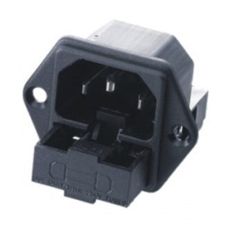

    So..... wire a fuse holder onto the board essentially? i'll also have one in the plug
    That's feasible, and valid for a commercial device, but personally I'd go for this type of IEC socket:
    It has a built-in fuse tray for the smaller 5 x 20mm (I think) sized fuse.
    It's all about reducing risk. If you have a fuse on the circuit board, then there's the risk of something shorting before the fuse (the one in the plug cannot be relied on to help for the reasons mentioned earlier). The least risk option (other than to use a ready-made PSU) is the type of socket shown above.

    Andy Betts over 6 years ago in reply to shabaz
    Found one.... and cheap too
    https://www.rapidonline.com/bulgin-pf0001-63-mains-socket-panel-mount-fused-flange-250v-ac-10a-6-3mm-51-4352

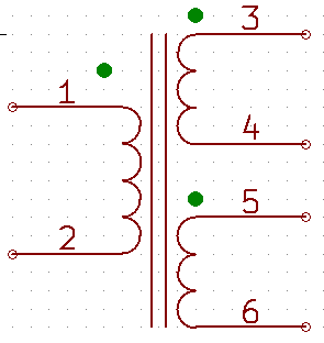

    I've purchased a transformer, 230v primary with a dual 9v secondary.. You can read about it here.... Hopefully it'll be OK for my use. The data sheet is attached, mine is the 12va one
    This is slightly different from the one used by the guy above, as this one has 2 0v pins where his only had 1. Question.... As mine has 2 0v pins am I Ok to just utilize 1 of them, i assume yes. My 230v input will use the 2 outer pins on the primary side, but when you look at the schematic of the PSU on the secondary side it has 2 9v and 1 centre tap so I don't really need to use the extra 0v pin.
    I need to run secondary's in series which will give me a center tap... so i need to do this... join terminals 4 and 5 together will give me that center tap
    found the answer here
    https://electronics.stackexchange.com/questions/193536/how-to-wire-centre-tap-transformer
    Hi Andy,
    Sorry I missed seeing the question, but you're right, they can be connected in the way you describe to get the dual rails with the center-tap.
