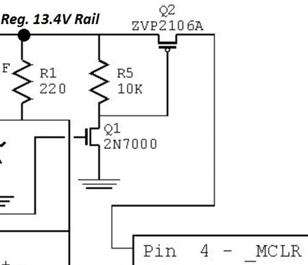

I will be double checking any opinion with a Multimeter.  I ordered a less expensive part for this project "by mistake" from Newark.   The N-Channel FET equivalent of Q2 (ZVN2106A) was ordered and was 33% of the cost of the P-Channel FET.  The gate of Q1 is controlled by a signal coming over the Parallel port of a desktop PC.  It seems to me that Q1 and R5 can be swapped and everybody will be happy.   Am I correct?

    If I understand your question correctly, you want to replace Q2 with an NFET and swap Q1 and R5 to get a higher voltage on the gate of Q2.
    If that's the case, I don't think it's going to work.  To turn on, an NFET requires that the gate voltage be higher than the source.  It must be higher by at least Vth, the threshold voltage.  However, this turns it on weakly: it's in saturation mode and Vsource will be at most Vgate - Vth.  To fully turn on the NFET, you need Vgate to be higher than both Vdrain and Vsource.  This puts the NFET in ohmic mode where it behaves like a resistor.  The higher the gate voltage, the lower the resistance.
    Your diagram uses a PFET for Q2 because it's easy to turn it on and off with a low voltage signal.  The disadvantage is that PFETs are far less efficient than NFETs, thus more expensive to get the same resistance.  So it's better to have Q2 be an NFET.  But in that case you need a charge pump to get the NFET's Vgate above Vdrain and Vsource.  "Hot swap" controller chips typically boost the NFET gate by 6-10V so that it turns on with low resistance.

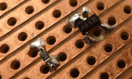

    Unfortunately there are not many TO-92 sized MOSFETS (either N-ch or P-ch), so that also makes them rare too, to compound the issue.
    I just tend to use SOT-23 sized SMD devices, because it is still possible to solder them to the stripboard side, if you cut a track and then
    mount the device so that it straddles a couple of rows.
    However, according to the schematic snippet, it looks like it is an MCLR pin of a microcontroller, so maybe this is a microcontroller
    programmer circuit?
    If so, you could check the current requirement, and possibly replace the P-ch with just a TO-92 sized PNP BJT (e.g. BC557). You should
    stick a small resistor (maybe 10k) in series with the base lead of the BJT. The rest of the circuit would then remain the same as
    the indicated image. This is all assuming that not much current (a few tens of mA) is needed to program this microcontroller.

    After studying and researching with Google for a couple of hours, I have hedged my bet that JohnB is correct and purchased 50 of these SUPERTEX TP0606N3 P-Channel DMOS FET on ebay.  They appear to have the "Right Stuff" for $0.26 each and free shipping.  Besides, I had $9.26 in eBay cash to spend on something and these will, I think, fill my current and future needs for P-Channel DMOS FETs.
    MichaelC:  I uncovered the following web page that shines a light on the theory you and I have forgotten in the mists of time.  http://www.electronics-tutorials.ws/transistor/tran_8.html
      Seems that JohnB is one crack EE.  Slamming the gate shut on a P-Channel FET is trivial by pulling it to ground, just as the original circuit shows, because VG << Vs.  I will not claim to understand it deeply until I get my hands dirty with them.  image

    I don't have a youtube video, but here is a pic of a SOT-23-sized device, and an 0603 resistor on stripboard.

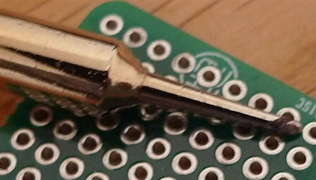

    Regarding the technique, I think everyone has their own personal favorites. I have a cheap iron, but it is fairly mid-high power (50W) temperature controlled, and the bit is 1mm. I'd like to try a more advanced iron, but never got round to it.
    This is the size of it in relation to proto board holes:
    The particular iron I have uses this tip.

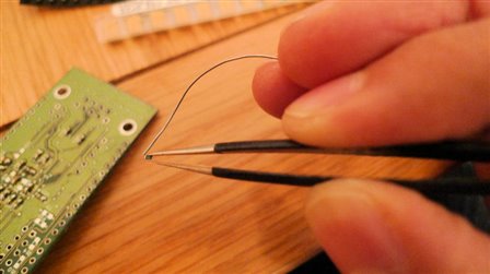

    Once the SMD part is being held in the correct place (with tweezers), just touching the iron tip will deposit a small bit of solder to hold one end in place, then you can remove the tweezers, solder the remaining pins as normal, and then rework the first pin. Another method is to hold the SMD part and the solder simultaneously in one hand, if you can manage it. This is the grip I use:
    It allows you to adjust the solder wire by a millimeter or two as you solder by just compressing some fingers, without losing the pressure on the tweezers.

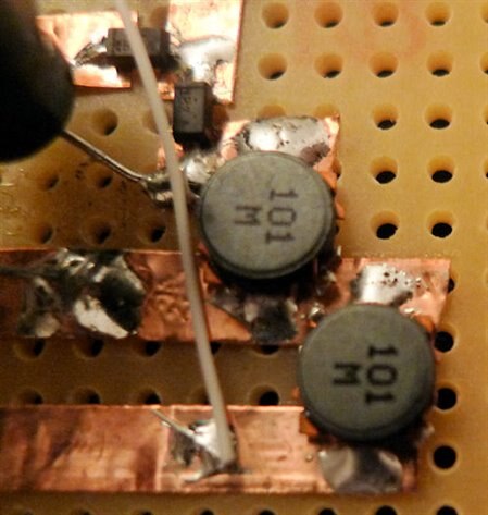

    Here is a pic of the tape method. It's not pretty (I was in a hurry). You can see two SMD inductors, and a couple of SMD diodes near the top. This was done on the plain side of normal stripboard, so it can be combined with normal wired components. The white wire is the tefzel/kynar wire mentioned earlier. If you want to use surface-mount ICs, you could glue an SMD adapter board on the plain side of stripboard too. And run the copper tape power planes three-dimensionally, from the surface of the stripboard and on to the
    adapter board. SMD IC adapter boards are depressingly expensive, since you need a variety at hand. I get mine from ebay, but even those are not ideal.
