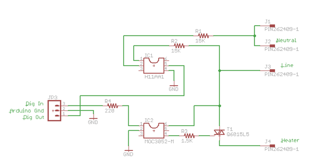

I am making an arduino controlled fan speed controller that would digitally control the speed of my ceiling fan working on 230 VAC and 50 Hz. I am using the following circuit which is designed for 110VAC and 60Hz. I took this circuit from this website:- http://playground.arduino.cc/Main/ACPhaseControl
Working:-
When the AC voltage goes from zero to peak, the optocoupler is active and activates the output side. The arduino pin connected to the output of the optocoupler senses a HIGH voltage. When the pin reads a low it means we are approaching at a zero crossing of the AC mains voltage and depending upon the timing, the arduino will activate the TRIAC driver that is optocoupler MOC3052 that will further activate the TRIAC providing the power to the ceiling fan.
My doubt is that in the datasheet of  H11AA1H11AA1 optocoupler ic the absolute max forward voltage of the optocoupler is not mentioned How is this ic working directly with AC I understand that the current is low since there are two 15k Ohms resistors but the voltage is still around 55VAC at the pins 1 and 2 of  H11AA1H11AA1 How is this IC not destroyed?? Also will the circuit work for 230VAC 50Hz??

    That data sheet specifically mentions AC line monitoring so it is clearly designed for it. It will probably work for 230 VAC also but R1 and R2 should probably be increased to 30K and the power rating…

    The input is two LEDs back to back. The potential difference between the two pins is never more than the forward voltage of whichever diode is conducting (as long as you have the resistors to limit the…

    Also, the edge rate of the output is going to be quite slow, so you may want to smarten it up before giving it to the Arduino [Schmitt-trigger gate or a comparator with some hysteresis]. It doesn't give…
    be increased to 30K and the power rating of the resistors increased also.

    The input is two LEDs back to back. The potential difference between the two pins is never more than the forward voltage of whichever diode is conducting (as long as you have the resistors to limit the current), so effectively they protect each other.
    The output of the optocoupler is the collector of a transistor, so you'll need to add your own pull-up resistor there (to the Arduino +5V) in order to see a signal - the datasheet has information on how to select the value.

    Also, the edge rate of the output is going to be quite slow, so you may want to smarten it up before giving it to the Arduino [Schmitt-trigger gate or a comparator with some hysteresis]. It doesn't give you a very good zero crossing point, either - the zero crossing is midway between the rise and fall edges.
