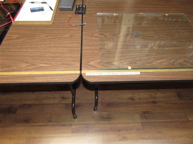

    Hi Dale, I have a copper strip that runs the front edge of all my work tables. The strip is tied to Earth ground through a 10K resistor. As I sit at the bench and work my forearms are frequently in touch…

    I have a copper strip that runs the front edge of all my work tables. The strip is tied to Earth ground through a 10K resistor. As I sit at the bench and work my forearms are frequently in touch with the strip. I try to be extra conscious when I am dealing with potentially sensitive parts and boards. The fact is that you only need to be careful with the semiconductor components that you want to work properly. For me this is all of them. You will never regret being too careful.
