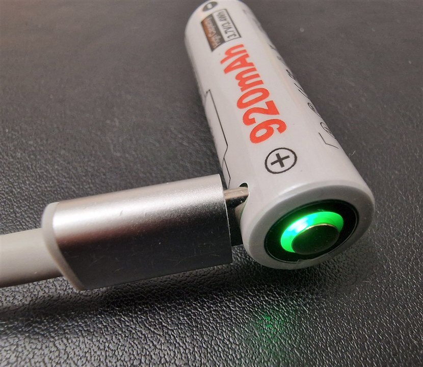

    0 shabaz over 2 years ago in reply to shabaz
    Took a photo since I was charging my flashlight battery..
    This 14500 battery has less than a quarter of the energy that the one you're using advertises. And it costs more than 6 times as much and has various built-in protection features. And built-in charger, with status indication LED.
