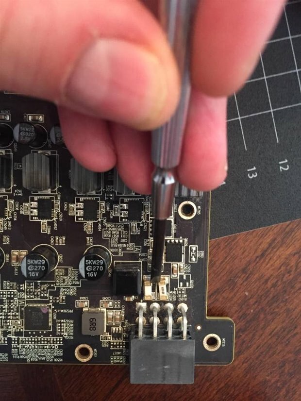

Are the components I’m pointing at with the screwdriver fuses?
This is a video card that suddenly stopped working.
There are no signs of a component that overheated.
This is right at the power connector. When I tested with an ohmmeter it shows that both of them are open.
Thanks,
Sean

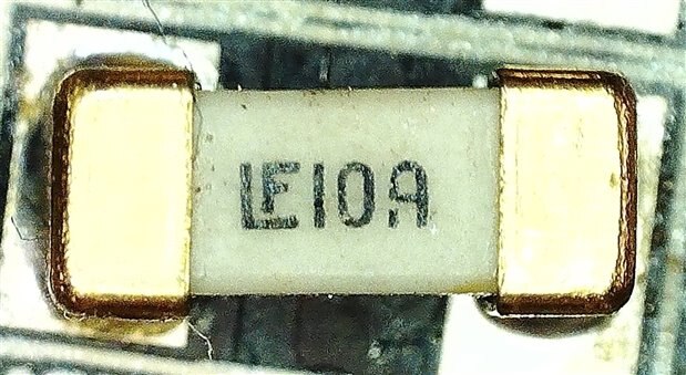

    Yes they are in fact fuses.you might google "fuse xxx (the number on the fuses) to get info. Looks as if they are 10Amp. Vse the voltage that the circuit supply for an idea of the voltage rating.

    It does look like Litltefuse. Could be this: https://m.littelfuse.com/~/media/electronics/datasheets/fuses/littelfuse_fuse_451_453_datasheet.pdf.pdf What kind of video card is it?

    I would believe that they are. The marking is LittelFuse, but I could not find any lookup or matching part number. Good luck! Gene

    f type fuse https://www.newark.com/schurter/3405-0176-24/fuse-f-type-smd-10a/dp/65T6380   would be a replacement.

    Thanks for the leads.  It failed abruptly and with these fuse showing open, it's at least worth a try to replace them versus just strip the card for parts.

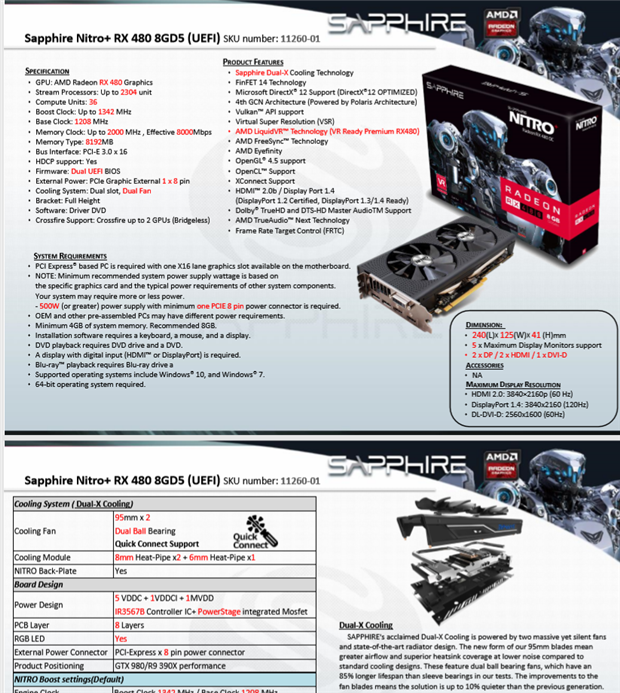

    Card:  SAPPHIRE NITRO+ Radeon RX 480 100406NT+8GOCL 8GB 256-Bit GDDR5 PCI Express 3.0 x16 HDCP Ready Video Card
    -Sean

    Sean_Miller over 7 years ago in reply to billpenner
    Great eye!  Here is a picture from my electronic microscope:
